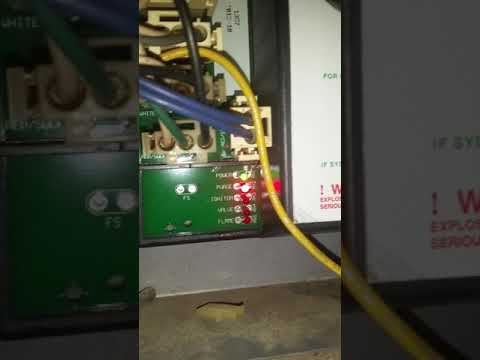

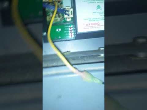

Heatmaker / teledyne / laars has a pretty good and knowledgable contractor support line but they did not seem to recognize the symptoms i was reporting. i filmed the ignition sequence on a working 9600 and on the malfunctioning one i'm servicing. the norm is it runs "purge" for about 15 seconds and proves airflow with a little bladder switch, then it proceeds to "ignition" which sends 120 to the hot surface ignitor for another 15 seconds. i'm not sure if the circuit tests for amperage going to the ignitor as a way of proving the ignitor is working or relies solely on flame sensor following ignition but this unit has a new ignitor with about 55 ohm resistance that is well within the 50 to 80 spec for operation and draws about 4 amps during the ignition phase. then, very briefly both the ignition and gas valve are engaged as indicated by the "valve" light on the control sequence indicator. then not even a second after the hand-off to the gas "valve" the control discontinues 120 to the ignitor (which is already hot) and places it in the flame sensor circuit to confirm flame.
in this video of the working unit:
https://www.youtube.com/watch?v=DwsAzcE3ERs
the "ignition" light goes out as the 120 goes off (although the indicator i think is in the 24V control circuit) and the "valve" light goes indicating 24V to the gas valve - briefly crossing over with both lights on as indicated. you can hear the ignition take place. the "flame" light gets a low glow and then a bright glow as the sensor/ignitor confirms flame. the valve/flame confirmation takes maybe 2 or 3 seconds. the "flame light is clearly lit through that confirmation cycle.
then, in this video of my failing unit:
https://www.youtube.com/watch?v=LRTBPFdChUo
it runs the same through the "ignition" part of the sequence and then very briefly, i.e., milliseconds, flashs to the "valve" portion of the sequence while the ignition indicator is still lit -- so quickly that i never catch voltage at the valve with my tester -- and then it drops out to a fail/retry.
I replaced the control board and got identical symptoms. from the terminals on the control board plug to the valve one wire goes straight and the other goes through a temperature sensor i think on the tube from the blower to the combustion chamber that is maybe supposed to sense back pressure if the combustion chamber is clogged. that sensor is showing open the whole way.

ironman - didn't realize we shared initials. which "pressure switch" are we talking about. do you mean the gas valve or . . . and no flame rod, these heatmakers before the endurance used the hot surface ignition as the flame sensor. the contacts are switched in the black box following the heating to ignition temp.
brian (bishop)
PS - tech at laars this morning suggested maybe something else in the 24V control circuit not in the digital portion that is only making marginal contact is dropping out at the instant that the load for the gas valve is instituted. he suggested the flow switch as one possible culprit. i'll be there in a half hour to check this . if you can tell me which sensor or component you mean by the "pressure switch" i've got manometer over there although i don't think this is making it to even opening the gas valve.0 -

FWIW2 -
jughne, very close on that, disconnecting the gas valve was the right idea to watch it run without any load on the 24V circuit. i had ruled out the problem being the various operating and safety limits in series in the the 24V circuit because if any of those are open the boiler won't even try to start. Although I don't think of the gas valve as a lot of load, it is 'the load' for that circuit and as soon as it would get called, the 24V safety circuit was going down. i jumped out the various safeties until i found the offending sensor.

turns out it was the hydronic operating limit which is in series with a number of safeties in the 24V control circuit. the problem in diagnosing is that normally, if anything in the chain is open, the boiler won't even try to start, so my logic ruled those out. however it must have had marginal contact for the circuit in the sensor so it would signal the control to start, but as soon as the control tried to hit the gas valve, amps on that24V circuit would rise significantly (on a relative basis, not that the gas valve is that much of a draw) and the circuit through the safeties would collapse, it would cut out to retry but it never got so bad that there wasn't a sensor connection without hte gas valve load so when i was testing i was showing the safety circuit as closed.
