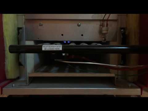

Hello everyone! Please check out the video I attached with this post. I noticed tonight that my boiler keeps cycling the gas burner over and over within minutes. What would be causing this? If you need any more details, please just ask. Thank you again!

    First thing I would do is clean flame sensor and check wiring connections from the module to burner.

    take the front panel off so we can see the flame, could be roll out switch, could be gas valve, could be the ignition module, how old is the unit? the grey ignition module is ole they havnt been grey for a long time, flame sense could be dirty or weak

    Update! The boiler started cycling the gas burner again today when I got home so I was able to make a video with the flame. Check it out:

    By way of how quickly it's cycling, I'd check tstat wiring, tstat itself may also be bad. I had this same thing on the hot air furnace, changed tstat, problem solved.
    Then, check other wiring: ptrol, flame sensor, etc. If it isn't tstat, you have a loose wire somewhere, or a dirty/faulty flame sensor.
  • JUGHNE
    JUGHNE Member Posts: 11,357
    I wonder if your main burner isn't knocking the pilot flame out or away from the flame sensor. The pilot almost looks to go out and then relight.
    I would clean pilot, spark, flame sensor and make sure ground from burner to module is good.
    Steamhead Member Posts: 17,636
    What @JUGHNE said.. It's not the thermostat since the spark comes on when the flame goes out, indicating the thermostat is still calling for heat.

    I jumped out these 2 sensors one at a time and the problem still exists.

    If either of those sensors opened the spark would not continue to buzz. It is fairly clear that the flame sensor at the pilot is not transmitting presence of flame back to the ignition module.
    It needs to be clean and there needs to be a good ground connection back to the module.
    What is that dripping tar look substance above the burners?

    @ Jughne, that tar like substance has been there since it was installed, it is like a sealant of some sort.

    Hi Brian I've had this issue before and I cleaned the Flame sensor with nail polish remover (because of the acetone) and that works great. However if the issue returns then you have to replace the flame sensor.

    Clean first and retry......if for some reason the flame sensor is not in the fire, as mentioned pilot too small when main comes on perhaps.
    It must have the flame of actual fire to conduct the electric signal back to the safety/ignition module to keep the gas on.

    Hey everyone! Well tonight I cleaned the flame sensor with nail polish remover per @Dave0176 suggestion, and also found some junk on top of the burners, see pics below. So I took them out, cleaned and shop vacuumed them, then I also vacuumed out the combustion chamber. Note on the 1 burner there was a mound of junk fairly close to the flame sensor. Outside temps are warmer now, but I did crank up the t-stat for a bit and test ran everything, so far so good. We will see, I will keep you posted if anything happens with what little left heating season we have. Thanks for the advice so far everyone!
