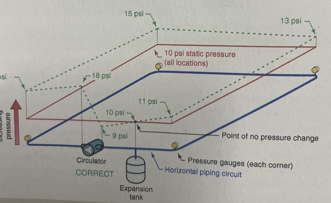

  • question then. Would it make any difference if we put the expansion tank on the supplu side ( outlet) of the boiler or the return side ( inlet to boiler circulator) as shown in drawing? Would one design be better then the other? Thanks
    hot_rod Posts: 28,699
    You want the circulator to be pumping away from the expansion tank connection.
    These two drawings show how the circulator adds its ∆P, pressure differential, to the system when pumping away from the tank connection, the PONPC point of no pressure change
    The red loop shows the static fill pressure of 10psi. The blue loop is the dynamic pressure conditrion, the circulator running.

  • Awesome! This raises one very important question for me... just one! In pumping away from the expansion tank and it creating the point of no pressure change... is there a specific distance, or rough distance, that the expansion tank has to be ahead of the circulator(s)? Or could it be 15", 5', or 10'... due to the fact that that the expansion tank always has system pressure on it (providing the bladder pressure equals system pressure - below 70/80 psig), thereby creating that equilibrium with minimal water movement?
    Correct, the tank connection establishes the PONPC. So any distance between that point and the circ inlet has a small amount of pressure drop. How much? It depends on pipe size, flow rates, type of fluid.
    I suppose you could put some numbers to that small pressure drop, if you had all the data. I would suggest as close as possible. A few to 5' would not be a deal breaker.
    One goal is to have all the circ ∆P pressure differential added to the circuit.

    What you want to avoid is pulling a sub-atmospheric condition, negative pressure in the circuit. Under that condition, air could be pulled into an auto air vent, for example.
    l
    The circulator pumps want some positive pressure at the inlet. Grundfos shows anywhere from 1.3- 4 psi at 140- 190° water temperature. The hotter the water the more prone to cavitation without adequate NPSHr net positive suction head required
