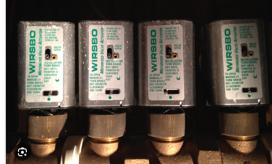

I got two bathrooms with radiant heat supplied by a 10-year old Wisbro manifold. One bath is getting some heat, the other is getting none. Since there's hot water to the manifold, my best guess is that the actuators are the problem.
I've gotten the uponor A3023522 thermal actuator, which seems to be the successor model to the existing actuators. I've also gotten a VA33 to connect to the brass manifold.
How do I actually replace the actuators ? Do I need to drain the loop ? Also, the actuators are on the bottom of the manifold, the return lines on the top. All the literature I've seen has the actuator on the top. Does this matter ?

    The valves should just unscrew from the base. No water to worry about.
    The wiring should be the same as the old one.
    Upside down should not effect operation.

  • Yes, I do need to place the manifold valves themselves. In the image the valve on the left was never used. The other two had actuators attached. Those two have stems that haven't seized, but are more difficult to move.
    I'm thinking of using this valve:
    http://www.supplyhouse.com/Wirsbo-Uponor-A2620017-TruFLOW-Replacement-Manifold-Valve
    I assume I unscrew the existing valve and replace it with the new one. The manifold has no close-off valves. I can close off the supply and the return to the manifold at the boiler. Is that enough to avoid flooding?

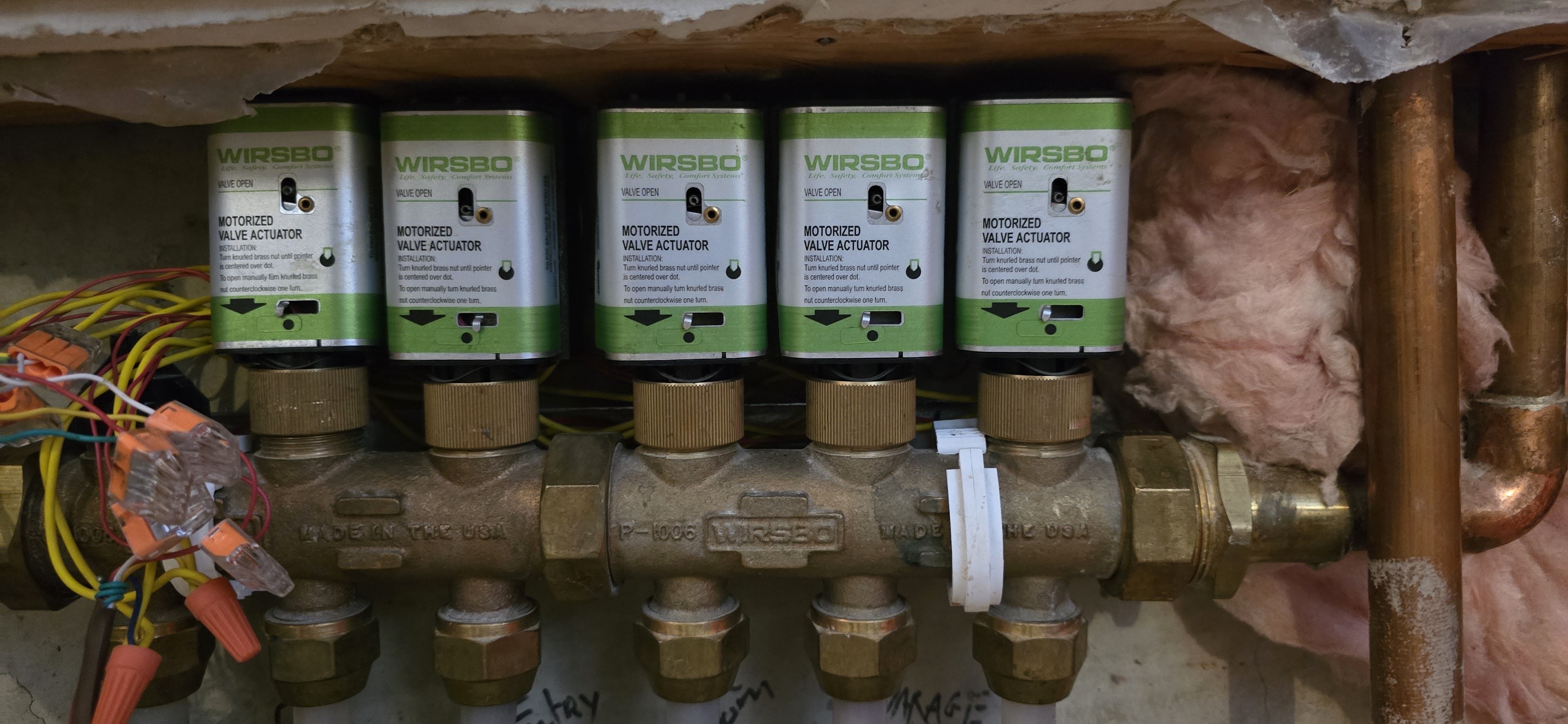

  • I have the old brass Wisbro 6 position manifold with 5 of the old Wisbro mechanical 4 wire actuators. I’m using a Taco 6 position Zone Valve Actuator Control board to drive the actuators. The status indicators for open or closed indication barely move, (if at all). Only 2 of the 5 End Switches make contact to run the circulator. I want to replace all of the Wisbro actuators but I can’t find good part numbers. I understand that Uponor bought Wisbro and most of the old stuff was discontinued. It looks like now they only use thermal type actuators and require adapter rings to fit them on the old Wisbro manifold. I’ve seen discussions about actuator adapters not fitting or the manifold must be replace etc…. Replacing the manifold is a deal breaker for me at this time. Can anyone give me good part numbers for new actuators and adapters? Or a source to get the old Wisbro actuators?
    Thank You Very Much
    Bill
    hot_rod Posts: 28,704
    Do you have the older power track style, shown here? Those are hard to come by, occasionally you see them on E-bay.
    I believe there is a new thermo actuator that works. It may require and adapter? Uponor would know.

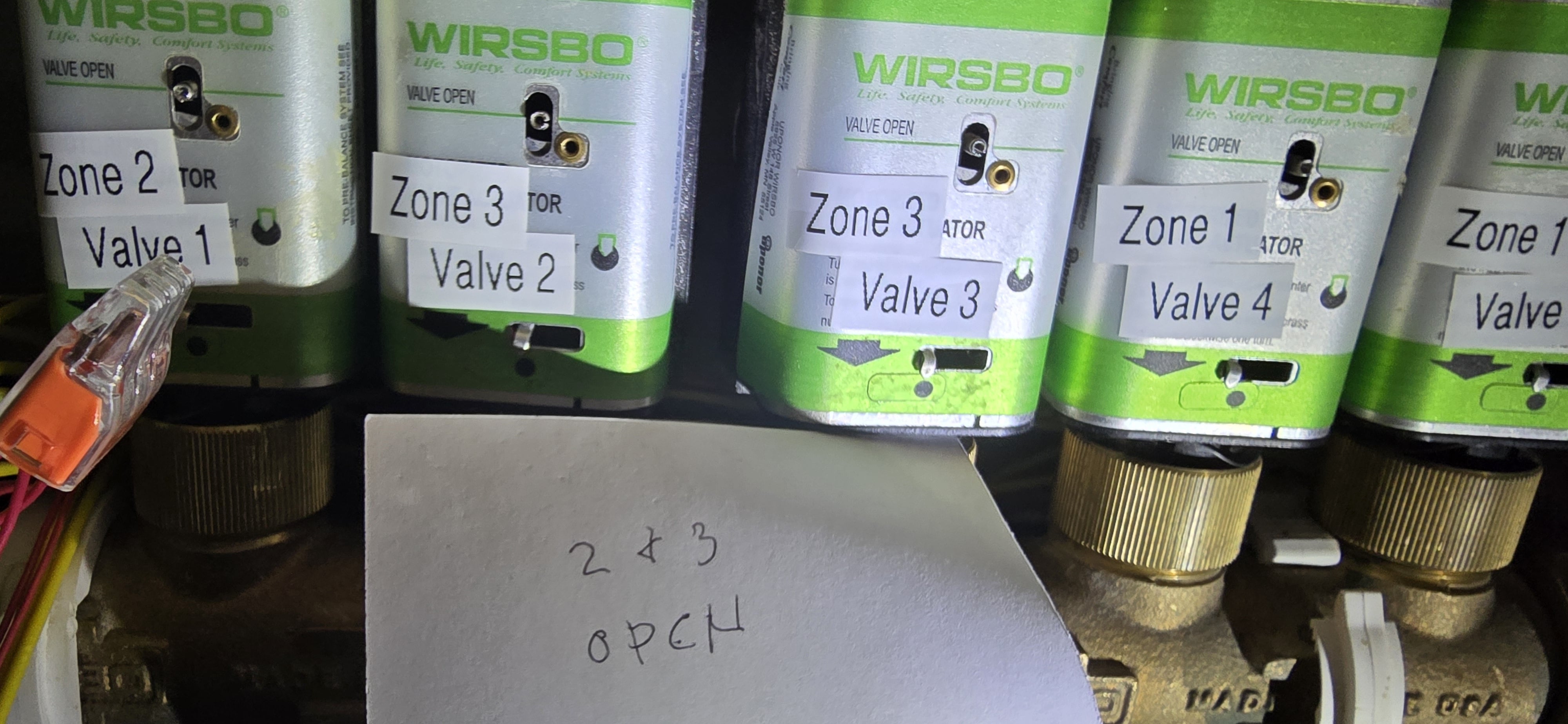

    The attached pictures show my Wisbro actuators and manifold (2 parts). The up/down indicators don’t move much to show open or closed. The only valves open are #2 and #3. All others are closed but you really can’t tell by these indicators. I believe that the valves are opening because I can hear flow going on and it heats up a little. I doubt that they are letting the Pin Valves open completely because the End Switches don’t close. I have a Taco 6 Zone (ZVC 406) to operate the actuators. I think that it can drive the mechanical or thermal type actuators. I would really appreciate some good part number(s) and sources to get replacement actuators (new or old) with workable adapters.
    Thanks Again
    Bill

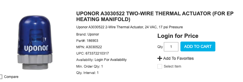

  • Dave H_2
    Dave H_2 Posts: 627
    Change out to the white thermal actuators, but you will need a spacer ring to thread on like this:
    And you should be able to connect this actuator to it but:
    This white one above appears to be updated with this blue one below:
    I haven't personally tried this combination but the ring above is the best start. Any other actuator should snap onto that ring onto the manifold

  • Those valves need to be adjusted when the power is off. Turn the adjusting ring until the arrow on the bottom is aligned with the black dot. That might help with your issues.
    Otherwise, change them out with the thermal actuators and adapters. Make sure you get the right adapters for that manifold, as the classic rough metal manifold you have uses different adapters than the other ones, and last I looked, were hard to get.
    Rick
  • Thanks for the info:
    So I think I'm hearing that I want the Blue Actuators (latest version?) and VA33 adapters right? Is Uponor the best (cheapest) place to get these?
    FROM ABOVE: My adapters from thermal actuators (4-wire A3023522) to a 5-zone/port Uponor manifold are VA31H adapters.
    Unfortunately the SKU: A2620017 you selected does not work for the older brass Wirsbo manifold. The is for the newer Uponor tru-flow manifolds. All parts for the older Wirsbo manifold are obsolete. If you wish to replace the valves you will need to replace the entire manifold at this time.
    ??? What To Do ???
