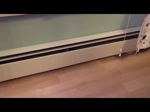

Do your baseboard heaters look like the one in this video?insurewithgreg said:Im not sure...just sounds like there isn't any water getting to them
https://www.youtube.com/watch?v=N4K9hi7vLnU 0 -
If the element is turned sideways the air will not flow through it and the element will not give up its heat to the room.
