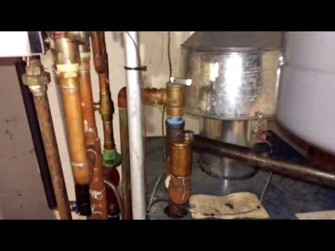

Hopefully someone can help:
My 2 floor plus basement summer house, basement boiler (baseboard hot water system), where the pressure relief valve is on the boiler, has what looks like a "T" fitting at the top of the pipe coming up from the boiler, , 1 part of "T" going to the relief valve, the other end of the "T" going directly to what looks like a steam release valve, which has a small thumbscrew on it.
The pressure release valve has been changed , however it occasionally "goes off", daily, & I notice water on the basement floor under the relief valve pipe. I have been in the basement once where I "caught" the pressure gauge momentarily go way up, & the release valve briefly let out a bit of water onto the floor, & the system pressure quickly go back to normal.
The problem is 90% of the time it is running normally, it is hard to catch it "in the act", & a repair person was not able to duplicate the situation while he was there, he did all the regulr bleeding of system, ect ....
Could it be that "T" at the top of the boiler has a bad steam valve (if that is what that is), would that stop the occasional momentary pressure spikes... ??

    I think the valve with the screw is your water feeder.
    What kind of system do you have? I assume it's a water boiler, but do you have an internal coil or indirect for domestic hot water?
    What type of expansion tank do you have?
    If the pressure keeps rising it's either:
    1. Water feeder not closing tightly, adding water to system and eventually blowing out relief valve.
    2. Steel expansion tank water logged, or bladder type expansion tank failed/lost its charge or is undersized.
    3. System not properly bled.
    Or a combination of the three (or all three)
    Can you post some pictures?

    I think the 'steam vent' OP is talking about is an air vent. I have seen some older boilers that had an air vent on a tee with the relief valve coming out the side of the tee, some CI boilers have baffles built into the boiler kind of like an air scoop. Tapping on top was for the tee with relief valve and air vent.
    Weil Mclain boiler i'm betting.
    Agree with all the above, pictures will help us verify some of this.

    * It has a bladder type expansion tank, ( recently replaced), connected up near the ( gas fired) boiler to a pipe, that seems to be in line with just One of the two Zones. I had asked the service person about that, & he said it didn't matter where it was located, as long as it is "somewhere" in the system ... ( if that zone is not running, only the other zone, then how does the expansion tank "work"?)
    * The "bell" looking water feeder ( also fairly recently replaced), enters from a cold water main at a lower point of the boiler.
    * The "Steam valve" on the "T", I'm pretty sure is an air vent, ( as @delta T mentioned above), & that vent has not been replaced recently. ( It reminds me somewhat of the end vents we had on steam radiators in my home as a kid ..).
    * Hot water comes from a separate gas hot water heater, not this boiler.
    * The boiler ( not the pipes/rest of system), was replaced in 2012 before I owned home.. I believe the pipe with the "T" coming off the top with relief and air vent was probably from the old boiler & connected to new, but not sure.
    -- Trying to get to the bottom of why the very occasional bursts of high pressure/ relief valve water release

    " I had asked the service person about that, & he said it didn't matter where it was located, as long as it is "somewhere" in the system ... ( if that zone is not running, only the other zone, then how does the expansion tank "work"?)"
    This is not true. The placement of the expansion tank relative to pumps has an effect on system pressure when the pump is running. If you want a detailed explanation, someone may jump in, I have to run now. If you are really interested the book 'pumping away' available on this site will explain exactly what the pump/expansion tank relationship is.

    As suggested for pictures, ( again thanks @delta T and @STEVEusaPA ),
    Here below, is a 2 min video, showing the boiler brand, pump, the mentioned "T" with release valve/airvent, expansion tank , water input, pressure gauge, water on basement floor etc ...
    - Any insights as to why the occasional pressure build/releases would be greatly appreciated.
    Secondary questions are:
    - Do you think the expansion tank is OK where it is?
    - Should I replace the air vent?
    Thaks in advance..

    The expansion tank is absolutely in the wrong place. I don't think that it is completely isolated at any time unless you have check valves on the return that are not visible in the video.
    What I think is going on is that the location of the expansion tank is causing the pressure to fluctuate as the zones open at the point that pressure reducing fill valve is located.This could be tricking the valve to add water when it is not needed.
    Try turning off the water supply to the system and see if the problem goes away.
    As rule, anyone calling themselves boiler technician that thinks that is a good place for the tank should be shown the door.

    The correct location for the expansion tank and fill would be directly upstream (above) the circulator given your present layout.
    I think a better fix would be to move the circulator to the supply side then move the expansion tank to the location of your existing fill valve.
    I would not isolate the boiler and leave it unattended, Particularly since your system is having some issues and does not have a low water cut off.

    It seems to me from the video, that the expansion tank is being isolated from the system when the right hand zone valve closes. In other words, when that zone temperature satisfies the thermostat, access to that expansion tank can only happen through the return line. More than likely it pops the relief valve when , the left zone valve opens on a call for heat but not the right. the rapidly heated water from the boiler just doesn't have time to access the expansion tank from the return before the relief valves reaches it's limit. In short, the expansion tank needs to be on the boiler side of those zone valves. (Just to add, when the either zone valve opens, the circulator calls on, so when the right zone valve is off, the rising pressure caused by the heating water needs to fight against the added circulator pressure and the resistance of the total length of return piping all the way to the expansion tank. The expansion tank should be before the zone valves, and it would be wise to have the feed water connected there as well.)
  • Grallert
    Grallert Member Posts: 1,148
    To add something. I would bet that circulator still has it's internal flow check. So when the right hand zone closes, and it closes quickly the the other zone is isolated from any expansion room.

    Blast, I had a few minutes to read your questions and I think it would be helpful to review some important points.
    . The circulator "circulates" the water around the system by causing a certain difference in pressure. It will either increase the discharge pressure or decrease the input pressure or both. what it does is directely related to where it is in reference to the expansion tank. No matter where it is in the loop, it's going to move the same amount of water and at the same speed. but it can neither add nor take away water from the expansion tank. The only things that will add water to the expansion tank is the fill valve or the heating(expanding) of the water.
    .The point where the tank is connected to the system is called the point of no pressure change. So if the circulator is located near to where the expansion tank is connected to the piping and pumping away from that point, the intake side of the circulator can't drop and it circulates the water by increasing the discharge pressure. In a nut shell, this is a better way of keeping your system free from air and the associated problems that air causes(air is introduced into the system every time the feed valve adds water). (all this is in Dan's book)
    Soooo, in an ideal world, we would have your expansion tank connected to the supply pipe where it leaves the boiler, then we would have your circulator pumping away from the "point of no pressure change" towards the system, your fill valve would be connected right between the supply and the expansion tank(again at the point of no pressure change). and your system would live happily ever after!
    But that's a lot of re-piping! Maybe your up for it and maybe your not. I'm not sure that I would be. Many boilers are still piped the way yours is with the circulator on the return, pumping towards the expansion tank, and they work. You just have to make sure that the expanding water has access to that tank!!

    hot_rod Member Posts: 27,856
    Assuming the pump arrow is facing into the boiler and the zone valves are flowing out. I think the simple fix is to move the expansion tank to just upstream of the pump. You have an isolation valve there and plenty of room to add a tee between the valve and pump. The zone valves will isolate the other side of the boiler and you should not need to drain down or lose much water to correct this.
    Both the expansion tank and fill valve connect there.
    Air purger always wants to be
    at the hottest going, you have that ok. Expansion tank does not need to be with the air purger, you will have that okay also.
    Pumping into the boiler is fine as long as the expansion tank in in that location also.
    I'd be inclined to install a new relief valve if it had been going off a lot, cheap and easy while the system is down.

    Ok, I finally had the work completed from the above video problem, and I have posted an updated video to show the completed work below.
    The heating guys really did not want to cut/redo all the work to put the expansion tank as in the diagram above, & it was less expensive and easier to simply " T " it off the PR valve with fittings,, where they claim they install them regularly and it should be fine, & no longer in just 1 of the feeder zones .. so I let them do that ,.
    It seemed to be OK yesterday, day of install, & the boiler was running at about 12 psi .. since I'm not there all the time, I will see within a week or 2 if the fix actually has worked ....:

    I guess it is better than having it on an isolated zone. You are still pumping directly into the expansion tank which is not ideal. You might want to stop inviting those guys over...

    It will work. Not Ideal, but much better than where it was.

    It has seemed to have worked .
