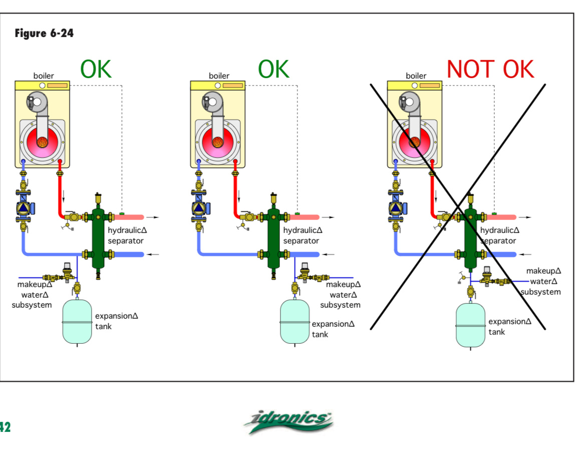

    hot_rod Member Posts: 28,079
    Really not much difference. Wherever you connect the entire sep becomes the PONPC.
    On the multi boiler system with the large floor mount tanks, the expansion is connected at the end of the large headers off the sep.
    Avoid putting the tank directly below the bottom port of a separator as dirt and crud may settle onto the diaphragm in the expansion tank and cause wear.
    Here are some examples from Idronics 15.

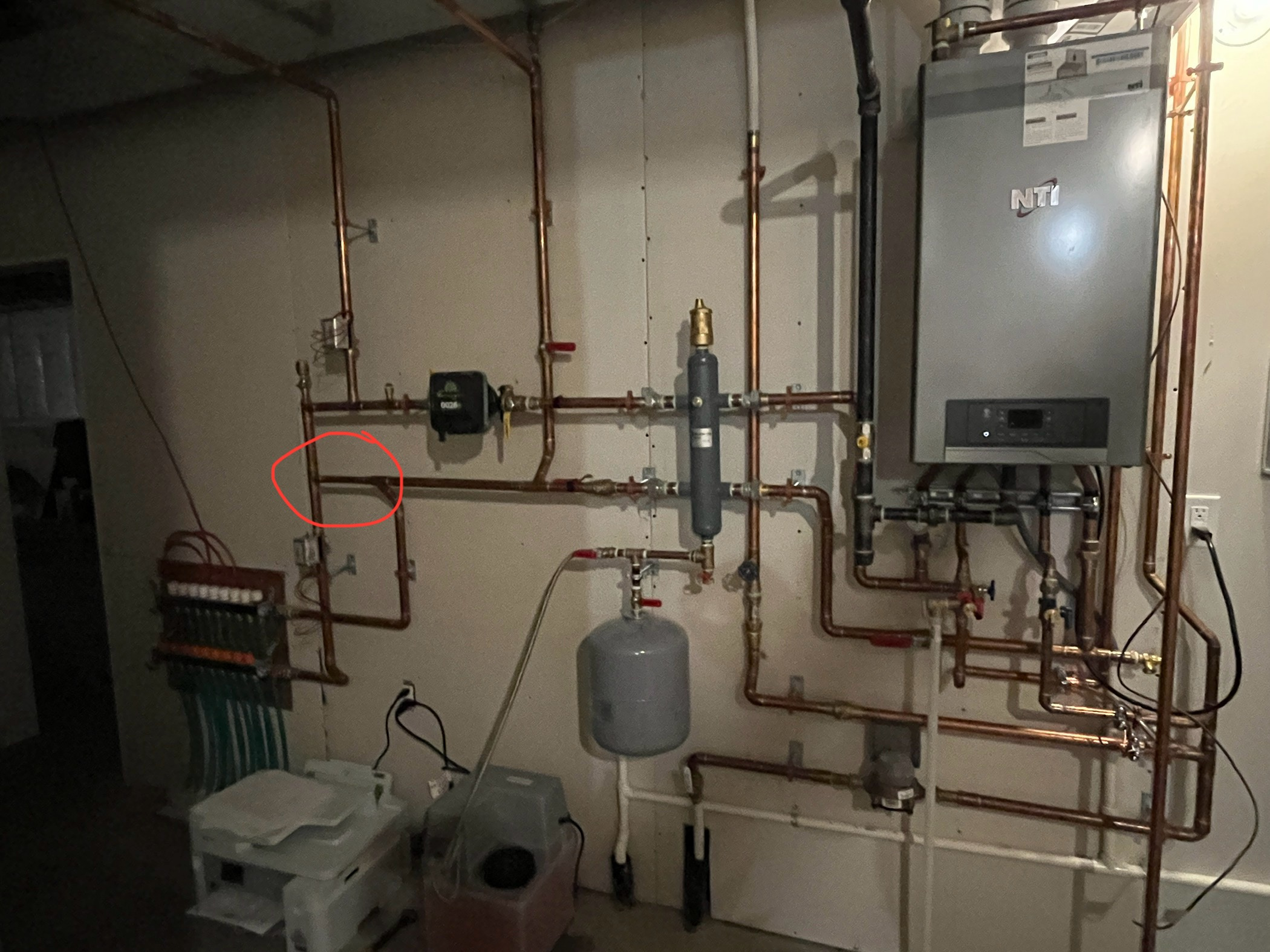

    hey guys,

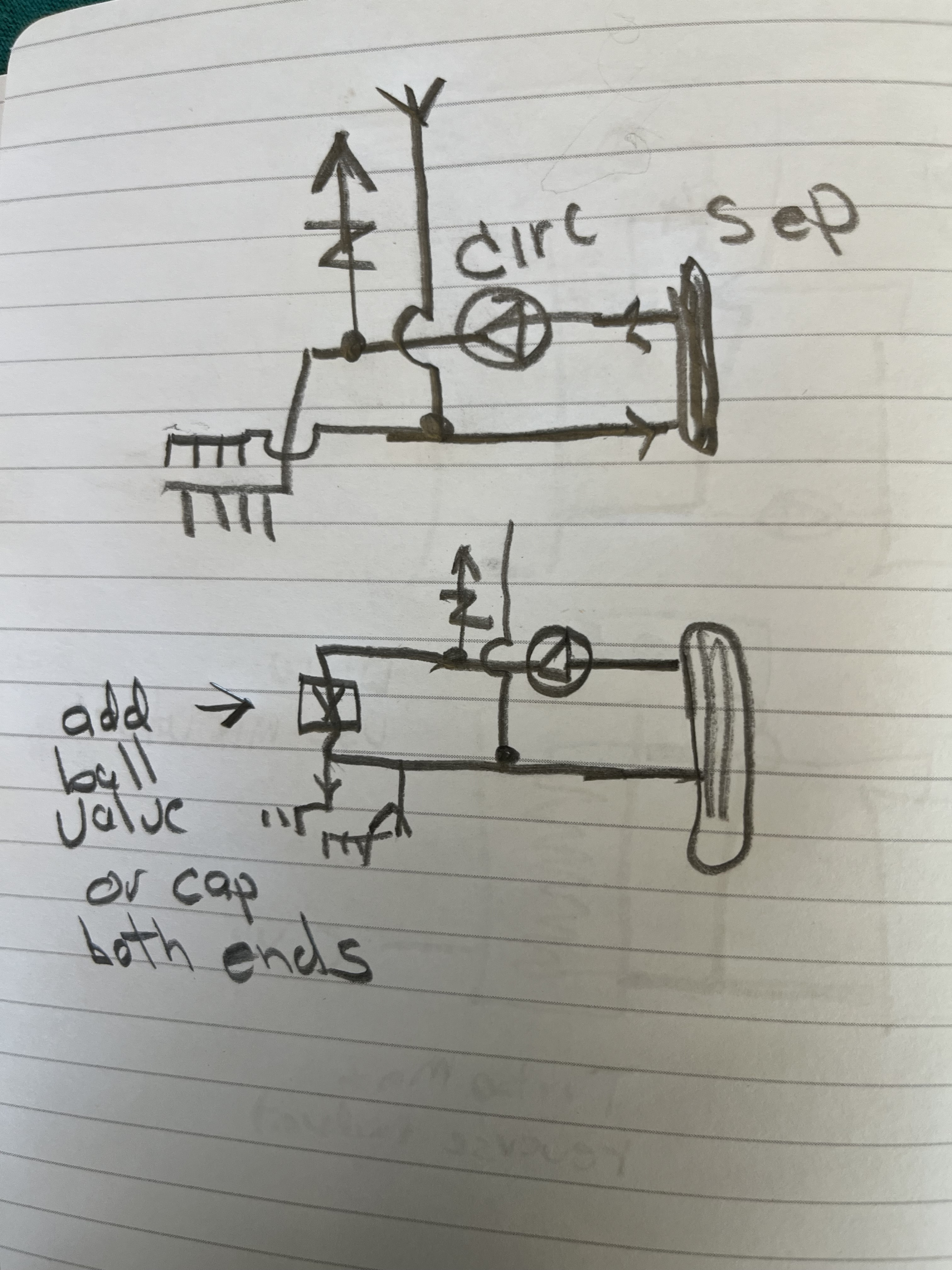

    Thanks for the diagrams! Was helpful to confirm my configuration. One question, I can’t understand why they’ve installed a pipe connecting the supply and return to the floor heating. Is this correct?
    I would say no if the circ is off when the zone valves are closed. If the circ runs all the time it should have a bypass valve installed in that pipe. Looks like they are using the small pipe for a pressure control.
    that is not correct
    The supply from and return to the sep should not connect
    Install a valve or cut and cap. Take the handle off the valve after you turn it off!

    Thanks gentlemen! How about the pressure tank connection into the hydraulic separator? In the Calefacto CB100 connection diagram, nowhere does it show connecting into the bottom like that. Is it connected wrong?
  • GGross
    GGross Member Posts: 2,035
    edited October 2025
    manufacturers of low loss headers will always tell you not to hook the tank there. The concern being that debris tends to settle in that spot and can settle in the tank and over time possibly disconnect the tank from the system, and can make flushing the debris out more difficult. In this case they did build a little dirt leg of sorts there, it's probably OK but I would prefer it on the return pipe (colder pipe) on the boiler side of the low loss header, not attached to the LLH directly. I will also add that there are many many installed like that in my area, it was really common and I was even taught to do it this way originally, a conversation with our local caleffi rep right around the time we picked up their LLH with magnetic dirt separation changed my mind. I even took the white out to my diagram and changed it right then! I've also seen them piped in sensor/gauge wells like what you have near the top of the LLH, that's a bit better than the bottom but that thread is usually not NPT, and why not just put a gauge there if taking the plug out?
    also im sure your pic is from service, but make sure that service valve to the exp tank is always open
    Farmer11

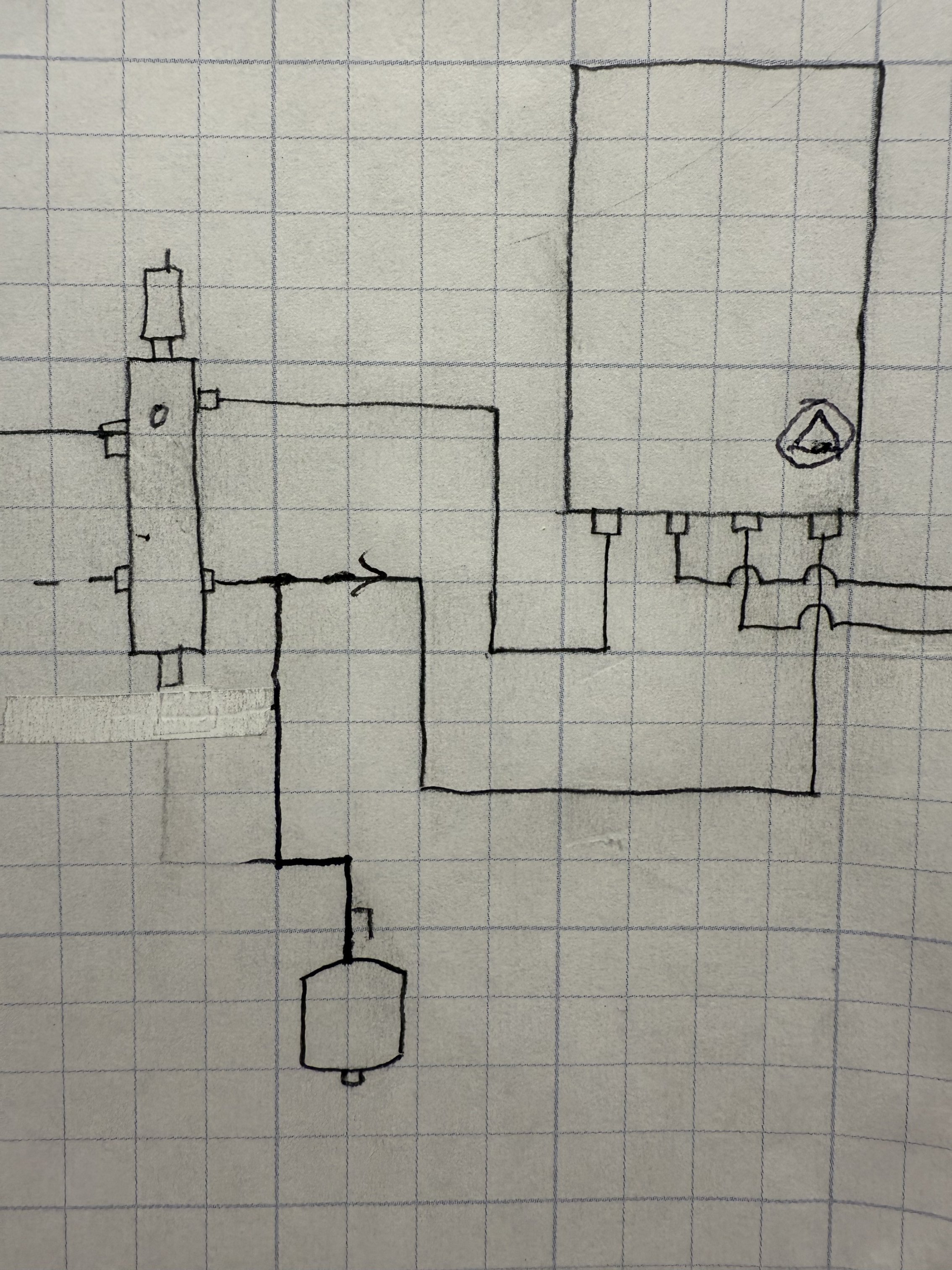

    here are some piping options for an expansion tank on a sep
    While yours is not pic perfect, they did offset with a tee, so it is not directly below.
    I suppose it depends on how much debris will filter out and fall down to that connection
