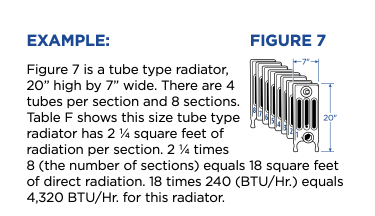

    I've using some old heating plans from 1930's for a renovation. All the radiators are labeled as the op posted.
    Would anyone be able to fill me in on the meaning of the numbers highlighted? "50-6T-32"H" thanks in advance.
  • bburd
    bburd Posts: 1,338
    50 might be a model number or refer to a schedule that shows the type of radiation. 6T would be six tube, perhaps a pipe coil or convector? 32"H would be the height.
    Bburd
    EdTheHeaterMan Posts: 12,948
    edited February 11
    WOW. how did you find this post from 2016?
    50 is probably the total number of sections
    6T might be a 6 tube radiator section
    32 H might be the hight off the floor of the cast iron section with legs
    That would put one section at about 3.7⎅ EDR.

    This illustration is from Weil McLain boiler sizing guide on page 10.
