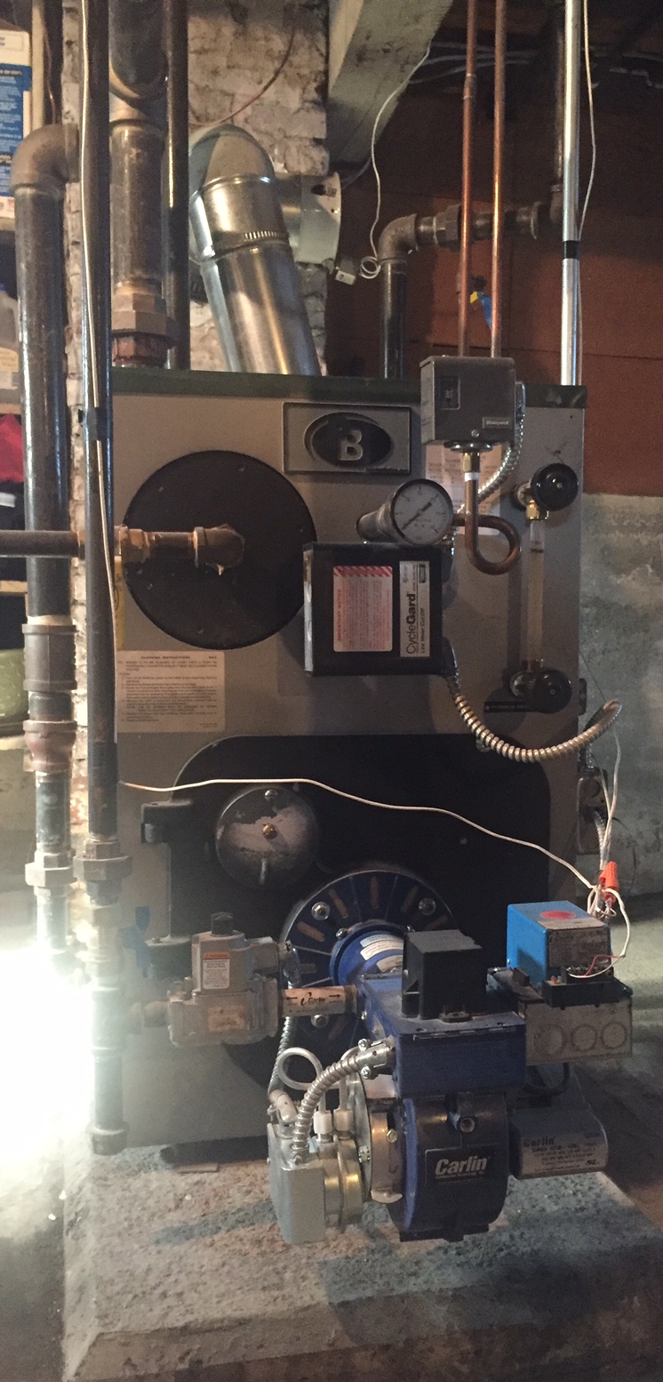

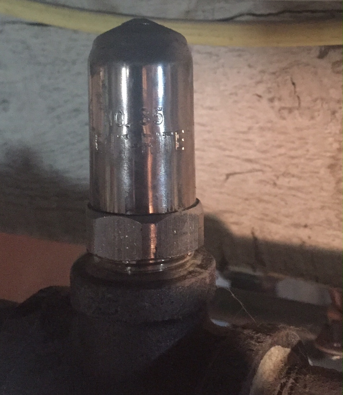

    Thank you for the vent recommendation above and for requesting more info. Here are some responses, based on the most recent questions.
    1. Photo of boiler:
    <img src="https://us.v-cdn.net/5021738/uploads/FileUpload/c5/832469f76c0580eb8206b457ec8c9d.jpg" />
    2. The radiator itself appears to be perfectly level. The pipe in the basement has a difference of about 5 inches from where it comes through the floor to where it goes back into the main line. In the one room with the majority of the length, it loses about 2.5 inches and on the other side (photos above), it loses another 2.5
    3. As far as the mains - there is one main pipe that Ts off above the boiler - those two pipes run around the outside walls of the house - the pipe decreases in size after the last radiator that it is feeding and goes back into the boiler. I hope this makes sense - I am not very familiar with these systems
    4. The vent on the main pipe is a Vent Rite 35 - pic attached in case there is more info to be gained from it
    <img src="https://us.v-cdn.net/5021738/uploads/FileUpload/26/5af233625c554c781421c7c0d27814.jpg" />

    A shot of the boiler from a little further back or a different angle, not so much the boiler, but the piping and how it comes off the boiler that matters. As far as venting you are way under vented on the mains. That isn't helping matters. You generally want to vent the mains fast and the radiators slower. From the settings you mention it sound like someone was trying to vent the rads very fast to try and make up for lack of main venting. To determine main venting needed you would need to measure the length of the main (from boiler to end hopefully where that vent is) and the size of the main pipes. We could recommend the amount of main venting that will work for you. I suspect once you get that it's possible that rad will heat without changing the vent. I will warn you once you get the mains corrected you will most likely have to readjust most of the rad vents in the house. You can't truly balance the rads for comfort until the mains are right, the lack of main venting will also slow the steam delivery down costing you in excess fuel usage.

  • ChrisJ
    ChrisJ Member Posts: 17,391
    That boiler piping....
    Almost, but not quite! :(

    Thanks. I am located in southern Maine. I do know that the home was converted to nat gas at the same time the boiler was replaced - that was in 2012 prior to me owning the home. It was oil before that, and that's about all the history I know. The techs that service the system are the same ones that installed it, so that may explain a few things. We have had a few other issues with this system as well so in addition to regular service visits, they have been out many times troubleshooting - not here to bad mouth by any means, but a good recommendation would certainly be welcome. Thanks.
  • BrianT1077
    BrianT1077 Member Posts: 108
    The boiler was installed in 2012? My question is why would the previous owner buy a new oil boiler and put a Carlin EZ-Gas conversion burner in it for a fresh install? Why not just make the new install a regular natural gas boiler? As for the radiator issue, I am sort of dealing with the same problem in my house. I have 2 radiators on the same copper line tied into my rear main. The one in the kitchen on the first floor heats last and the one in the second floor bathroom never heats. But recently I just made all my radiators vents Vent-Rite #1's (Had some Vent-Rite #1's, some Gorton's and a Maid O Mist) and did find out that the ones I already had the Vent-Rite's on were venting too fast and some radiators were stealing the steam. So with advice of another user on here, I started them all at position # 2, and guess what, the kitchen and 2nd floor bathroom are starting to heat. The kitchen heats normally with the other radiators, the 2nd floor bathroom when it finally heats (vented at a higher #), heats right across within seconds and gets hot. Before it does I do get the gurgling sound in the wall. The balancing still is not perfect and I am still working on this radiator issue.
    Crown Boiler Bermuda Series model: BSI103, BTU output: 85,000, single pipe steam system

  • Charlie from wmass
    Charlie from wmass Member Posts: 4,425
    edited January 2016
    A wet base boiler is more efficient if properly tuned than a dry base gas boiler. That is why. I am currently working on installing a new SGO with a Carlin gas burner for a client.

  • KC_Jones
    KC_Jones Member Posts: 5,934
    There are several pros on here that will tell you that type of boiler with gas is more efficient than a standard atmospheric boiler on gas. @Steamhead does it like that almost exclusively on his installs. I haven't heard of any contractors in Maine that are good with steam so perhaps someone else has an idea. If not we can certainly walk you through some basics if you feel comfortable doing some of your own work.

    A Gorton #6 vent took care of the immediate problem and the radiator is now getting heat. I plan to have the whole system looked at in the future as this thread brought to light many other issues beyond the radiator that wasn't getting heat!
