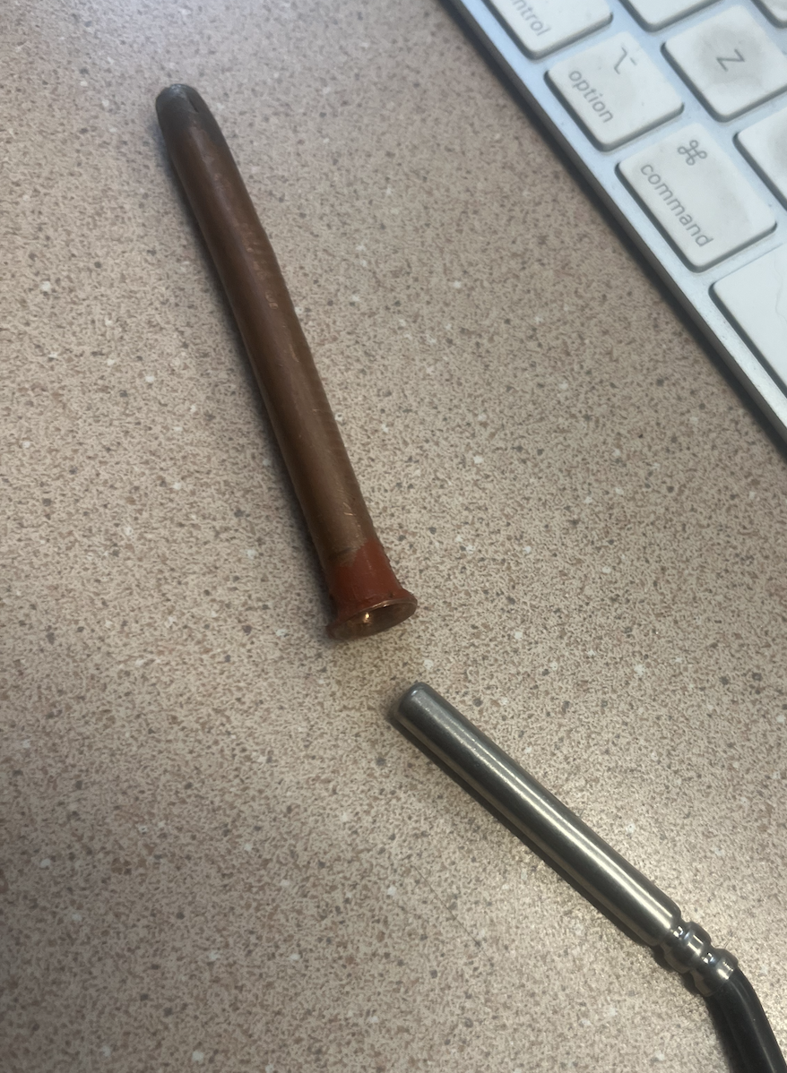

  • Use the Lochinvar sensor and shim it to fill the well. Buderus sensors have been like that for years.
    techforlife
    hot_rod Posts: 28,699
    Many of those sensors are 6 mm about .236. They fit nicely inside a piece of 5/16" soft copper tube. Which gives you 3/8" OD and slips into the 3/8" well. Use some heat transfer grease.
    If it is a 1/2" ID well, a two step with 5/16 and 3/8 copper tube.
    Some Honeywell sensor wells came with a tapered, curved shim as @yellowdog mentioned. Just cut a piece of copper tube with a tin snip to make a wedge to slip in with the sensor.
    There is some thermal lag, but you can put the sensor against the outside of the tank also. Push it between the foam insulation and the metal tank.
