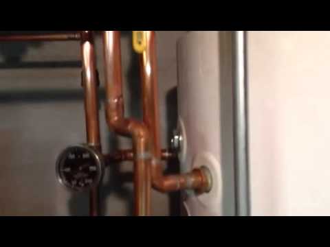

Sounds like marbles spinning in a coffee can. Noise comes and goes randomly but seems more often and louder lately . Most noticeable after a shower. Noise when boiler is firing and when boiler is not firing. Shutting down water supply to indirect water heater makes noise stop. Closing off the ball valve partially will reduce the noise.
One more thing, my son said he heard pipes banging last night as he was going to bed. I've never heard such banging.
Please share your thoughts. Thanks Don

    Mixing valve has not been installed. I'm thinking it may be some sort of cavitation from the ciculator.
  • Zman
    Zman Member Posts: 7,611
    Cavitation is a possibility.
    Can you post some pictures of the piping and circulator?
    What is the water pressure of the boiler side?

    Here a photo, will get more up tomorrow. There is 16psi at 140F.
    You can see a small section of the cold water inlet to tank below conveyor insulation.
    http://screencast.com/t/apY1KZ6ChmX

    Its the check vale on the inlet side of the pump. Not a great idea. The pump can cavitate in that position. Better to have it on the outlet.
  • Docfletcher
    Docfletcher Member Posts: 490
    No check valve. I believe what your seeing is the ball valve.
  • kcopp
    kcopp Member Posts: 4,577
    looked like a spring check.
  • Docfletcher
    There is a restriction there because the pipe goes from 3/4" to 1".

    Here is a better photo.
    http://screencast.com/t/mD97dAYiHZ57
    3/4" in and 1" out of circulator.

    I think the Groundfos is failing. The noise is there whenever it turns on. If someone jumps in the shower with the boiler off at 140F the noise will start as soon as the water heater calls for heat.
    The failing circulator is the Groundfos UP 15-41FR, used horizontal. I can either replace it with the same model or replace it with the UP 15-10FR. Would there be an advantage to going to the 15-10? Or am I better off sticking with the 15-42?

    Here is a link to what my Groundfos sounds like. The circ in the video was recently moved like mine was. The second link sound more like mine than the 1st link.
    https://www.youtube.com/watch?v=ITDBAf3Bitw
    https://www.youtube.com/watch?v=_0p_6I6C8lc
