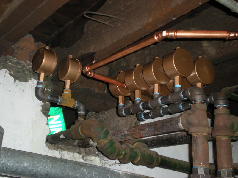

Here's a pic from Gerry Gill's website
http://www.gwgillplumbingandheating.com/wahelper/GetImage?id=92975
The basic idea is to keep the steam and condensate from beating the vent to death. My vents are on a tee at the end just like yours would be but I put an elbow and 10" nipple on them to get them away from the tee. You have some height available there which I would exploit to the fullest. Get it up high.0
