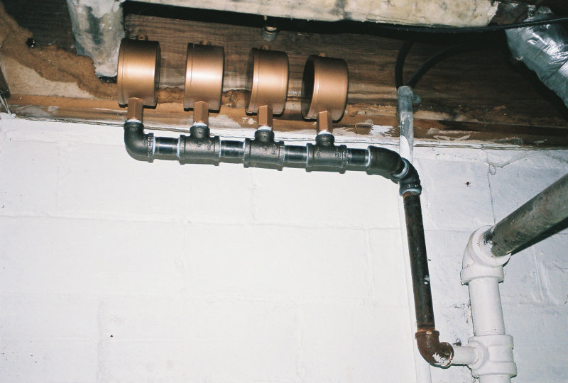

    Hi everyone,
    I have still only found one vent on the two mains that come out of our boiler. There is a vent on a return pipe (see pictures below). As you can see, pipe has been reduced to 3/8" off of what seems to be a 3/4" tapped hole. I'm planning on replacing this arrangement.
    Should I replace it with a 6" nipple of 3/4" pipe with a Gorton #1? (I have two Gorton #1's that I already purchased). I'm wondering if this is possibly not enough and that I should install an antler with a few #1s and possibly #2's.
    Should I measure the diameter of the mains in order to estimate the amount of air that should be vented? Dumb question: How do you measure the diameter of the mains when they are covered with insulation?
    By the way, this is work I can do myself in between heat cycles, right? I can create the nipple or antler and switch it out quickly when the heat is down?
    Thanks,
    Eric
    Single-pipe steam | 24 apartment, self-managed coop | Federal FST-40 Scotch Marine boiler | Carlin 701CRD burner | Heat Timer EPU-CH | Honeywell pressuretrols | Heating oil #2 (20% bio)
  • Steve_175
    Steve_175 Member Posts: 239
    Venting Capacity
    I am not an expert but an avid enthusiast of this Forum and steam heat. It seems to me from what I have read here that you will need significantly more venting than you realize. If indeed that pic of the vent is the only location you can find then you will need to set up an 'antler' with numerous Gorton #2's on it. Because of the closeness' to the wall I would put the whole thing together before you mount it using a union. And use piping as large as that original taping. Here is a link with pics to give you an idea of what I am talking about. Gill is not in your area buy he knows his stuff.
    I do not know how many vents you will need but I bet it will be more than a few. BTW a Gorton #2 has the same venting as 3 Gorton#1s' and is cheaper than buying three #1's
    http://www.gwgillplumbingandheating.com/webapp/GetPage?pid=414

    sizing vents for mains
    Thanks, Steve. Gill's photos are really helpful. I'm still wondering exactly how many air eliminators I should install.
    I will make sure to use at least a few Gorton's 2's on an antler. In order to determine the appropriate number of vents, I believe should measure the diameter of the return pipe and see if I can match the maximum air flow. Can anyone walk me through this calculation?
    The return pipe seems to be 2" in diameter under the insulation. The joint where the vent is connected seems to be 1 1/4".
    I'm wondering if I should use the method from the Balancing Steam Systems pamphlet: "Take the vent off the end of the main and fire the boiler. Once the header pipe gets hot, time how long it takes for steam to get to the open pipe where you removed the vent. Let’s say it takes three minutes, for example. If it takes three minutes to get steam from the header to the open pipe, then you would need to install as many main air vents as it takes, to get steam to the same point (the open pipe), in as close to three minutes as possible, but with the air vents installed." -- I think I could manage this, but I don't know how to fire the boiler manually. It uses a Heat Timer.
    OR
    if I should making the decision based on pressure and the size of the pipe like this: "A ¾’’ pipe at 3 ounces pressure from the boiler will pass 9.5 cfm. A Gorton #2 air vent at 3 ounces of pressure will pass 2.2 cfm. So 9.5 divided by 2.2 = 4.31 Gorton #2 vents."
    -- This method seems easier to me, but my pipe measurements are larger than the ones listed, which makes me think I did something wrong. The largest pipe in the chart I'm using is 1" and gives 11 cfm. I would need at least 5 Gorton #2s to vent this much air, correct? (I'm guessing this is more than a thousand times more venting than we're currently getting.)
    Is this 1" pipe and 1/2" connectors to the Gorton #2s in the photo below?
    (http://www.gwgillplumbingandheating.com/wahelper/GetImage?id=57869)
    I guess we will need to reduce from 1 1/4" to 1" to make the antler.
    By the way, this is a valve on only one of three possible main returns that I found. I don't see vents on the other two. My guess is that we need a professional to come out and add these vents, right?

    your present main venting is in need of more capacity. those dry returns would be the best place for them, on an antler, which you can probably do yourself. start out with a couple of gorton #2's on each dry return, and leave provision for more to be added later. this would be a perfect use for a good low-pressure gauge, as you can see from the back pressure during air removal, when you have enough venting on the mains. in cases like yours, i think the cost of correcting the venting could be paid back in a month or so of reduced gas bills!
    your risers may also benefit from more venting, and it may be possible to do that by putting one large radiator vent on one of the radiators served by each riser.
    try getting the mains up to speed first, and then see how evenly the steam arrives all through the radiators on top floor, before adding anything at the top.
    i see that a couple of the returns appear to be joined together at a point.above the floor, and i hope below the waterline.--nbc

    The calculations for 2" pipe comes to just over 12 feet. So I figure a Gorton #1 per 12 feet of 2" main. The out side of an average asbestosis wrapped main will be approximately 4 inches. That will give you a good guesstimate to start with.
         Is that a full sized tee coming out to the vent? Looks like it might be 1-1/2" there. Is the main pipe the same size?
  • eappleton
    eappleton Member Posts: 111
    size
    Yes, I think it is 1 1/2" coming out to the vent. The pipe seems to be 2".

    Thanks for the advice. Would I put the low pressure gauge at the end of the antler?
    You're right about the joined mains, I think. They are joined and are not above the waterline. The waterline is at about 5' and this is at about 2'.
    The two other returns don't have vents and don't appear to be tapped for a vent. How would I determine where to add the vents? 6" below where they go from horizontal to vertical. Maybe this is something I should leave to a professional: choosing location and tapping a hole?

    the answer is to change one thing at a time, starting with mains. when that main venting is proper, then start on the radiator vents. otherwise, you wont know what has improved what, without following these one-at-a-time steps.--nbc
