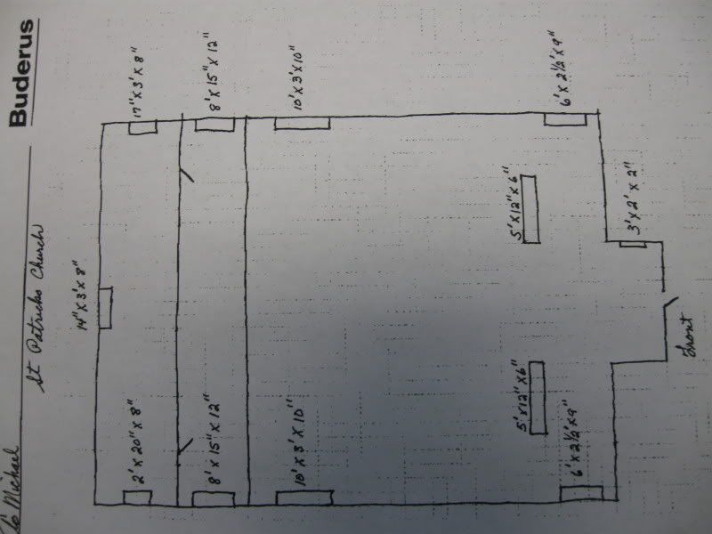

Steam to Hot water
I am looking at a church project that wants to replace their steam system with hot water. I have all the radiator sizes and all piping is accessible. I am having trouble getting calcs for these old radiators in order to size the boiler. Any help and or tips I can get from you folks would be great.0 -

The steam system is only in the rectory, single floor with all pipes on the first floor ceiling (all accessible). As far as corrosion, they have had radiators rust through as well as piping. The system is old obviously. I am not scared of rebuilding the steam system, the customer generated the call for going to hot water (not sure who or why they wanted this conversion). I definitely don't want to turn this into a call back nightmare, and can't thank you all enough for the replies. Michael0 -

http://i9.photobucket.com/albums/a54/ifish4fud/img_0421.jpg
This is the layout, hopefully you can see it.0 -
Rectory?
That looks like the layout for the main sanctuary.....
To Learn More About This Professional, Click Here to Visit Their Ad in "Find A Professional"0 -
It is. As I said earlier, this is a single floor level that is being heated.0 -
