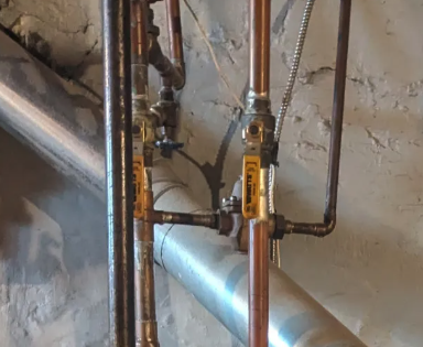

I recently drained my hydronic heating system (first timer here). That went well overall with help from other posts. Now I'm refilling the system, and experiencing a slow rise in pressure at the boiler pressure gauge, while the system sits cold and turned off.
I've read in multiple places that the PRV often goes bad, so I'd like to get some professional input before I go run out and buy one. It's a Watts S1156F PRV. I opened the lever a bit when refilling the system to let water in. Sounds like it might not be reseating anymore? The pressure goes up gradually as it's just sitting (noticeable over 10 minutes). When I close the valve coming into the PRV, the pressure stops rising.
Other notes, I did tap on the expansion tank, and it does sound hollow at the top. There are 2 zones. Zone 1 is series loop (1 radiator directly to the next and so on). Zone 2 is parallel (supply and return lines have multiple tees that go off into a single room). The baseboards are base ray cast iron, and after filling, I went through and bled each one (top floor first) until water came out.
  • Assuming the PRV is the cause of the pressure increase, sounds like I should replace with a Watts SB1156F?
  • As for replacement, seems like it's a union on one end, and a FIP on the other. Can I simply unthread and swap it out?
  • If I need to do actual plumbing work (IE: modifying connections), can I use pex here?

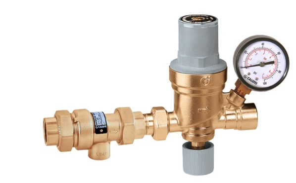

    You should have a backflow preventer on a boiler fill valve. Here is an example of a combi unit. Brass construction, BFD, Fill, and gauge. Plastic knob on bottom is a shut off valve.
    Looks like you have a tee above the expansion tank connection. That would be a good place to tie the fill valve in.
    Those two yellow handle ball valves may isolate the boiler and expansion tank connection?

    Put another shut off valve downstream of the boiler feed. Then if you have to replace/repair it, you don’t have to drain the entire system.
    I exclusively use the one Hot Rod pictured, but I’ll add a union on the downstream side, and valves on both sides.
