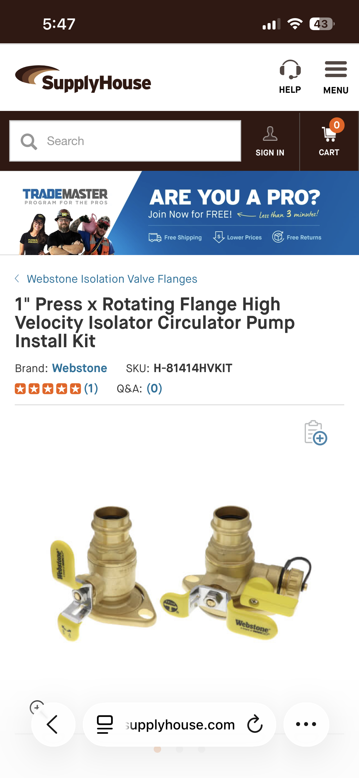

    hot_rod Member Posts: 28,012
    A valve set like this isolates the pump and gives you a purge port
    Then two standard ball valves on the return side to do a loop at a time
