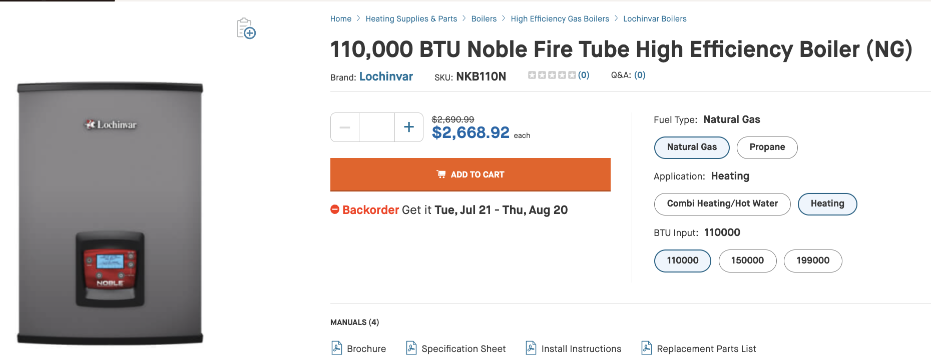

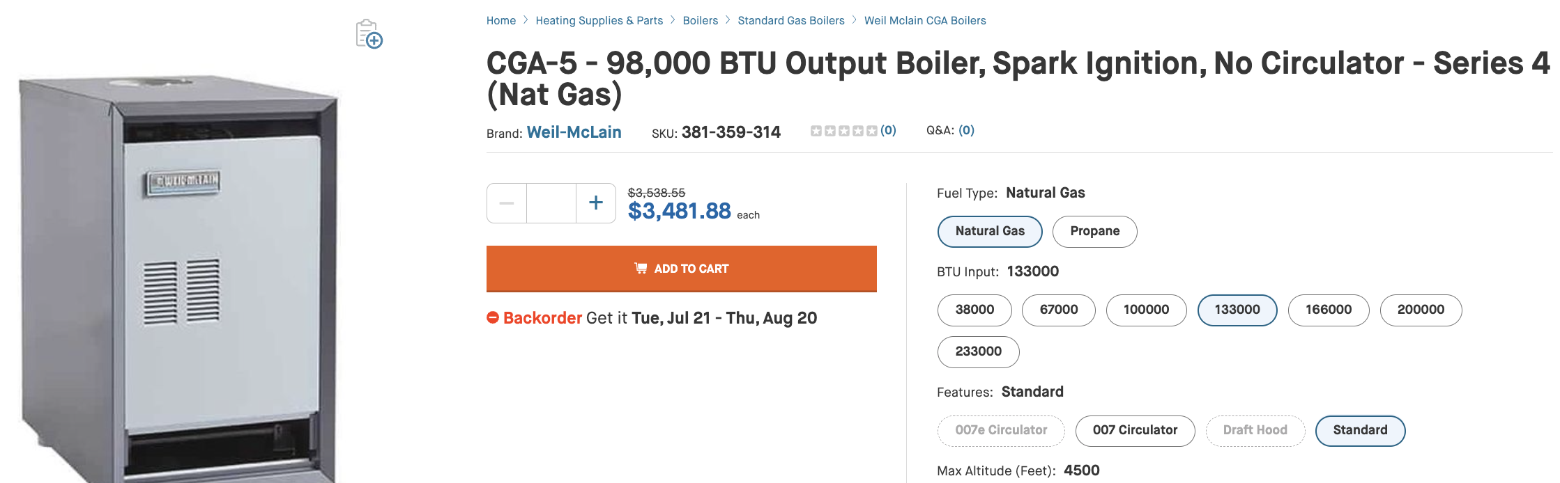

Similar output CI vs mod con $$
The Nobel is the price point Lochinvar, still plenty of control features compared to a Weil CI.
The $800 savings with the Nobel should offset any price difference?
