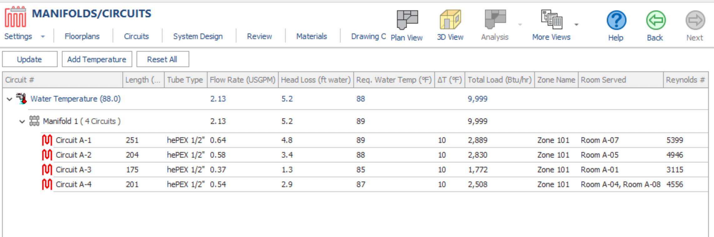

Hi. I am installing a hydronic system in my basement, and am unsure whether or not I need a buffer tank. LoopCAD shows the modeled slab load at 9,999 BTU/hr, but my Rinnai 90k combi-boiler minimum firing is 15,000 BTU. Will this 5,000 BTU difference be a problem for a slab that is 6" thick, located 6ft. below grade, and is insulated beneath by 2” rigid foam and on the sides by 1.5” rigid foam? My house is located in Seattle, so the basement is cool year-round. All of this information was included in LoopCAD’s calculation. I am primarily concerned with keeping a fairly even temperature for the slab and keeping boiler cycling at a minimum of 10 minutes to extend equipment life. Intuitively, it seems that even 15 minute programmed firing intervals would not produce much heat loss in this large, insulated slab, but I don't know for certain. If I do need a buffer tank, though, should I install it where I was planning to put a SEP-4 hydraulic separator or should I place it before or after the manifold? Any help is much appreciated. If any additional details are useful that I can provide, please let me know.

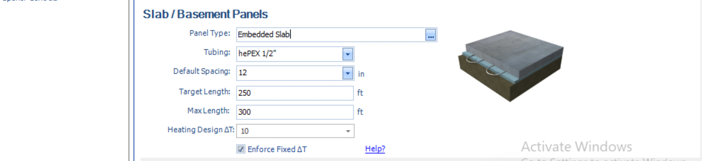

    Thanks for the fast responses. The slab is 980 sq. ft. and has four loops. The total 1/2" hePEX tubing used will be 831 ft, and will be placed 4.5" below the top of the slab (or 1" off the bottom of the slab). Spacing is 12" everywhere, except for the bathroom and office, which will be 6". The slab delta T is set to 10. The combi-boiler is the I-Series Rinnai IP090199C, and its water temperature minimum is 85 degrees. I'm just trying to avoid having to add a buffer tank later to deal with short-cycling. I'd rather add it now, if I'm likely to need it, although it would be really nice to not have another large item crammed into the room. The buffer tank calculation suggests a 14 gallon model for mild conditions. I've attached some images from LoopCAD if that helps. Thanks again.

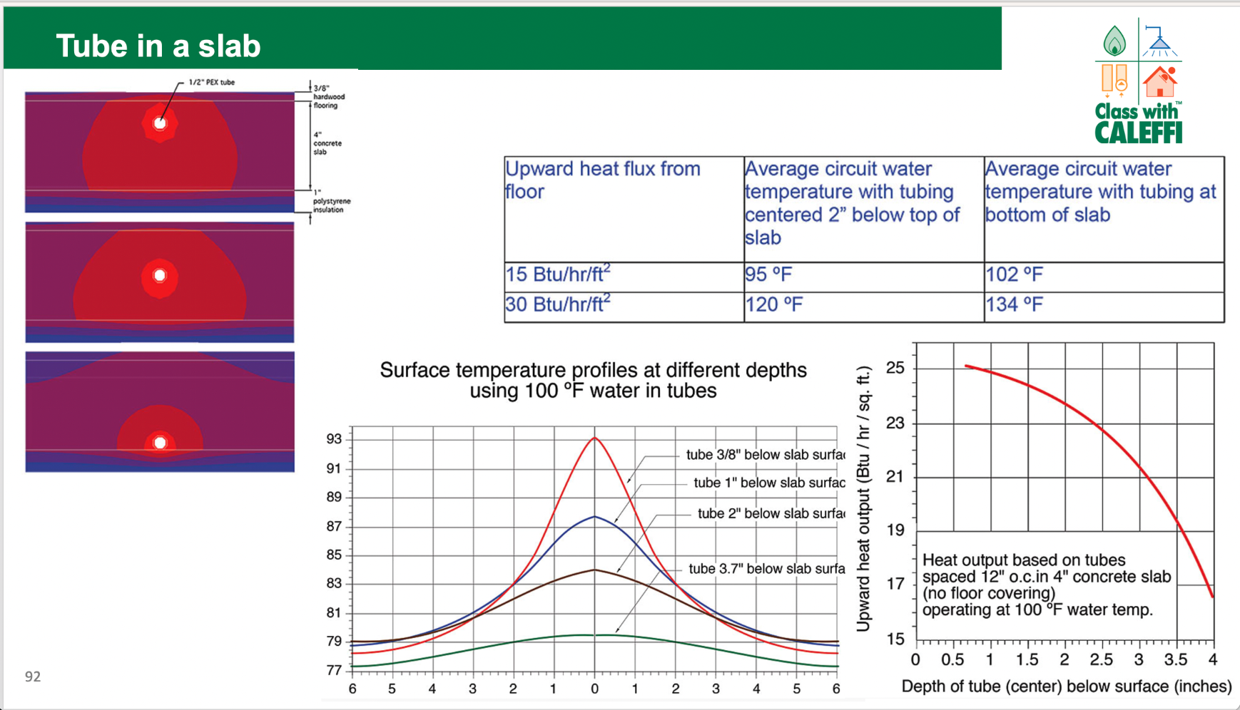

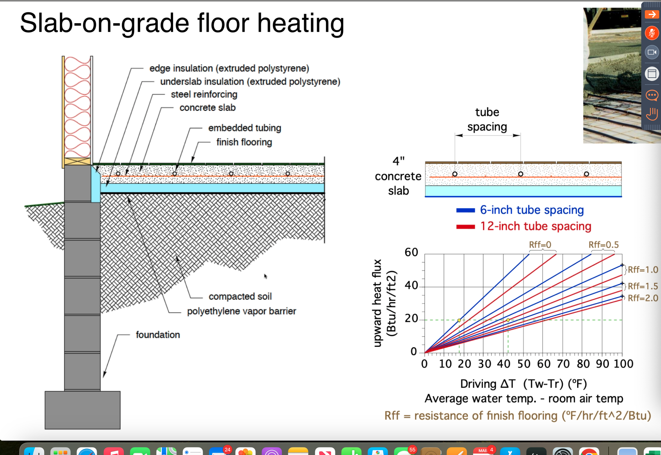

    Why a 6" slab?? The slab is a thermal flywheel. The more mass the slower to warm or cool down. It will not be very responsive to temperature changes.
    Also tube 2" below the top is ideal. Faster response and lower SWT will be the benefit.
    6" on center is a nice option also for low SWT and nice consistent surface temperature.
    Graphs below show the difference in tube depth and spacing.
    A 4" slab is about 34,000 lbs
    A 6" about 44,000
    The specific heat of concrete (btu required to raise 1 lb one degree) is 0.21 X the weight give you an idea of the warm up and cool down.

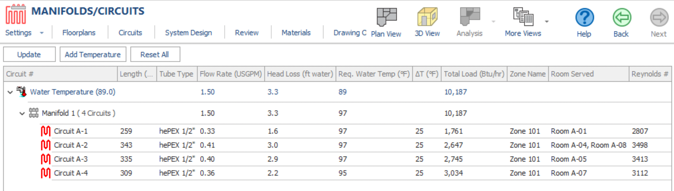

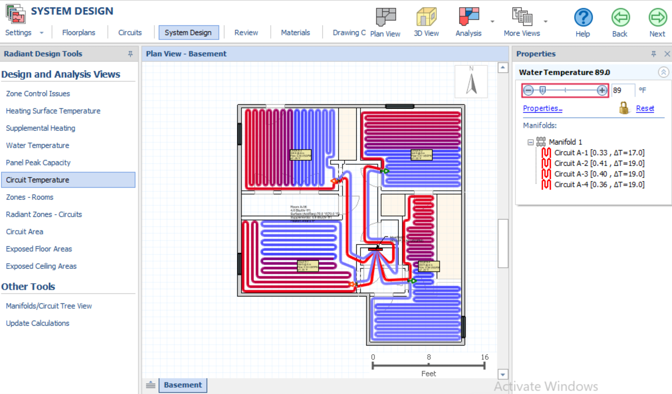

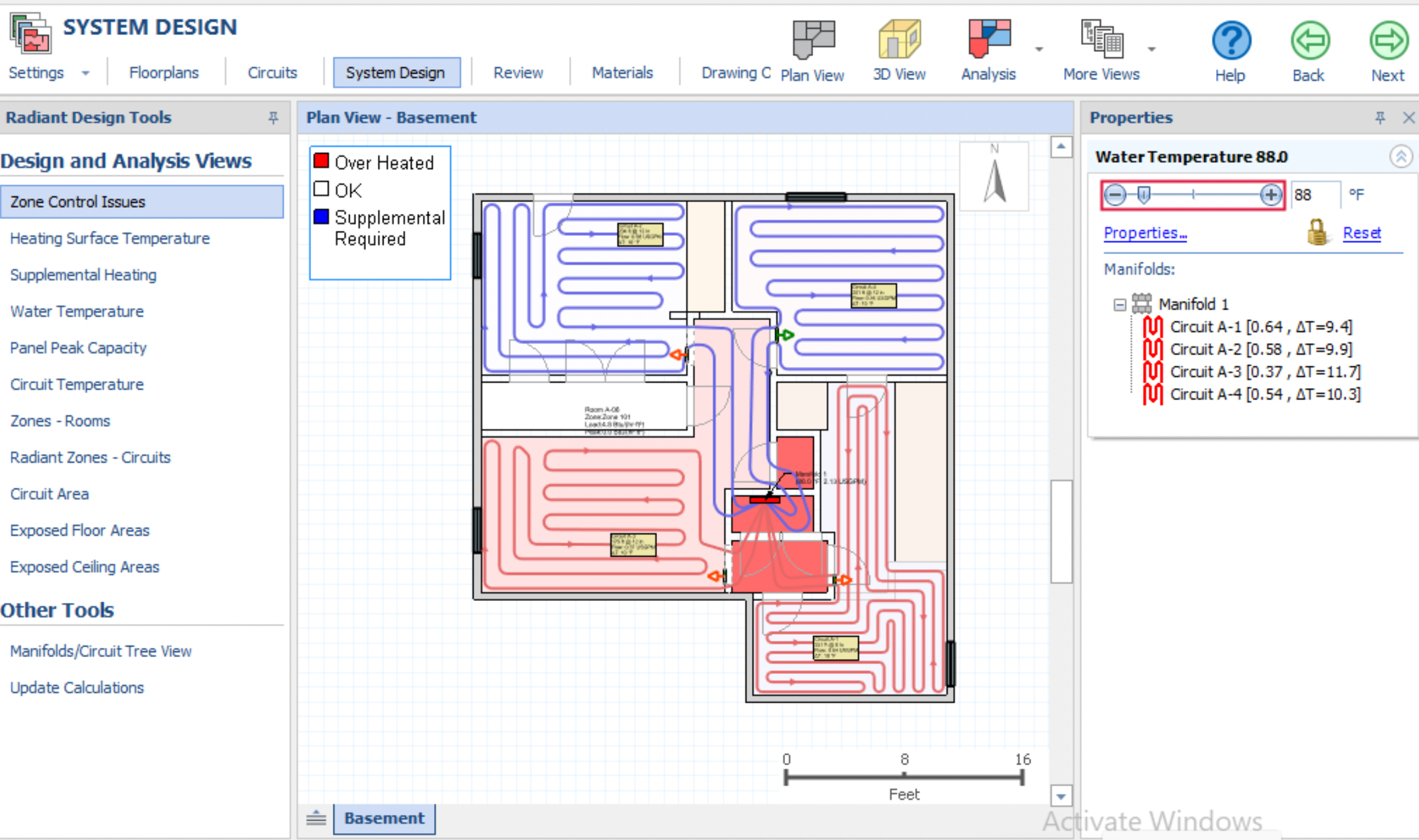

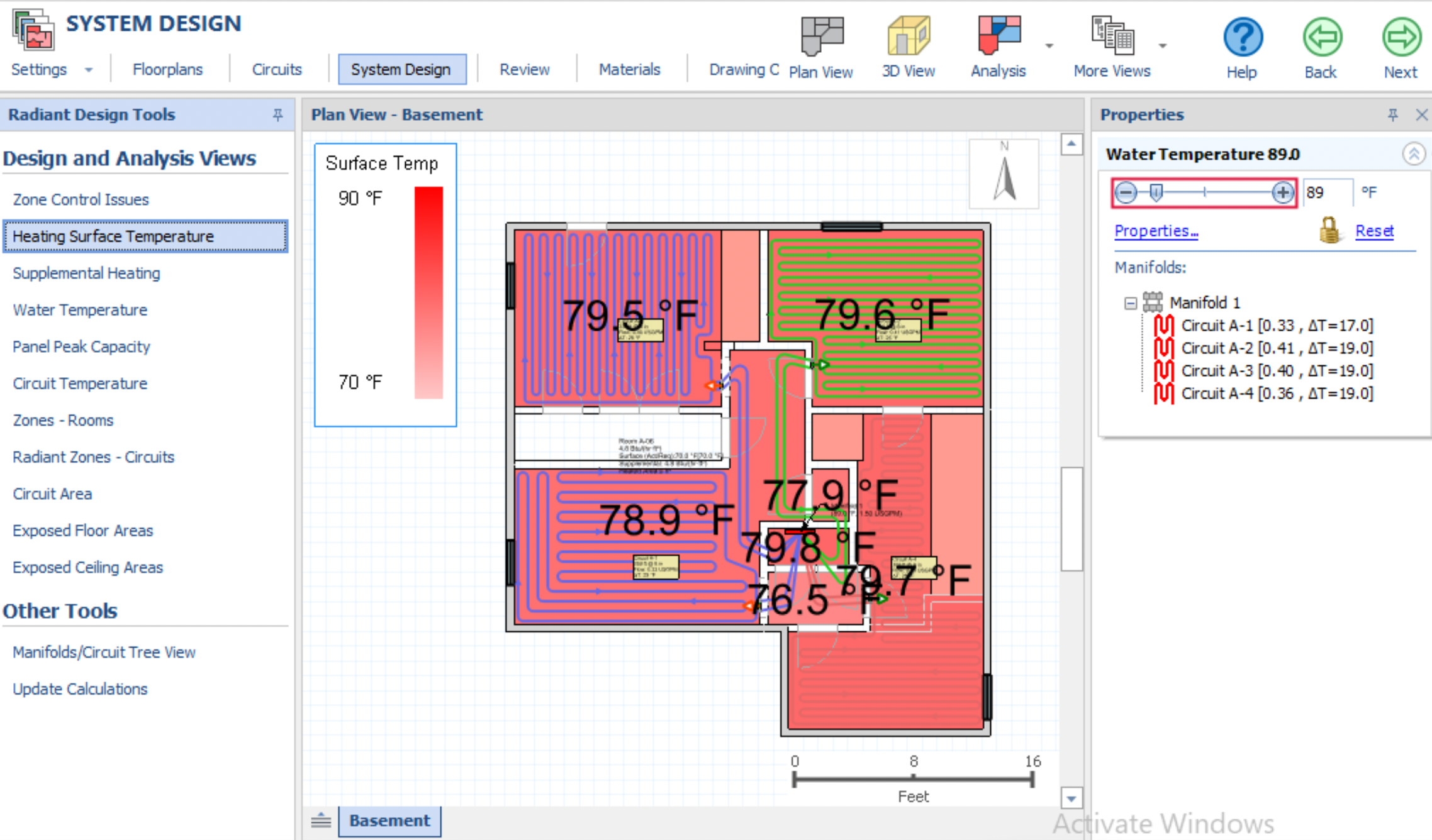

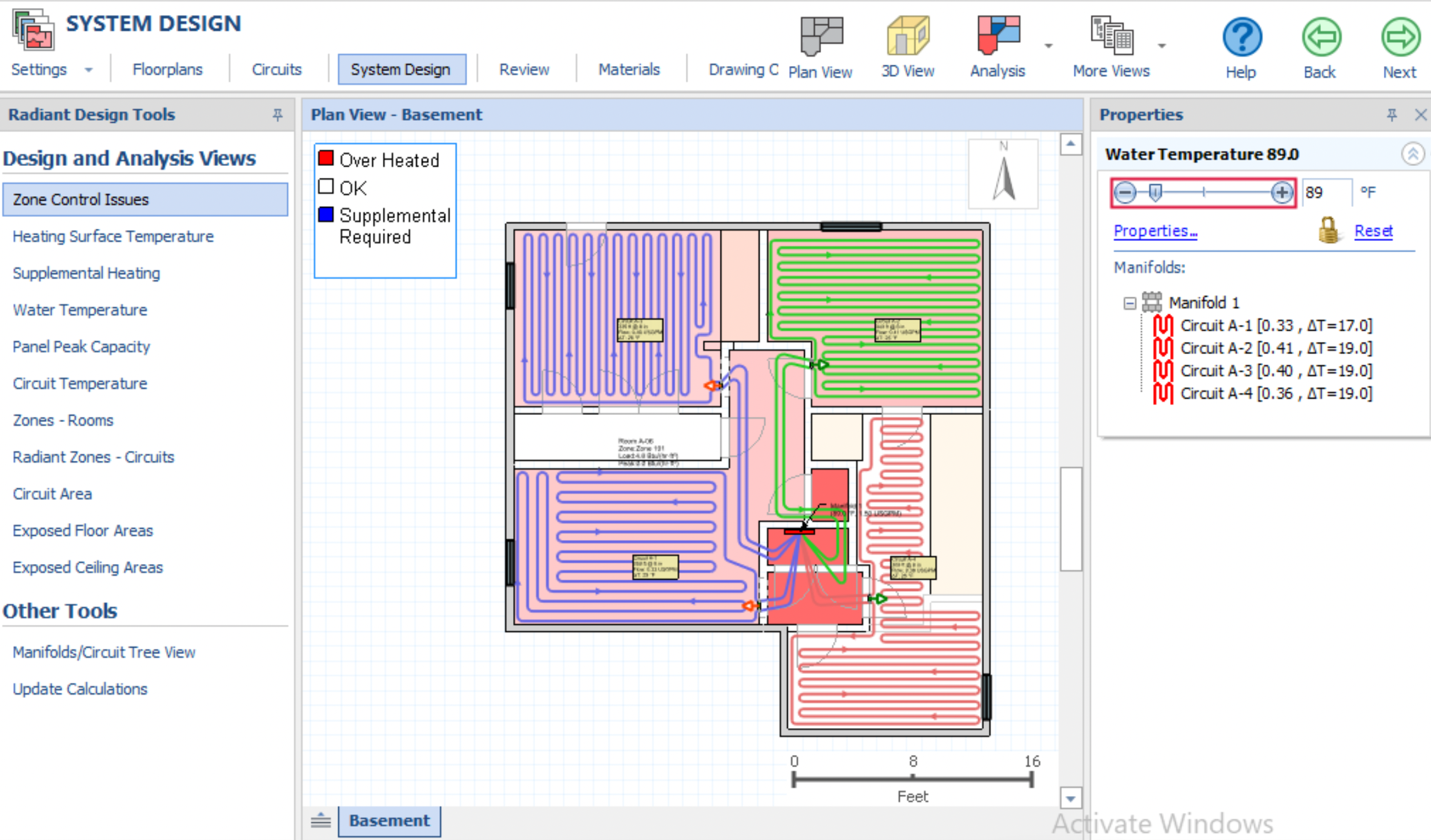

    Ok, thanks. Then it does seem that when I dial in temperature and time that long cycles will be easy to accomplish and a buffer tank is redundant/excessive. I have one follow-up question concerning comfort. I moved the PEX to 2" below the surface of the slab and changed the spacing to 6" for the whole basement layout, as recommended, and I also changed the slab delta T from 10 to 25. It does seem more difficult to get to a combination of settings that doesn't result in "overheating," according to LoopCAD's outputs, though. Some images are attached. Do you all think this is a better outcome than the previous settings, and do you think this latest iteration has any downsides?
    Screenshot 2026-06-13 at 16.42.52.png Screenshot 2026-06-13 at 16.43.22.png Screenshot 2026-06-13 at 16.43.33.png Screenshot 2026-06-13 at 16.45.04.png
  • brken
    brken Member Posts: 7
    One error. The bottom left room has 8" spacing, not 6".

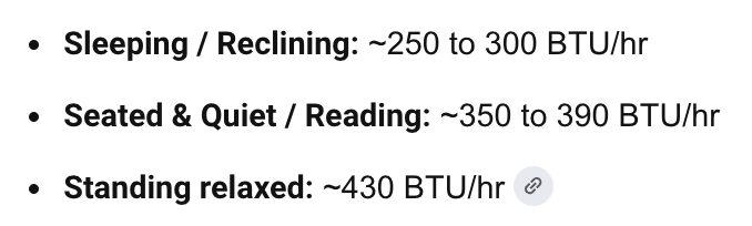

    You may not experience warm floors with a low load like that. In some cases the internal gains will heat the space without the radiant. A few humans in the space may be enough BTUs :) as long as you fuel, feed them.

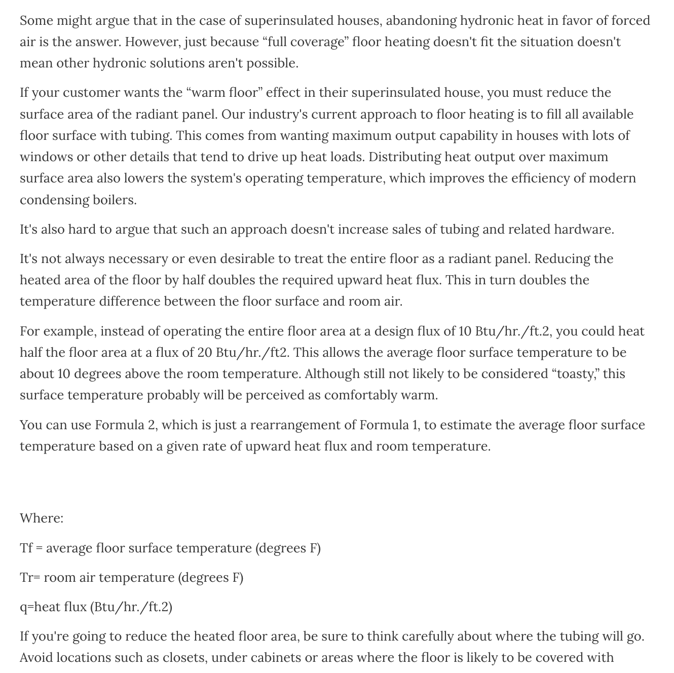

    I have heard of people deleting tube runs around them perimeter where you don't typically stand or sit. Concentrate tube in the center at a warmer SWT. So you still get some warm floor "feeling" without over-heating the space
    Do some more number crunching, this article has suggestions and formulas.
    https://www.pmmag.com/articles/83903-heating-a-thermos-bottle-house-br-john-siegenthaler
