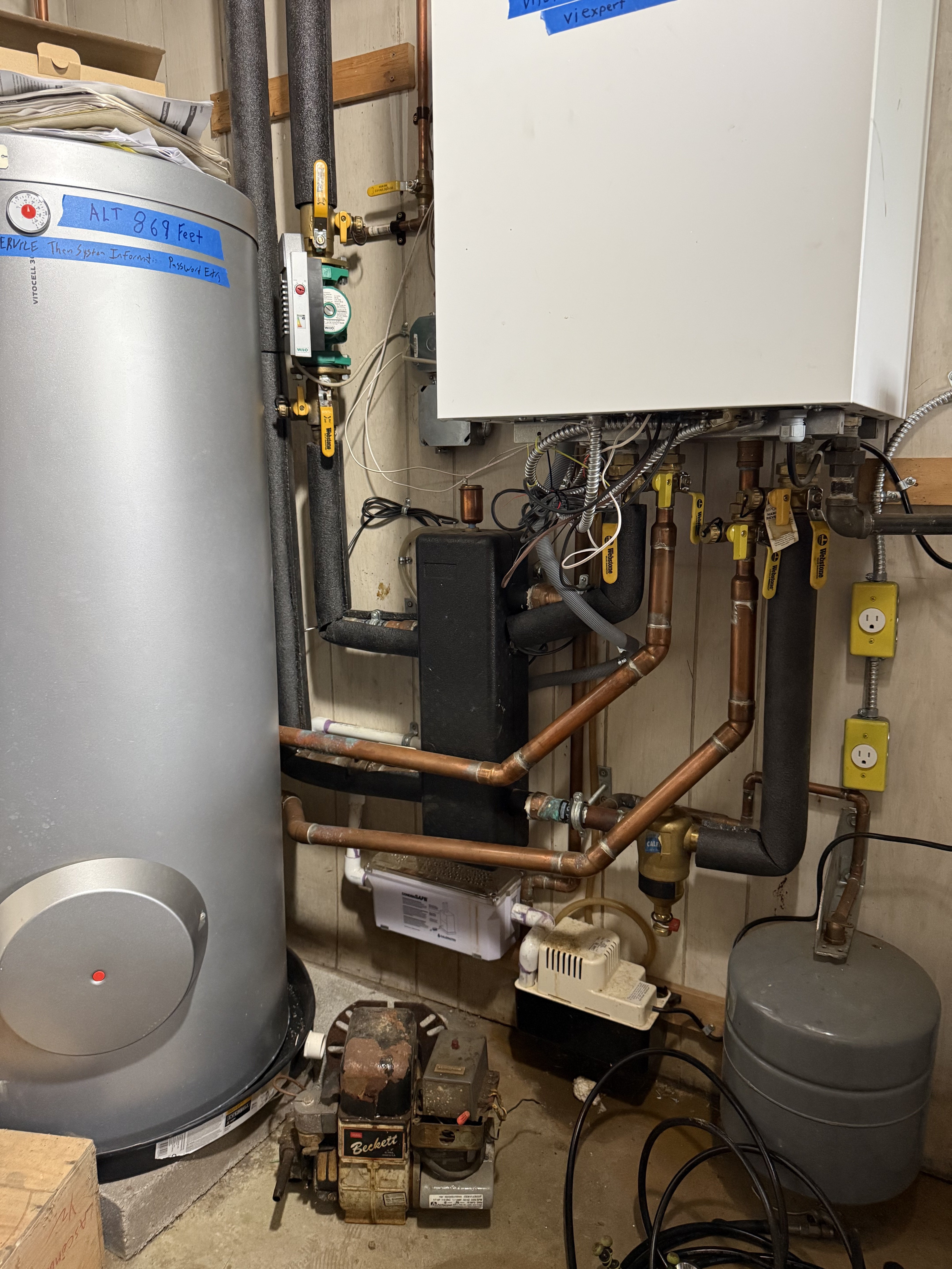

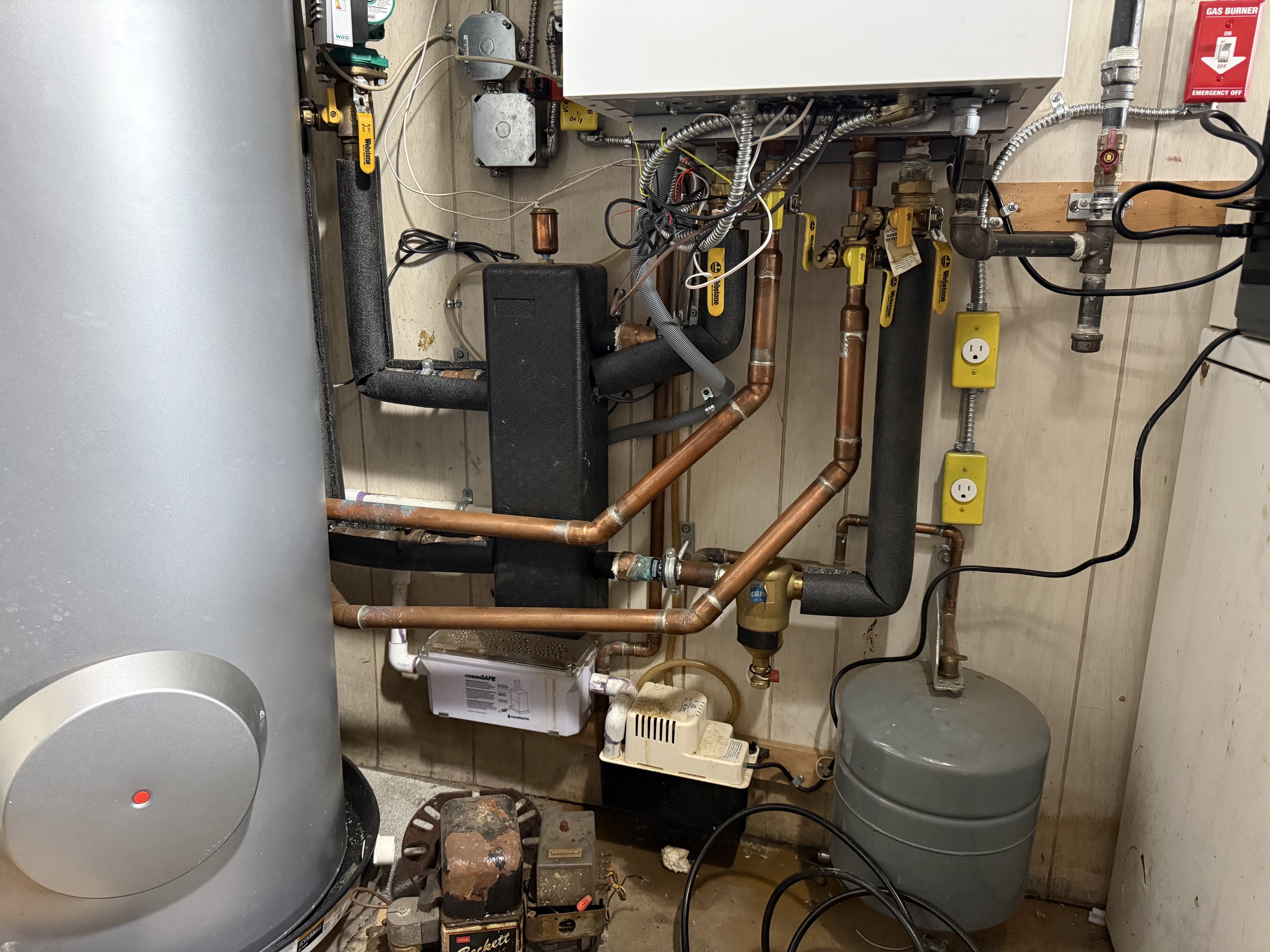

I have a B2HE-120 That is used at a vacation home. Two weeks ago tried to use the viessmann app to turn on DHW. It heated up the boiler but didn't heat the DHW. Then Truned it off and retried and it worked. Then off for two weeks. The boiler had lost power ie whole house did also. Today turn on hot water on boiler control panel and the 3-way valve stuck on heating no hot water running through Coil in IDWH only going to low loss header. Go into service menu and try and switch between heat only and DHW and Mix. Didn't work Heat only, not switching to DHW Indirect. After multiple times on and off main switch and then trying to excersise vlave it worked.

    If it works sometimes and not others my first guess would be that there is something physically blocking the valve (air, "junk" etc) if it has never worked right I would suspect there could be a misplaced check valve. the valve will reset itself on power cycle, can you take a pic of how the boiler is piped? I have seen similar motor/valve setups that had a restriction in the valve body cause the motor to pop off
    The expansion tank ties in the back between the low loss header and the dirt seperator.
