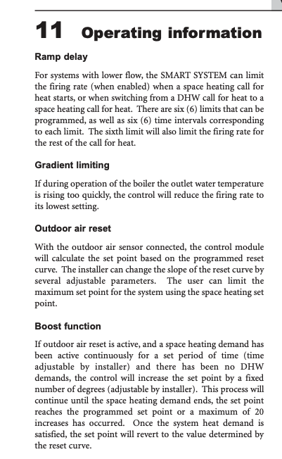

    What I haven't determined is how the ODR plays into ramp delay.
    With ODR, (boost enabled) you set a time period that IF the temperature has not increased, the boiler will ramp up.
    But, does ramp delay allow that. Or is it either or?

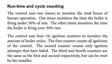

    Since you probably cannot spend days watching the boiler work under varying conditions you can use the Run-time function to look at how the burner was behaving over an elasped period of time.
    The goal is to limit the number of ignitions, which indicated how often the boiler cycles. BUT, balance this against the room temperature also. An efficient boiler cycle but an uncomfortable room temperature would not be the win.

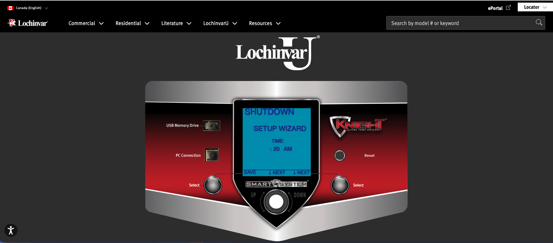

    You might try the simulator at Lochinvar U, see how much simulation you can do there.
