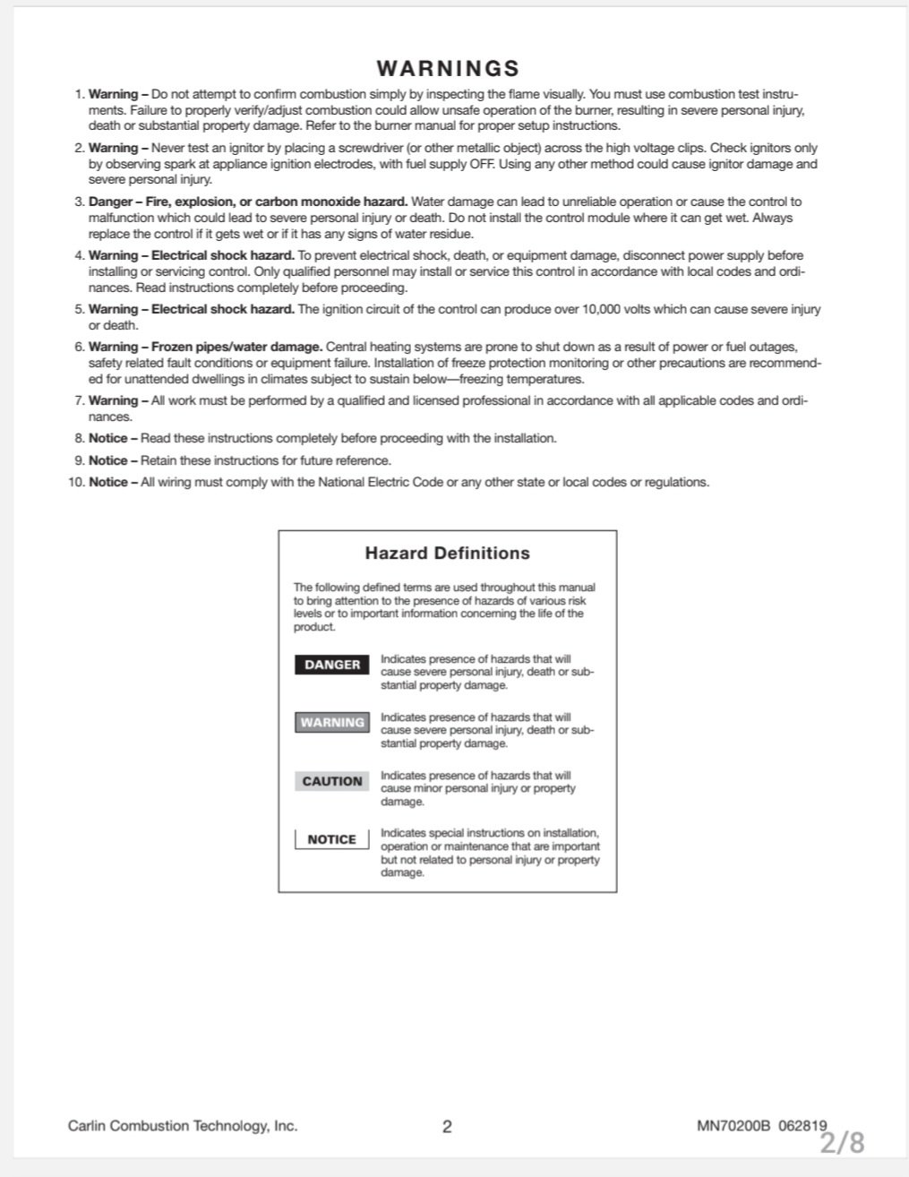

    @HydronicMike , I don't see a tech making that mistake with the pump prime. If a DIY guy does it, or even a tech for that matter, then there's only one person to blame. Carlin doesn't need to change anything. The lawyers took care of it.

    I disagree. What did the lawyers 'take care of'? If there’s one thing lawyers almost always do, it’s to put in disclaimers for every possible scenario. No mention in what you posted about pump priming. Not only that, but those instructions aren’t sitting next to the control. A homeowner could easily go online and read how to get a control out of hard lockout, hold that button down and when the burner fires up, I think they reset it, when they actually put it in prime mode. And as I said in my first post, they hear the burner motor running think it’s “running” it’s just pumping oil into the chamber if it didn’t light.
    Also on practically every primary control, holding down the reset button for an extended period of time is how you get out of a hard lockout. So it’s not a real stretch that someone can accidentally & inadvertently put it in pump prime mode. On Beckett's putting it in pump prime mode takes an extra deliberate step.

    Carlin shouldn't be responsible for the homeowner being a ****. It takes 10 seconds to enter pump prime holding the button in. And if I'm there with a 70200, and I need to stop pump prime, I press the button once. I wonder how I know this. Could that also be in the manual? A smart 6 year old could replace a 70200 primary. Its Plug-n-Play. That doesn't mean they should.

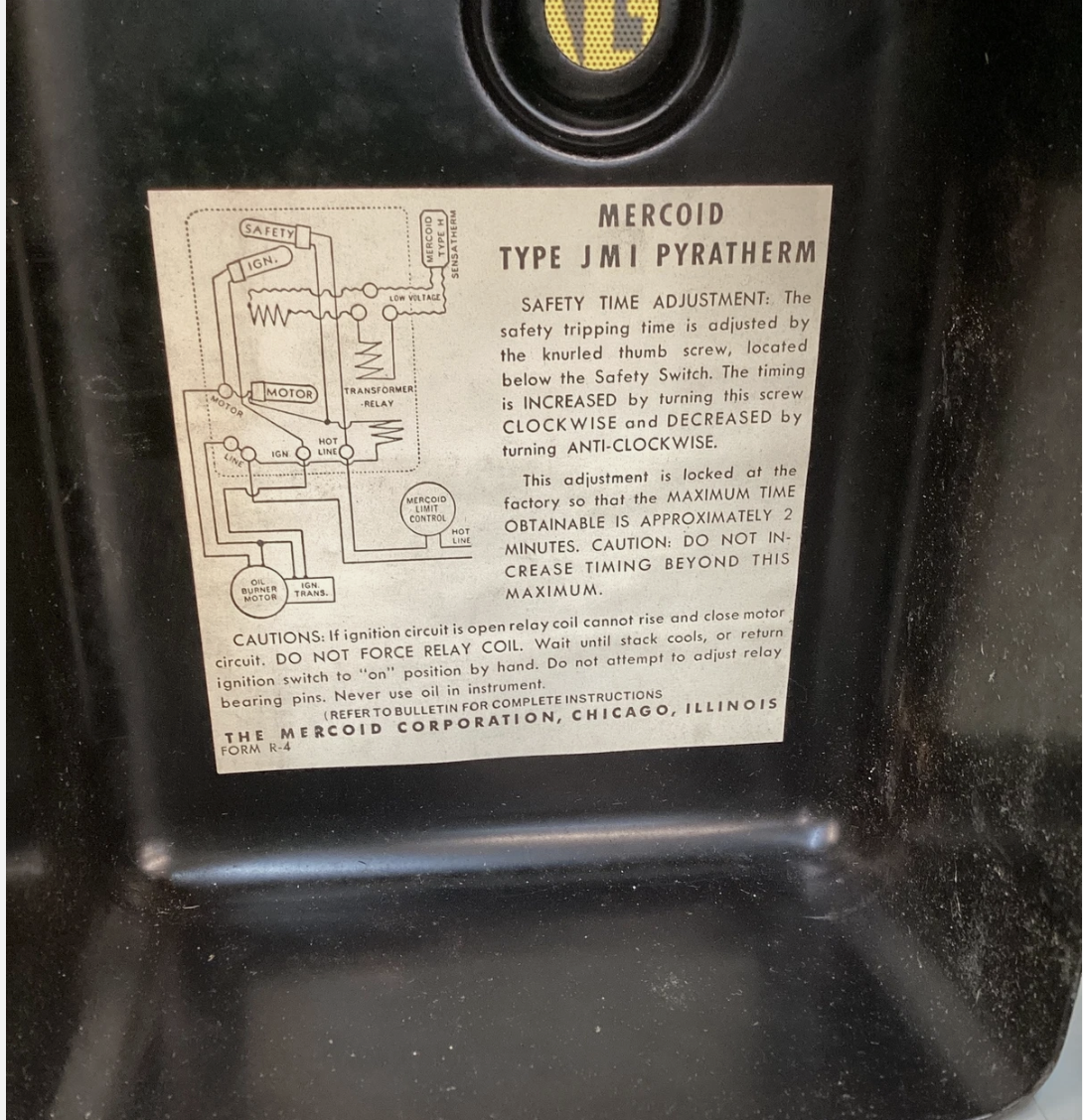

    What is wrong with the old stand by RA117A? The only one better than that is the Mercoid Pyratherm model JMI. There was an adjustable safety timing . You just don't get any better than this!
    Why did they ever stop making them!

    I guess I like the Carlin 70200 a little better than the adjustable safety timing of the Mercoid JMI Pyratherm. There have been more that one occasion where the diagnostics have helped me find something wrong with a burner that was intermittent, just by scrolling thru the past fault messages stored in that control. I like it better than the Beckett and Honeywell/Resideo
    But somehow I still am amazed by those tilting mercury switch relay contacts in the Mercoid. It kind of reminds you of a pinball machine flipper, and the little spark inside the glass tube making the connections. Todays technicians will never experience that joy of watching the mechanical pieces flip and flop to make the world a safer place for us all.
