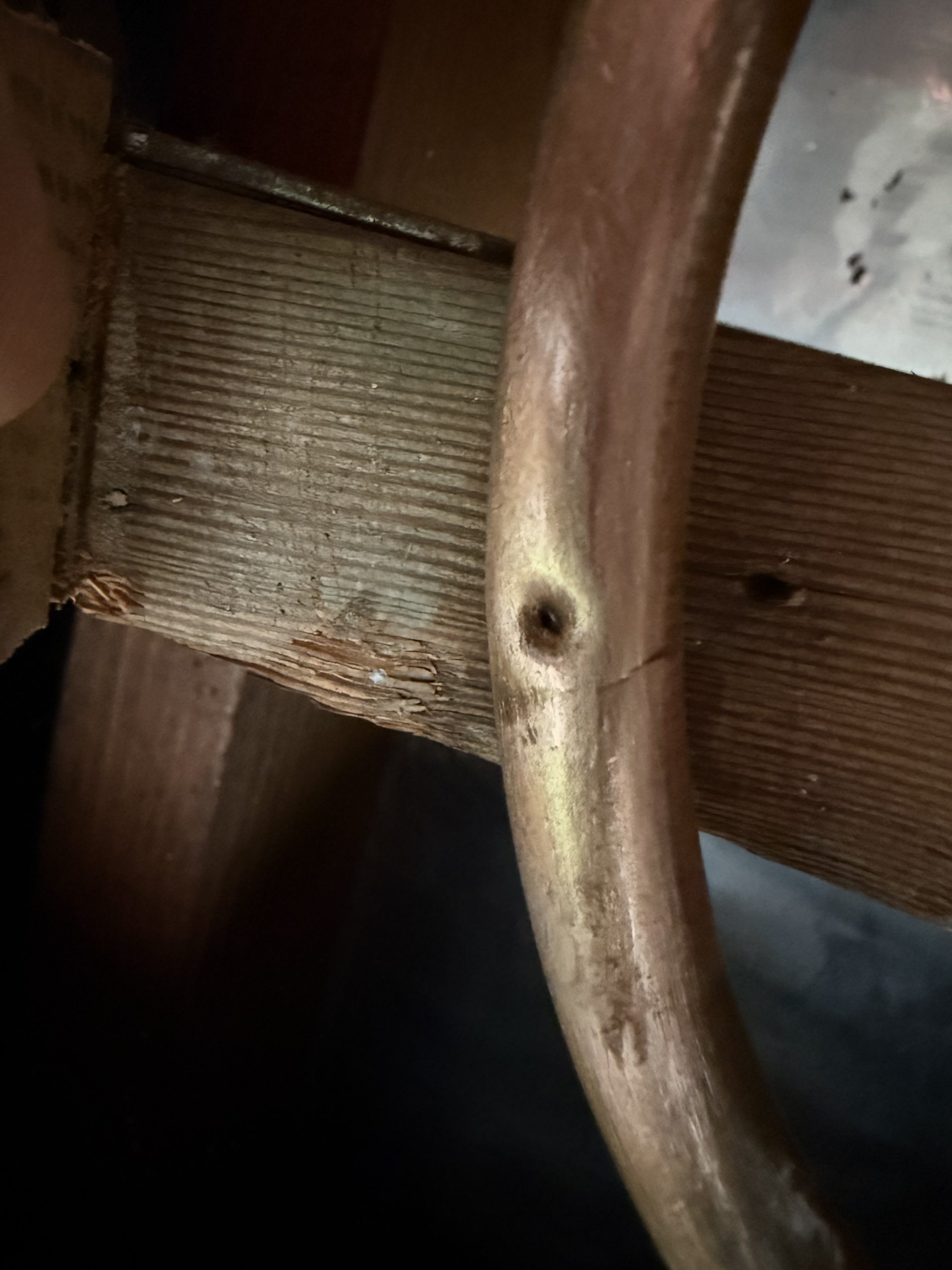

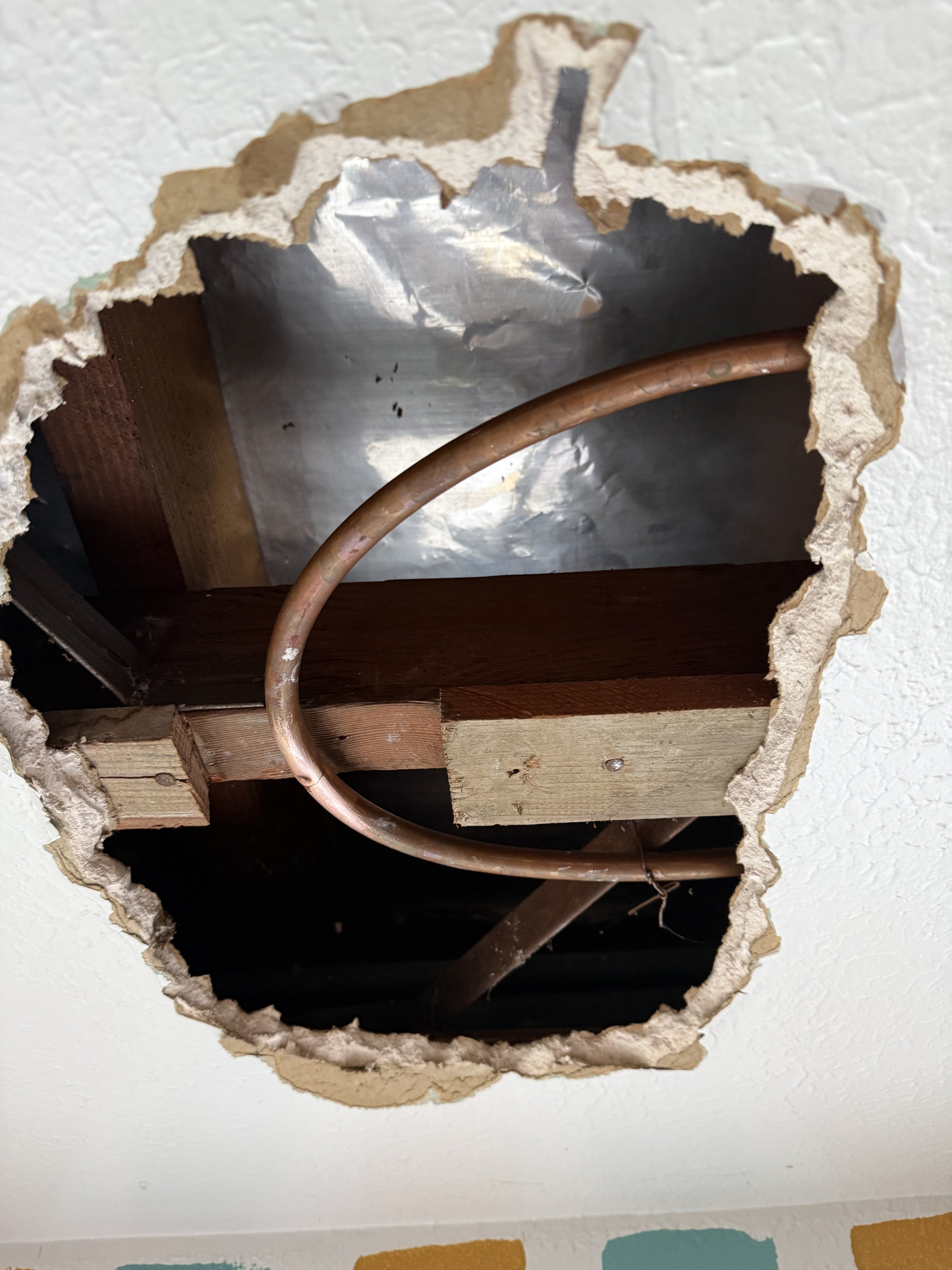

Living space below - roof above. Long time customer always complained that this room never heated well. And now - after they nailed the tubing - we get to see why.
No insulation in the ceiling; just that reflective paper that you see there.

    EdTheHeaterMan Member Posts: 11,764
    Someone needs to put some insulation above that tubing.
    mattmia2 Member Posts: 16,043
    but can you, or would it interfere with how the roof works, does it need ventilation below to not cook?
    snowmelt system for the roof.

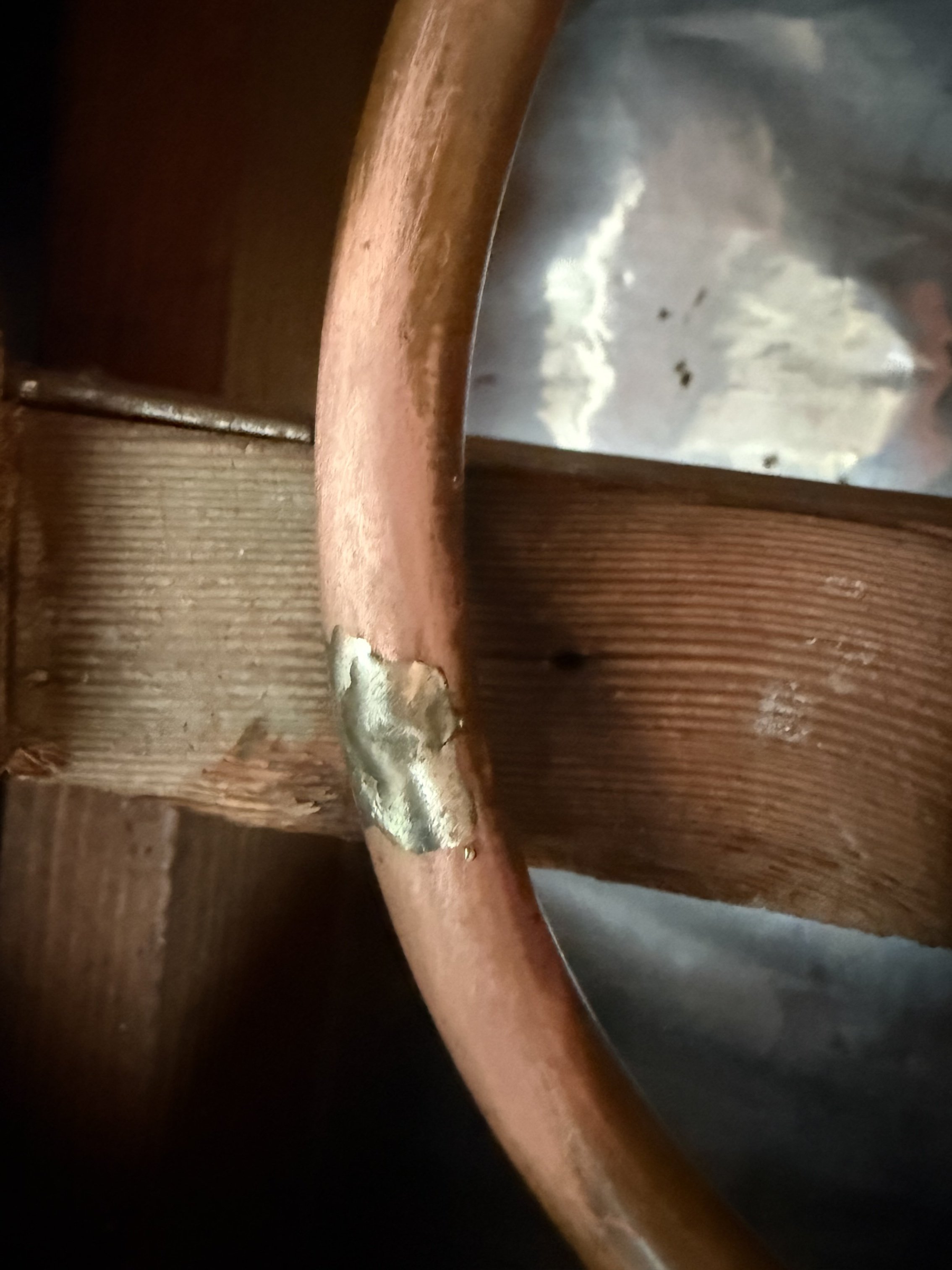

    Slick patch! So few people solder any longer.
  • Larry Weingarten
    Larry Weingarten Member Posts: 4,036
    Snowmelt for the roof where it almost never snows 🤔😁 And nary a scorch mark on the wood behind the tubing👍
    Yours, Larry
    ps, Maybe when they reroof, some foam board can go under a new roof deck…
    EBEBRATT-Ed Member Posts: 19,908
    edited 2:20AM
    The roofer was a good shot. Probably 5/8" od tubing and he got it right between the eyes. What are the chances. Dead center!!!
    Or was the nail from below?
  • DCContrarian
    DCContrarian Member Posts: 1,433
    Looks like from below, like someone was trying to hang something from the joist.
    now they need someone as good as you to match the texture of that ceiling
  • DCContrarian
    The biggest favor you could do those people is to trace the pipes back to floor level, cut them and put in a panel radiator.
    Then hook them up with a good insulation guy and a drywaller. Take the ceiling down and redo it.
