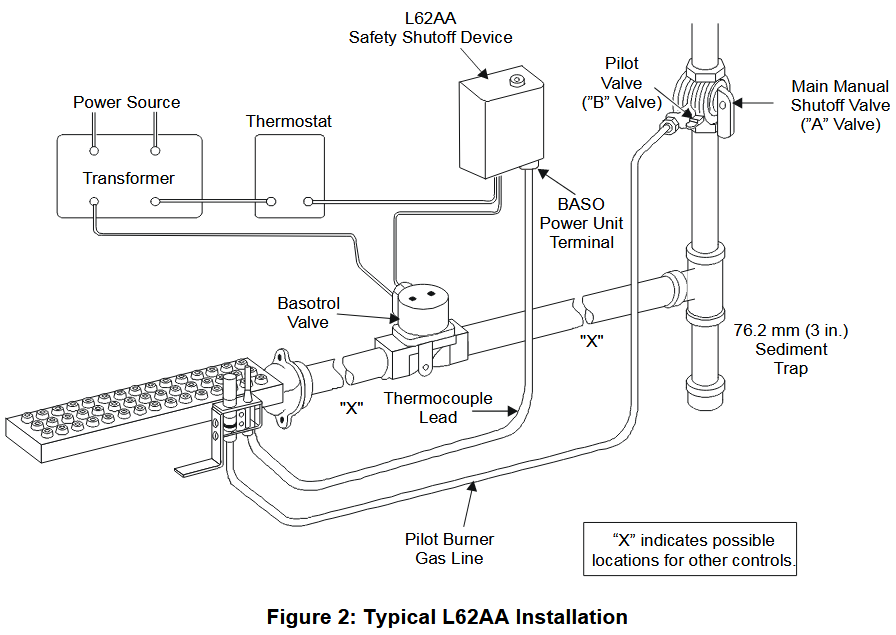

    Nationals used to have Baso Switches. The pilot stayed lit, but the baso wouldnt allow the main burner to fire. If it has a Baso switch, reset it. If that doesnt work, replace the thermocouple and try again.

    so is it a thermocouple or a flame sensor. it is mounted right in front of the pilot flame. sometimes if it didn't turn on main burner, it would if i held a flame to the other side of it. I also removed and tried to clean it. I read they would get a build up of carbon or soot. It does not have a wire attached to it but rather a thin metal flexible tubing

    Sounds like Baso switch scenario. If the thermocouple goes bad or it not correctly orientated into the pilot flame to heat it sufficiently the gas valve will not open.
    Pictures would help.
    Your system may be like this. Where a bad thermocouple will not shut the pilot off but will lock out the main burner.

    It could have a powerpile(wire with 2 leads), a thermoplastic (head of power pile but one bi-metal lead with a nut) or a thermocouple (smaller head bi-metal lead, same as most water heaters). Usually a baso set up has a thermocouple, but it depends on the base. Send pics of what the lead from your "sensor" goes into, and the "sensor" at the pilot assembly.
