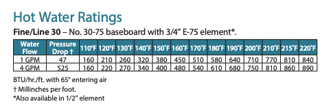

    If you could measure the temperature going in and out of that zone you can get an idea of how much heat output you are getting.
    If it enters at 170 drops 15-20 degrees then AWT average water temperature is 160. So 450 or so BTU/ ft
    This chart shows output at different temperature. Increasing supply to 185-190 as @bburd suggested increases output as shown.
    180 gets you 580- 600 btu/ft. Which may just cover the shortfall.
