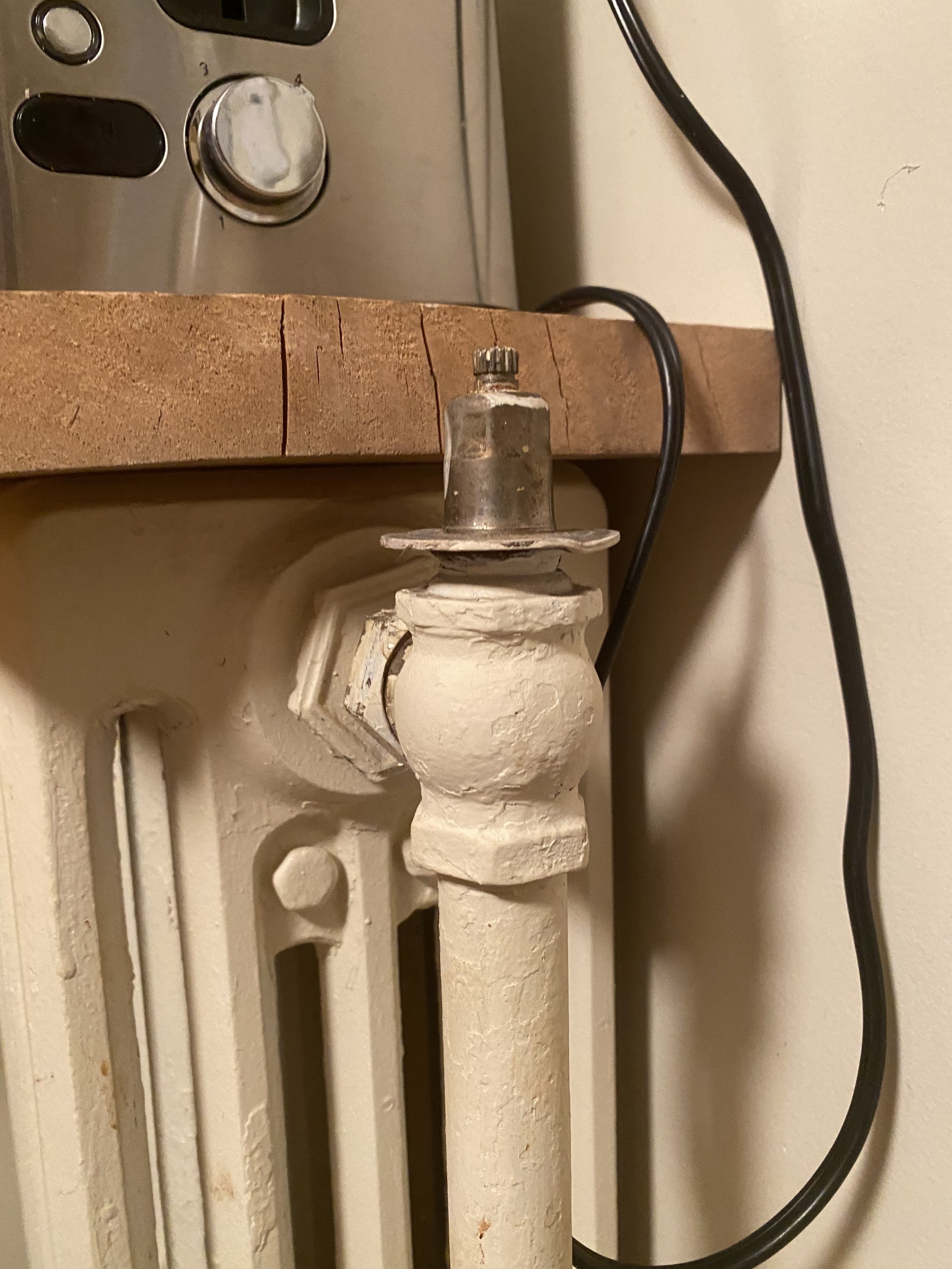

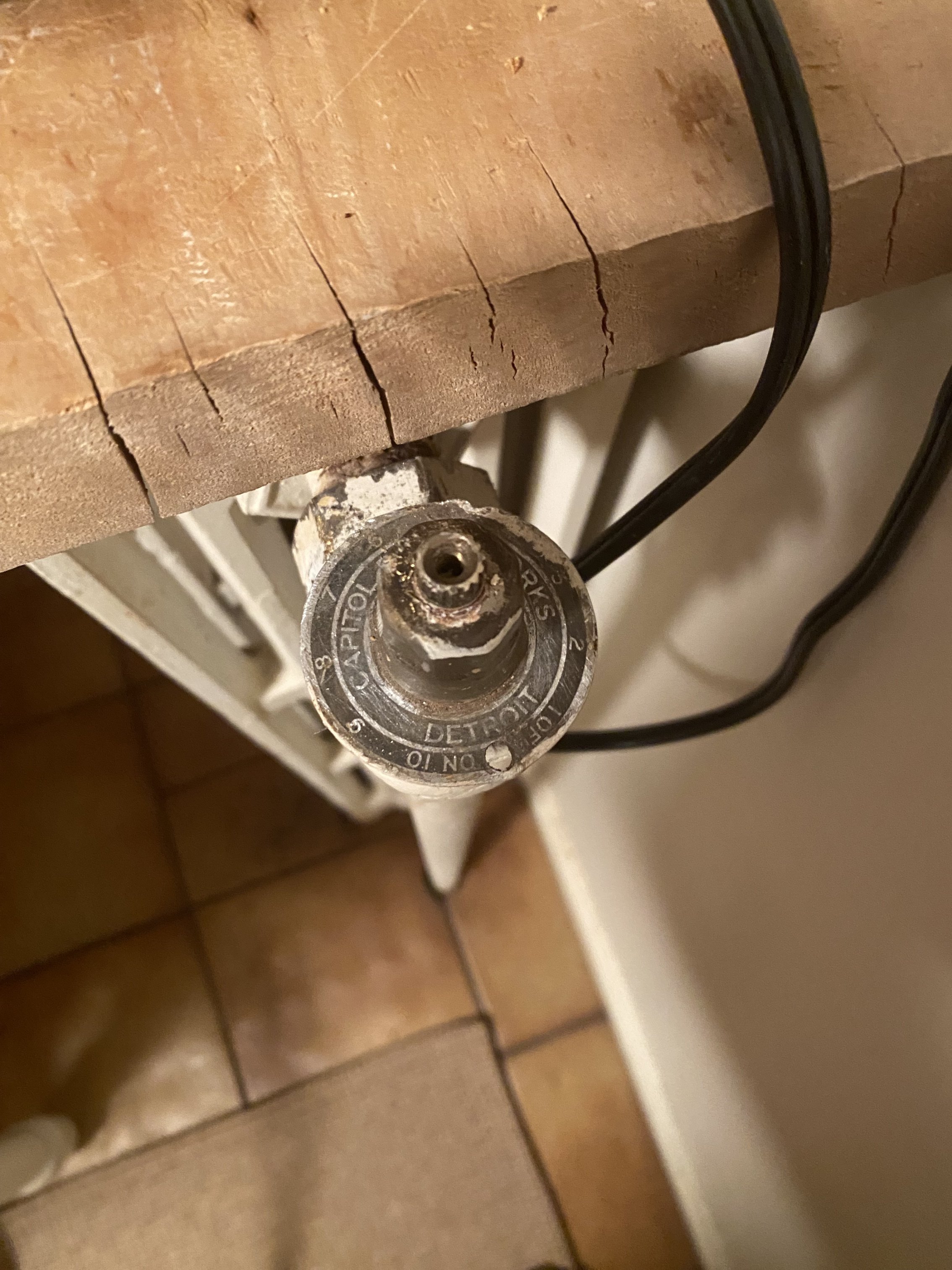

please advise -how to loosen stem. What tools what I need to remove the valve.

    does that top stamped piece pull up and off or unscrew? don't force it but see if it comes off

    it is . Tried several times to loosen but can’t get it to budge. Would a impact driver and 3/4 socket work to remove it. Any suggestions where I can purchase a new valve.

    I think tunstall makes a vapor valve. it can also be replaced with a regular valve and an orifice plate. heating it may help it come apart if you can do it without burning the plate

    @magewick what do you disagree with? someone, i think it is tunstall makes a metering valve. you can also do the same thing by metering the steam with an orifice plate in the union.
    *mepco
    if you take the valve off and work on it on a bench with a vise maybe with soft jaws you have more options to coax it to come apart in one piece but that is more of an off season project.
    Steamhead Member Posts: 18,290
    The MEPCO SWRF valve is another option.
