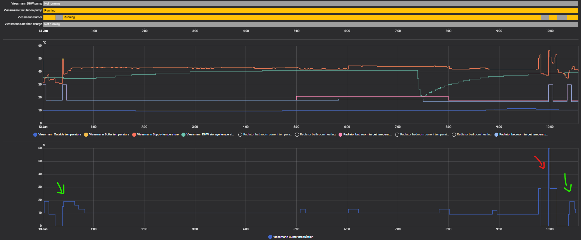

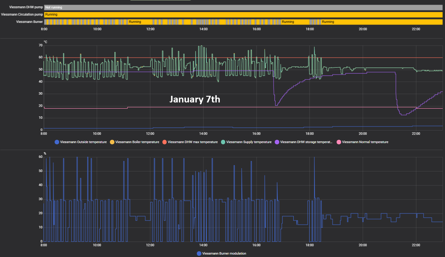

As you can see that the burner modulation is not stable, starting at 60% (like every start) but then instead going to 10-15%, it keeps the power to 30%, this caused the water to spike and the boiler thinks that it reached the target temp and stops. While the water had no time to really circulate.
3 times over that day (at 11.30, 17.00 and 18.30) the boiler managed to work properly as it was maintaining a stable water temperature. Why is it not doing this all day long?
I tested the relays, as the manual recommends and the base load relay only set the boiler to 30%, like if there was something preventing the boiler to go lower than that. Is this the root cause issue? Thought sometimes it manages to go lower than 30%.
Over the worsts days, the burner can start more than 100 times! It seems to be worse when the temperature outside is above 5deg C.

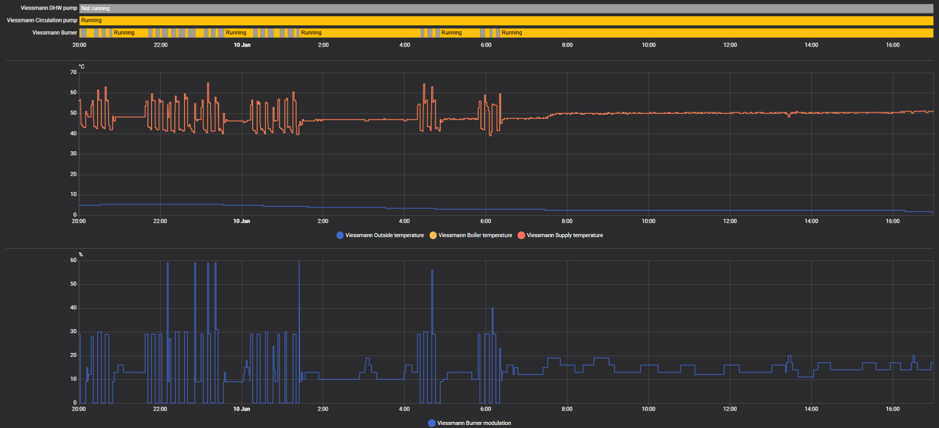

    Over the last few hours the temperatures dropped (from 5 to 2deg) and the boiler seems to better like it:
    You can see that the supply temp can be super stable and the boiler just modulate perfectly.
    Now that the boiler seems to be able to work at a low power, I tried again the "relay test" on the base load and it works, the boiler goes to 9% (the min) after about 1minute.

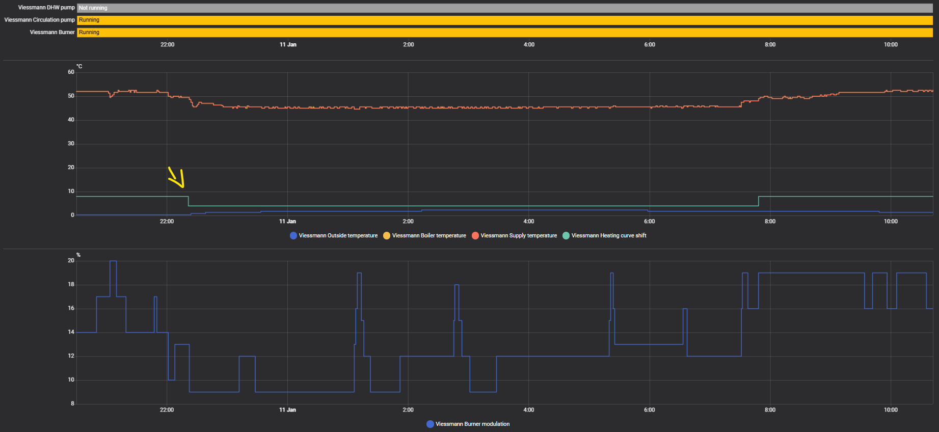

    Regarding the ODR settings, I was quite happy with them, the shift of 8°C and a slope of 1.3 worked pretty well to keep my place at 19/20°C in all conditions.
    Though I did a test yesterday evening and dropped the shift by 4°C:
    The burner reacted just fine, although this morning it was a bit cold inside so I set it back to 8.
    Note that the current outside temperatures are quite low, around 1°C and the burner works like a charm.
    I'll wait for the boiler to short cycle again when the temperatures will reach 5/6°C and try the suggestion of @Eastman. What will this test trying to show?

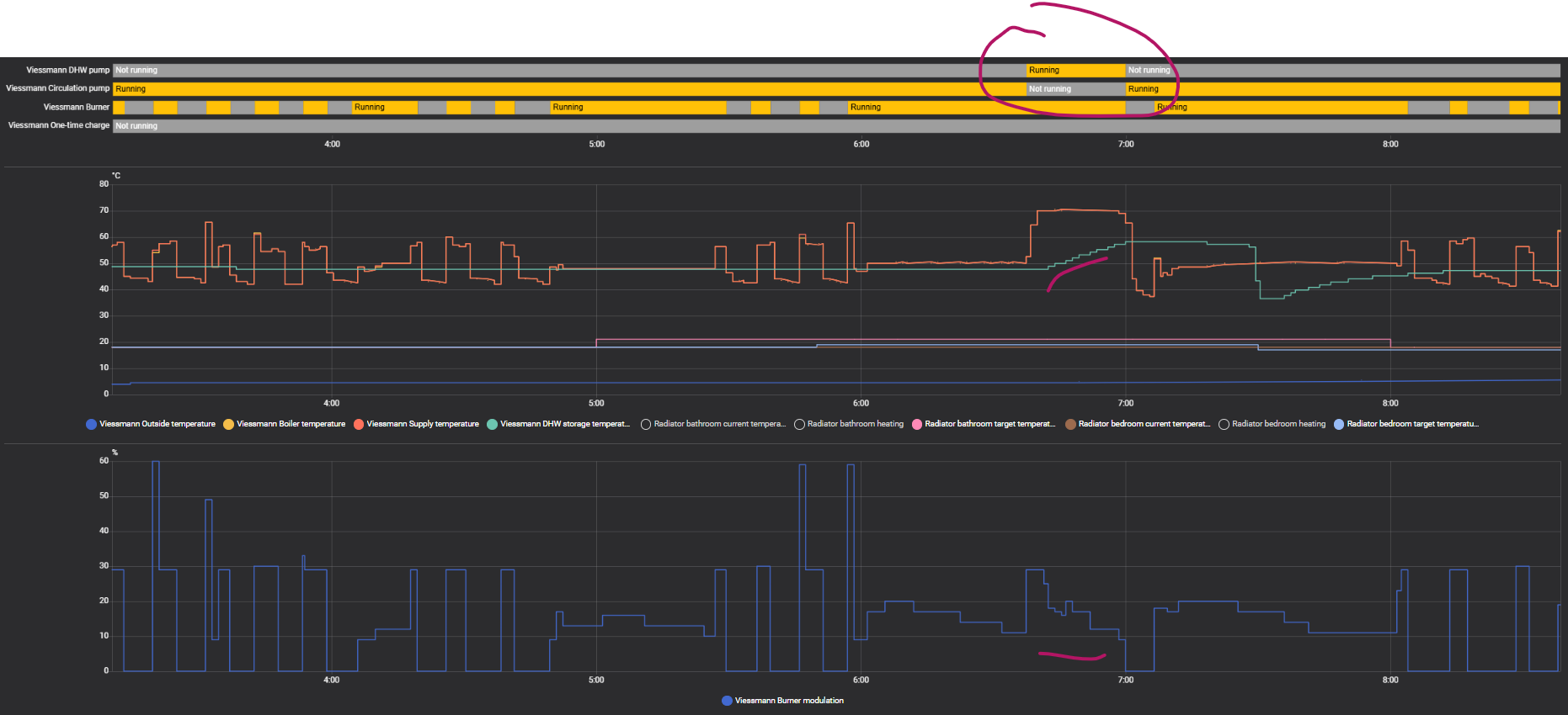

    If the system is piped without a low loss header, it's possible there could be insufficient flow. I would like to see a data plot with the TRVs essentially disabled, and no longer regulating system flow through the radiators.
    What happened at 16:40 in your original data plot? The DHW storage temperature drops to 20C and then takes a long time to recover with continued intermittent short cycling.

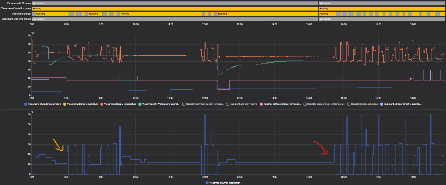

    I made a couple of tests over the last few hours. Since the outside temperatures are up these are "ideal" conditions for the boiler to short cycle.
    1/ In the below screenshot you see that the boiler was running smoothly for an hour until the power goes up to 30% (yellow arrow) for no apparent reason and then stops. After some analysis, at 8am two things happen, my smart TRV in the bathroom closes and the target indoor temperature goes from 19 et 18°C. I understand that this flow reduction might be the issue. But what I would have expected is for the boiler to simply run at a lower power, from 11% to 9% for instance and not go up and stop eventually.
    To confirm this I made a new test at 15.45 (red arrow), the boiler was running smoothly and I intentionally closed 3 TRV, same behaviour.
    2/ I tried to leave more TRV fully open. In total there are 11 radiators, all with TRVs.
    Before I had
    • 2 always fully open (5/5)
    • 2 at 4/5
    • 2 at 2/5
    • 3 are on and off demanding on our usage (two are smart TRVs)
    • 2 are always closed
    Now I changed to this:
    • 4 always fully open (5/5)
    • 2 at 2/5
    Also I added a rule that does this:
    When the burner starts, immediately open fully two smart TRVs for 5 min and increment the indoor temp setting by 4°C for 8 minutes.
    The goal is to increase the flow when the burner starts, to help him evacuate the starting heat (since the boiler always starts at 60% power) and give him a change to stabilize to a lower power.
    This seems to improve the situation but not drastically, here is the graph with this logic implemented:
    3/ @Eastman regarding the drop for the DHW storage temp in my initial post, this is simply a shower. I guess that the slow increase folowing the shower is simply the fresh cold and hot water left in the tank mixing over time. The tank is heated only at specifit times, you clearly see when, and at that point it is really fast:
