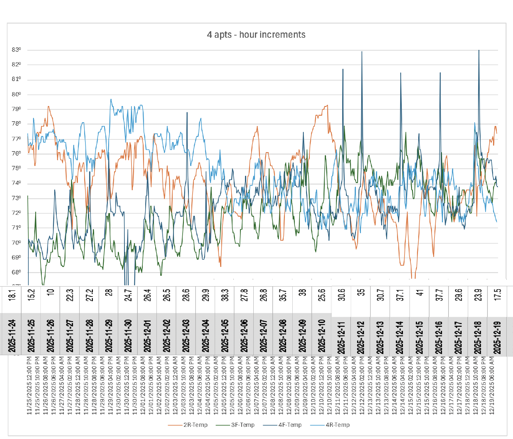

I'm trying to even out a steam heating system in an 8 unit self-managed condo building in Brooklyn, NYC.
There seems to be a roughly 10ºF swing between the warmest and coldest measurements in the apartments.
We have a Honeywell thermostat in the staircase/hallway, plus 4 remote sensors (in 4 of the apartments).
Until recently, there have been strange heat spikes at night, when the thermostat was set to a lower temp.
What issues should I be looking for? Broken valves? Boiler maintenance issues?
What other information would be helpful?
Attached is a chart of the 4 Bluetooth thermometers in the apartments. At the same time the Thermostat has been set to 76º all day, and 75º from 11pm-6am. (the thermostat is in the hallway and much more insulated from the outside, which is why it's set to a higher temp)

    temperature variance if that extent is not so unexpected. so what you are saying is
    are there radiators in the hall where the thermostat is or is the hall heated by the apartments because it is internal and has common walls with apartments.
    while you have remote temps are you able to set your thermostat to respond to those.
    besides @Steamhead main venting, is it two pipe or one pipe system. air valves or steam traps require balance and maintenance you have to go unit to unit and see if each radiator is heating during a heating cycle.
    is there an outdoor temp sensor so you get a sense of whether the difference increases or decreases as outdoor temperatures are warmer or colder? you could probably graph utdoor temp from some weather source although you probably could place a remote sensor outdoors and add its input to graphs as future data.
    by quick look at your graph you get a significantly different result later in the season vs. shoulder season (presumably longer vs. shorter run times to satisfy the hall temp). but that is a guess by dates and doesn't actually tell outdoor temps. and it seems like the apartments that are slower to heat actually deliver more btus in longer runs as they overtake the other units in the later season, or did you do some maintenance that might explain the threshold approx between nov. and dec. 2R (orange trace) seems especially erratic compared to others.
    of course the perrenial question here of how low can you go with pressure to help radiators fill evenly and not carry water up. you don't mention any clanking or other problems so maybe this is well attended to. do you have a quality steam pressure gauge that can actually read in useful low range, e.g. 1 psi or less?

    the time series in OPs data are a little funky because I think they are on 10 hour intervals so you get different times each day. yours is good rough estimate that the phenomenon doesn't seem to run with temp. although it would be great to put blue tooth sensor outdoors to complement.
    vapor pressure and venting of each radiator seems to be where its at. if you had money you could get the fancy room temperature sensing vents or valves that could stem overheating while other areas are catching up. although just more modest cost adjustable vents (if you have one pipe steam) applied to units that seem to overheat could help although it kinda seemed to change over the course of time. And your outliers (albeit all units aren't shown since you got 8 units and 4 sensors) seem to be 2R and 3F. would maybe say you want to slow 3F on a guess. 2R is all over the map though. could this be the window stat or folks turning on an off rad valves?
    109A_5 Member Posts: 4,290
    Are you referring to the 4F temperature spikes ? Have the spiked temperatures actually been verified ? Many seem during the daytime. They look too high and narrow to be real.
    I'd swap sensors around. before I did anything else. See if the spikes follow the location or the sensor device.
    To me it seems odd that when one or two areas are warming up the others are cooling down and this is over many hours. Kind of makes me wonder if the data is actually accurate. Maybe I don't understand your data. No zoning, correct ?

    That is strange, I hadn't noticed that. Maybe the Bluetooth thermometers are off? Or, some people complain while others just open a window?
    The orange line (apt 2R) always just says that the heat is fine, but her apartment gets up to 79º on December 10th and then down to 67º on December 15th.
