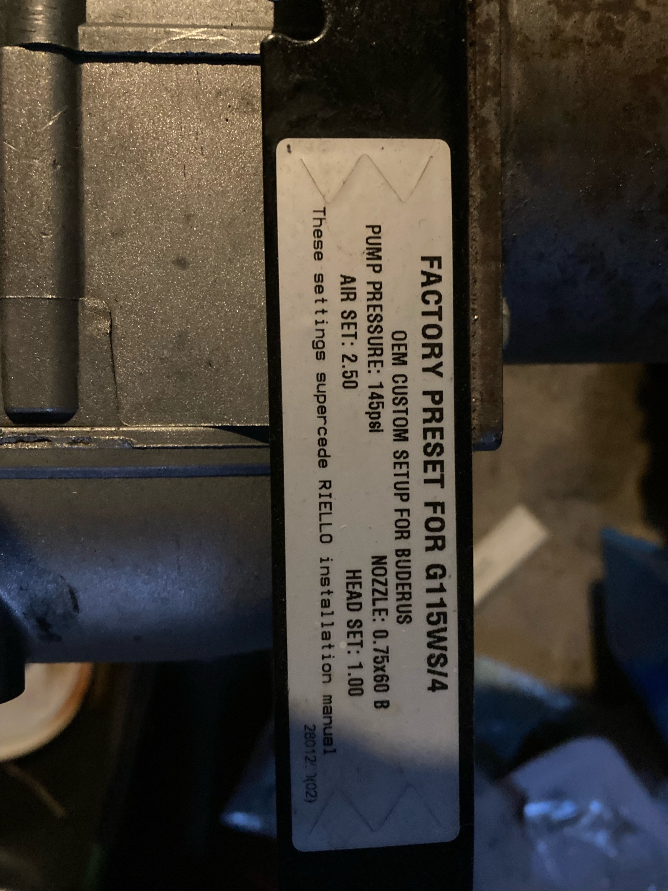

    replaced the pump oem from riello without adjusting pressure riello said they are shipped @ 145-150psi which is what my boiler calls for . It is a buderus g115 was installed 5 yrs ago.

    Any Riello OEM setup for the G115 shows pump pressure anywhere from 160 to 205 psi depending on size, so IDK where you got 145-150 psi from. This is not DIY. Where are you located?

  • Richard_d
    Richard_d Member Posts: 10
    HVACNUT Member Posts: 7,425
    Pretty close to Riello retrofit specs.
    Do you have Riello pressure and vacuum gauges? Is there atomization in the chamber? Have you looked down the air tube? Giant coke ball sitting in there?
