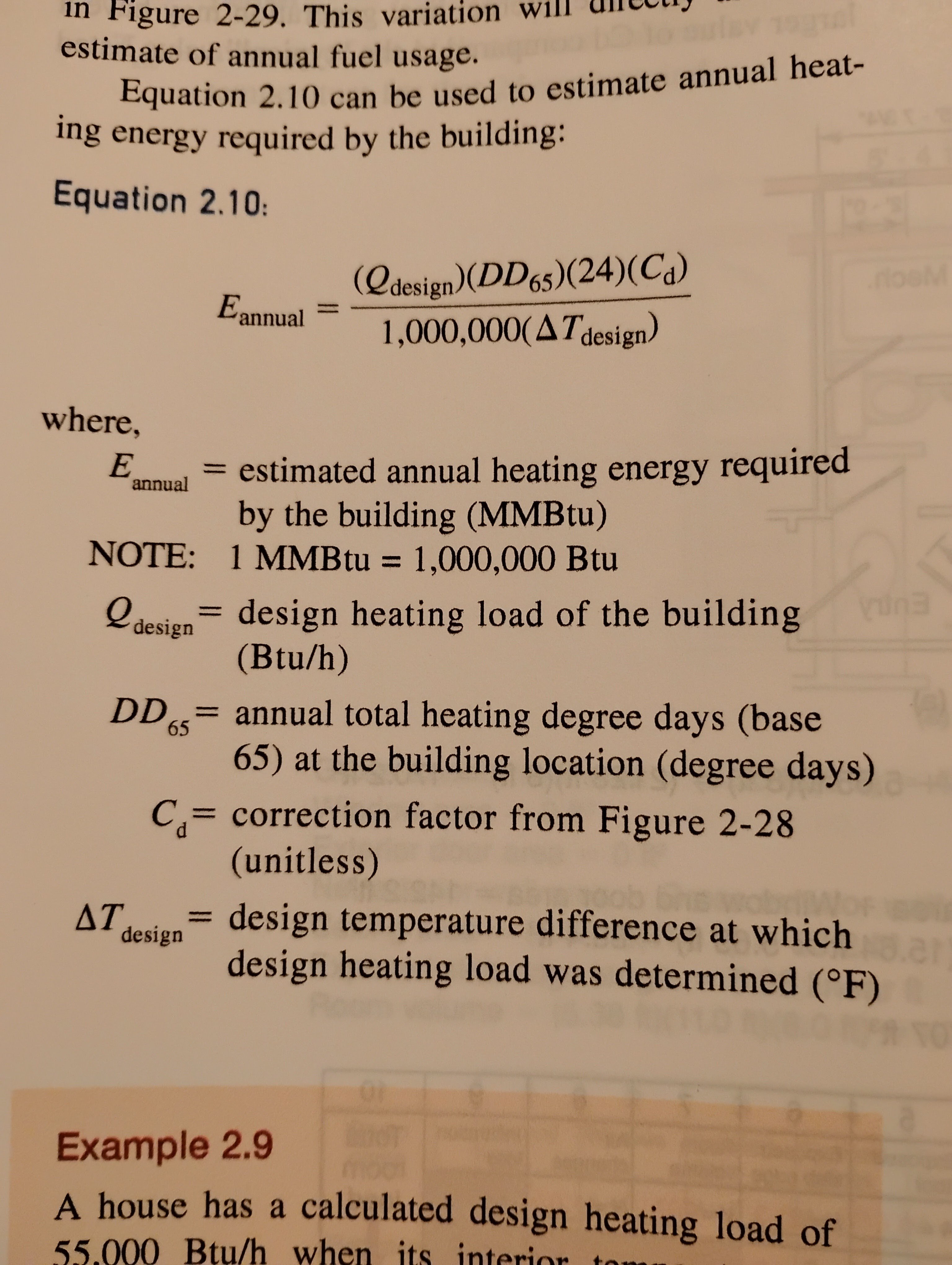

This is the equation Siegenthaler gives for using Cd:

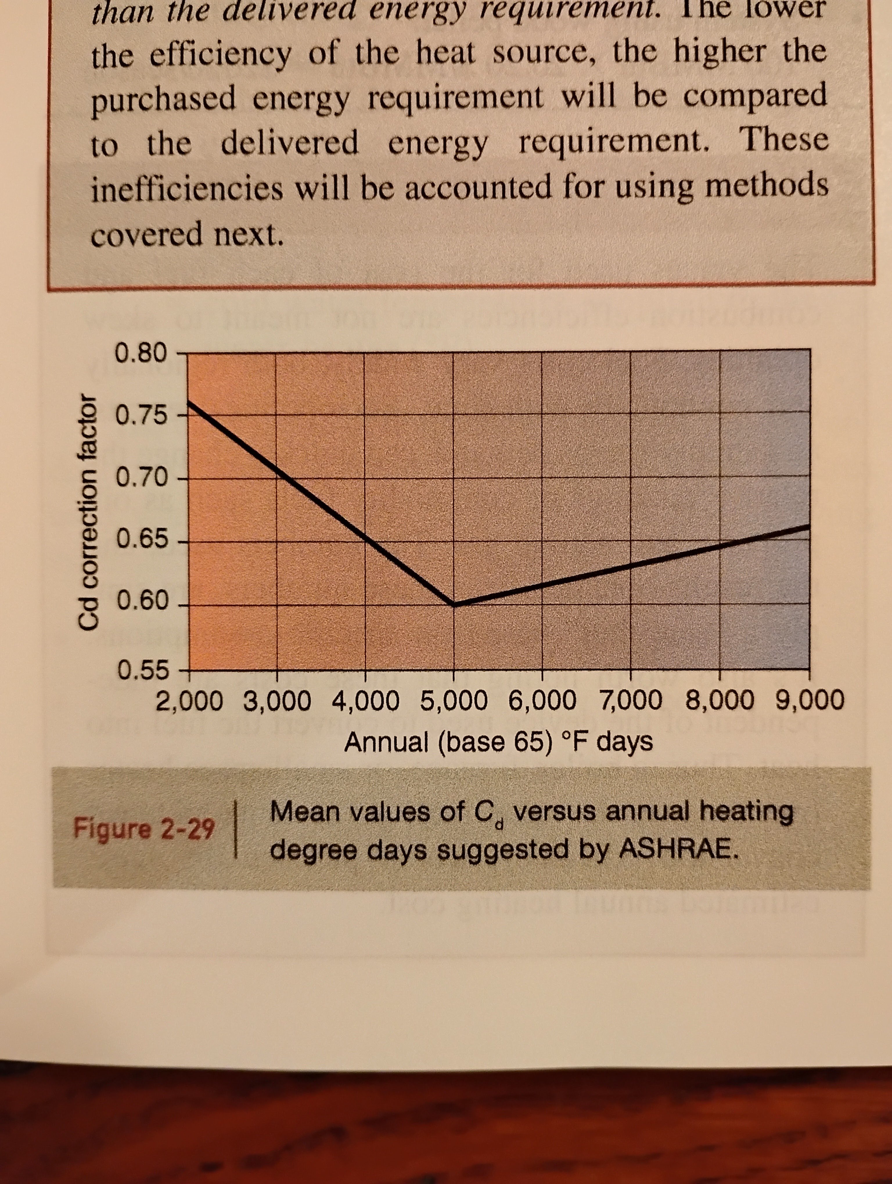

And this is the chart showing the range of Cd values based on local annual HDD's. In my case, Boston has 5,630 HDD's, so I used the corresponding Cd value of 0.61 taken from the chart:
Our building has a known heating load of 100,000 BTU/hr at zero degrees outside temperature. Using 5,630 HDD's for Boston, a corresponding Cd of 0.61, and a delta T of 68 degrees, I get a predicted annual energy use of 121 million BTU's for our building.
In fact, we burn an average of 1200 gallons of oil per year for heating (DHW is from a separate gas fired water heater). Assuming 138,000 BTU/gal gives a BTU total of 166 million BTU's per year. However, that's assuming 100% efficiency. In reality, our overall system efficiency is probably around 65%-70% (cast iron non-condensing boilers). So in reality, the number of BTU's we extract in useful heat is around 108-116 million BTU's per year, vs. the 121 million BTU's predicted using Cd. That's a difference of only 4% to 11%, which is surprisingly good agreement.
Siegenthaler cautions that the actual Cd for a given building can vary quite significantly depending on design, insulation, solar gain, etc. But for an "average" building (ours is a 1924 masonry and wood framed house built in the Boston area with conventional double hung windows and average solar gain) our results show that you can get a very good prediction of annual energy use for heating using the above method.

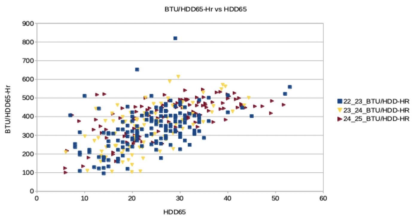

    My house definitely has lower HDD-normalized heat loss at warmer temperatures:
    It's interesting that their correction factor is V-shaped vs total HDD, but I could imagine trying to back out a similar kind of correction factor for my location based on hourly temperature bin data.

    @fentonc what's the heating system? You've isolated the heat vs. all the other energy usage? I have the DHW and dryer that are skewing my low temp data, so the slope of my line is actually negative for BTUs/HDD.
  • fentonc
    fentonc Member Posts: 341
    @Hot_water_fan - CI boiler with 3-zone fin tube. I believe those numbers are just computed from daily boiler gas usage vs HDD65 as tracked by an outdoor thermostat. You're right that I have a HPWH next to the boiler, so the load from that is going up as the incoming water temperature drops throughout the season, which might skew things (I also don't have the basement zone turned on during the shoulder seasons.
