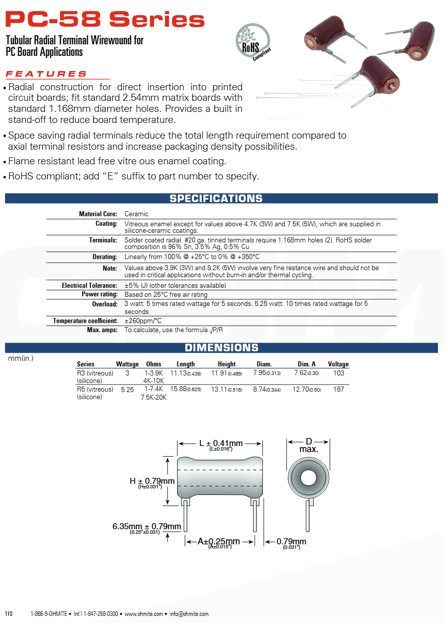

    The wire connections to the power resistor leads are probably crimped, probably just an un-insulated butt splice slid over both wires and crimped. Solder fails easily over time with constant exposure to heat, especially since the intent is to keep the heat in the area.
    Looks to me like the metal that the micro-switch is mounted to is the 'calibration' adjustment by bending it. You may have to have a preload on the micro-switch's actuator level to get the change of state into the 'sweet zone'.
    https://www.mouser.com/datasheet/3/132/1/res_pc58.pdf
