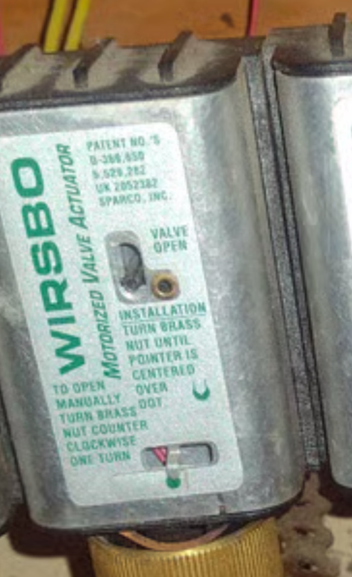

    hot_rod Member Posts: 26,546
    with power off you screw the brass ring until the dot lines up with the arrow
    when powered up, thermostat calling, indicator goes to “valve open” position
    Instructions are printed on cover
    The one on the tight is certainly done
    Uponor has an upgrade actuator and adapter
