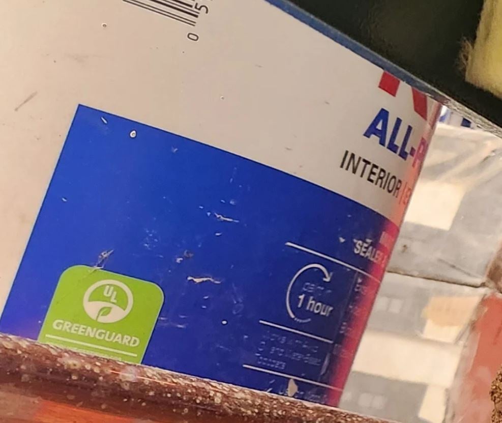

    I'm a little more concerned about what's in the can next to your open flame
    mattmia2 Member Posts: 16,016
    and the plywood
  • bigjoe1980
    bigjoe1980 Member Posts: 19
    Yes the guy actually put some plywood around the boiler. I let him go. Needed to be careful. You get what you pay for is true 99% of the time.
