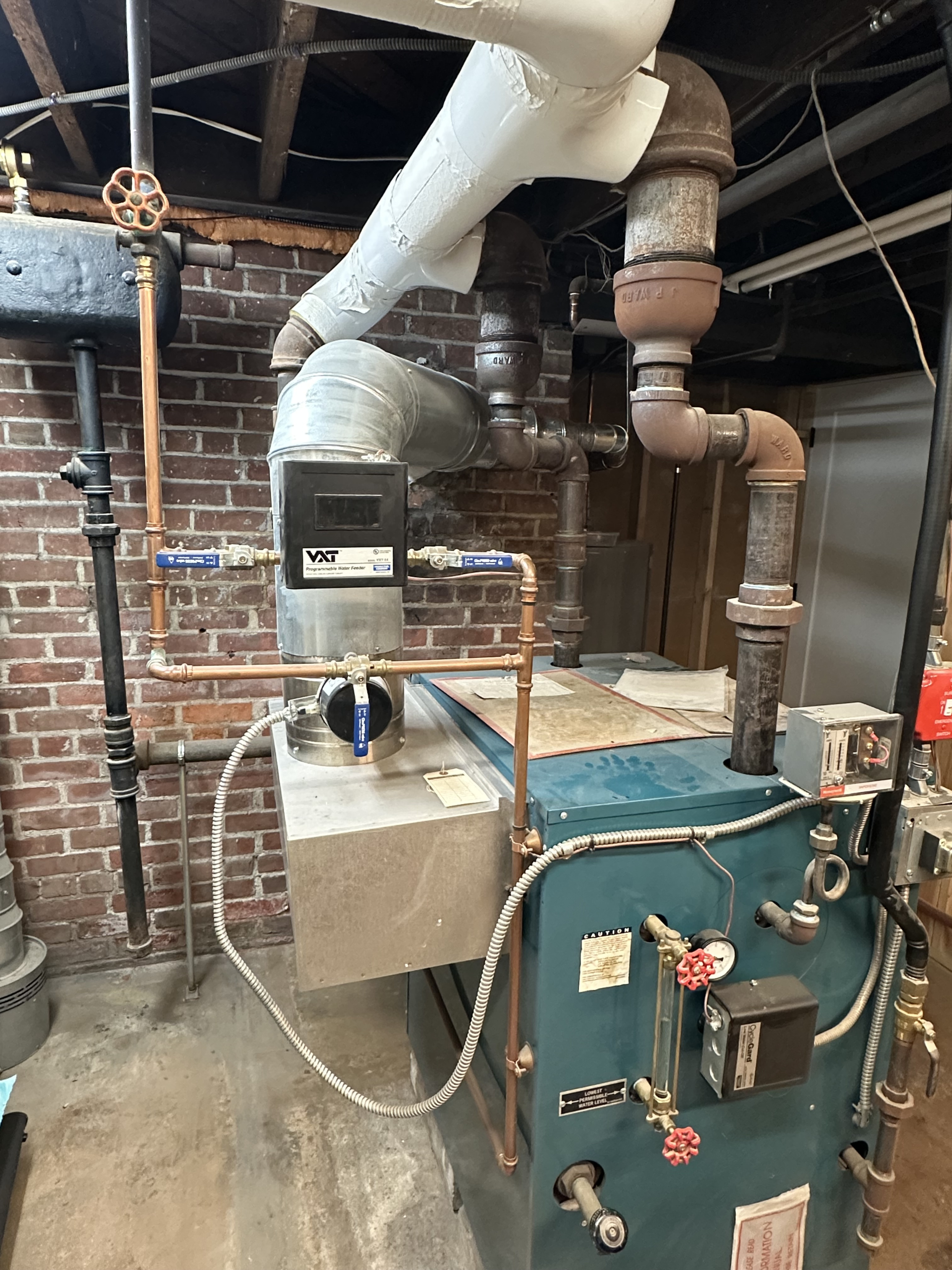

I have a SteamMax 125 steam boiler. Boiler fires and makes steam, and the boiler risers/header get hot, but the steam main downstream does not fully heat and the main vent (Big Mouth) never closes. I just added the big mouth last week but didn't seem to help at all.
Some radiators heat (often partially), others lag or stall. Pressure is low (vaporstat).

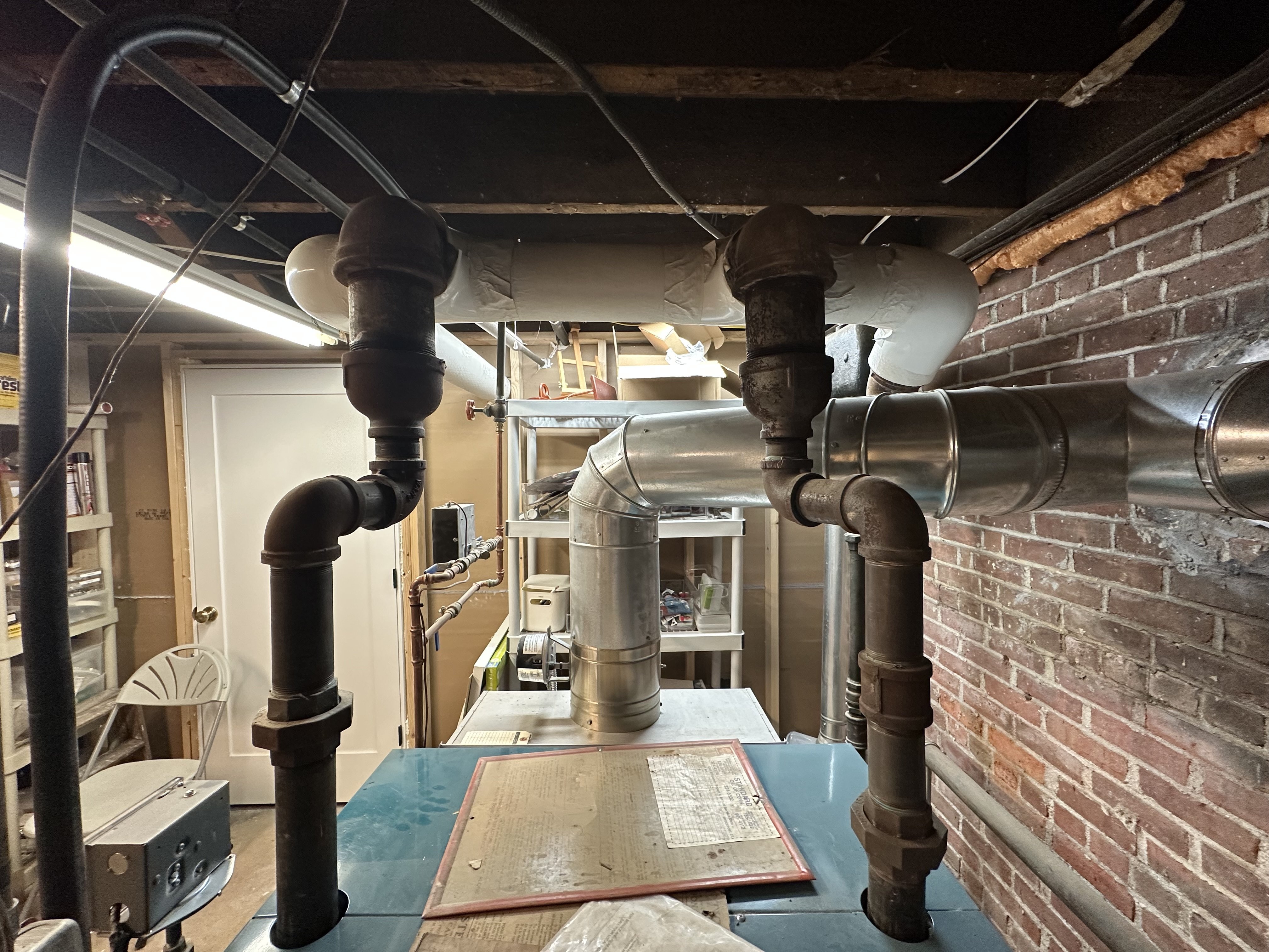

Near-boiler piping appears marginal:
  • Short risers (~18–19″ to first turn)
  • Early 90s into the header
  • Suspect wet steam / poor separation before the main
System worked in past years but has become unstable. I’m not looking to swap vents or raise pressure.
Looking for a steam-experienced pro to evaluate and likely correct near-boiler piping (possibly a drop header) and advise on return cleaning/skimming as needed.
If you’re a steam specialist In or Near Fairfield, CT, or can recommend one, I’d appreciate it.

    can you show us a picture of the near boiler piping? if it worked before it probably isn't the near boiler piping but the arrangement is more important than the lengths.

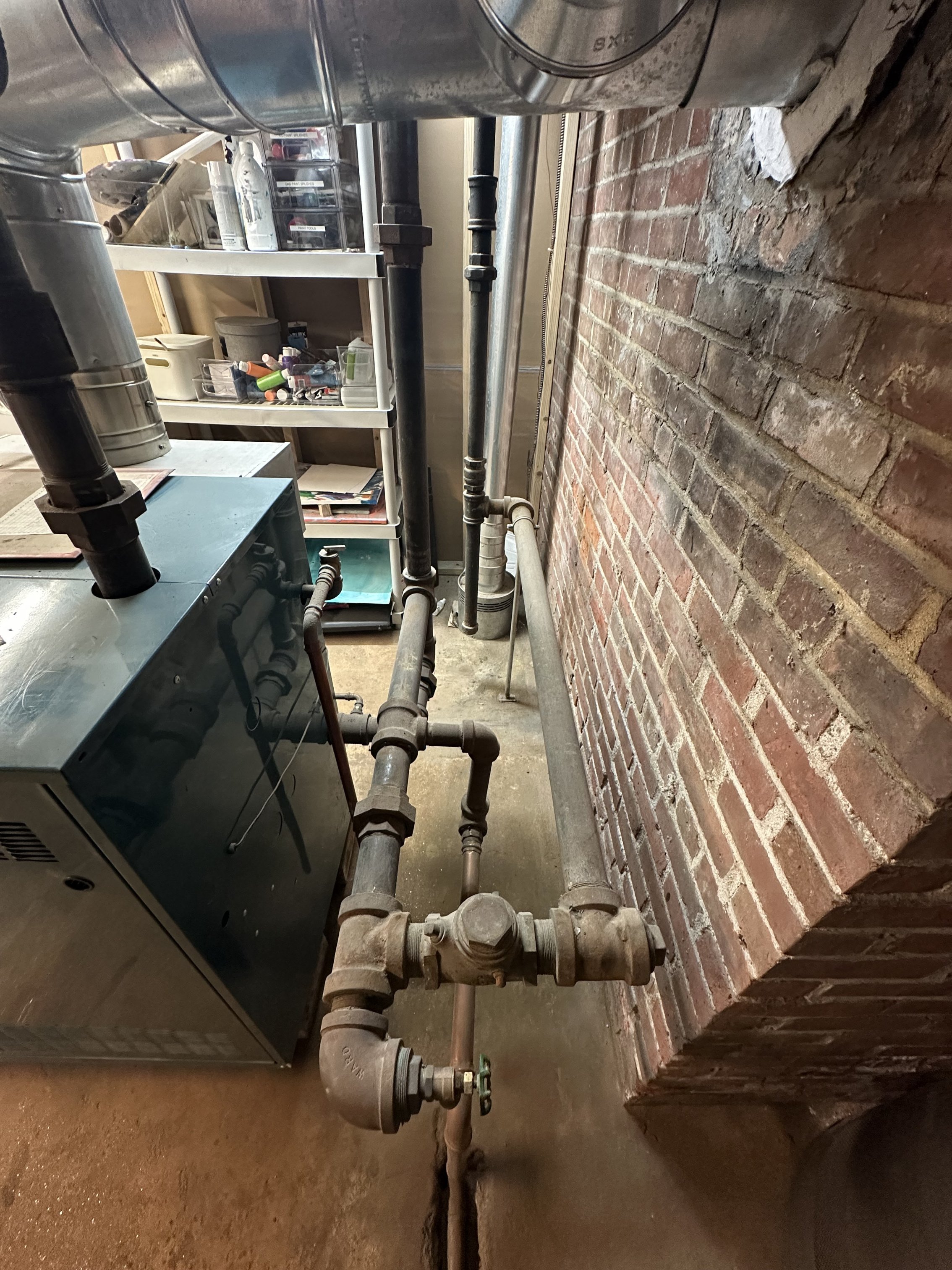

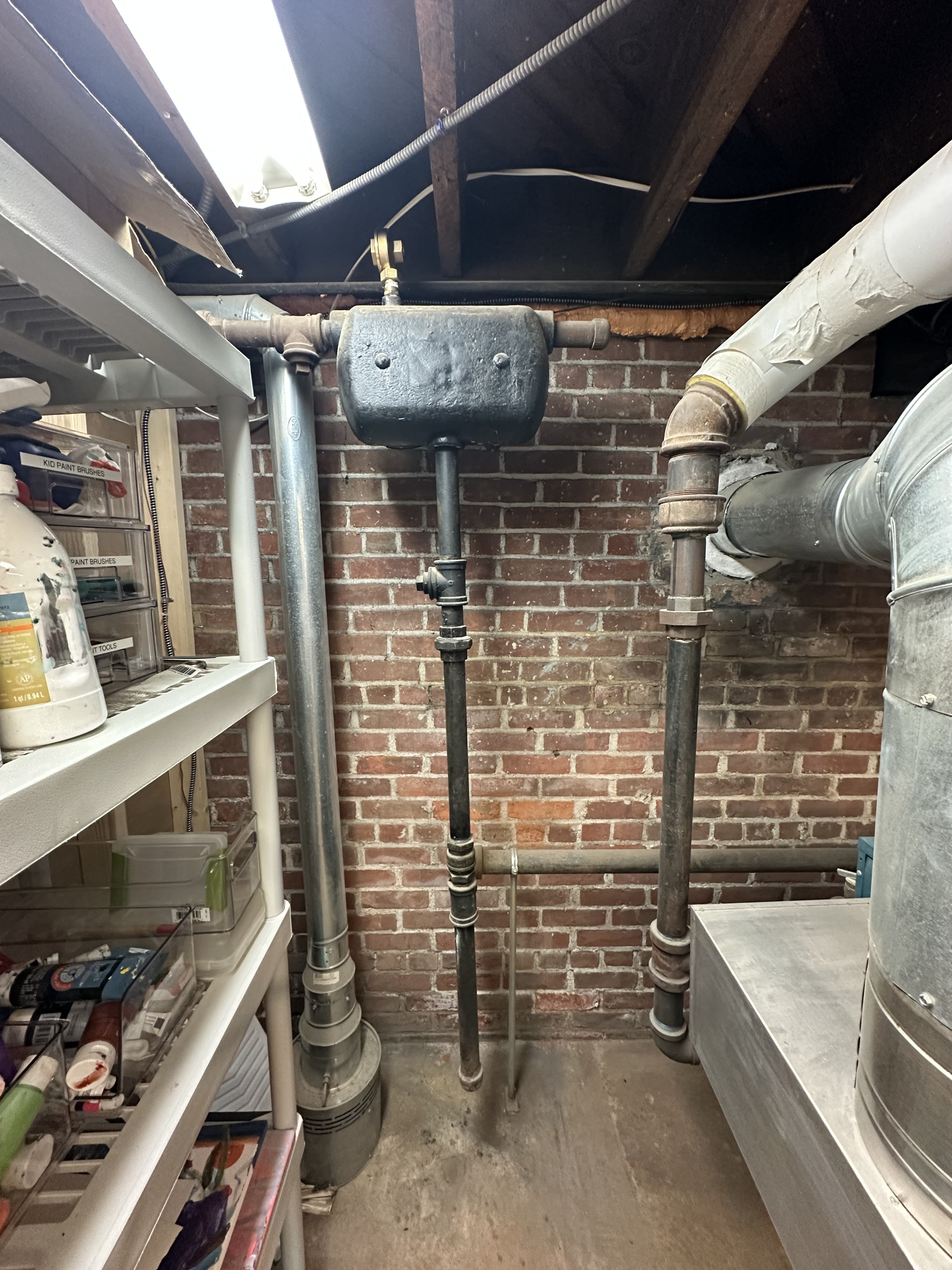

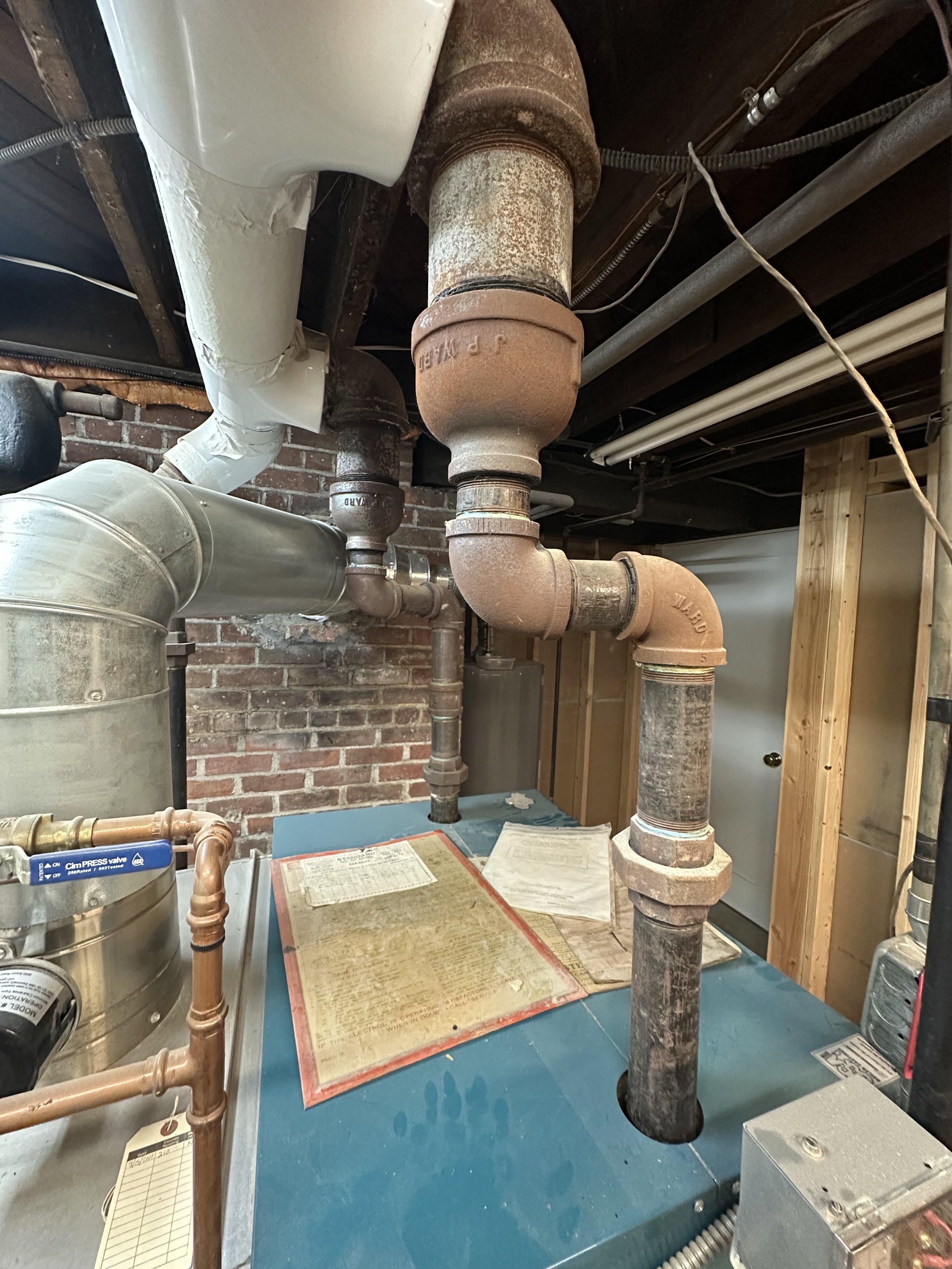

    i added a big mouth but the steam never reaches it to close it.

    the header is wrong, the order should be the risers from the boiler, the risers to the steam mains, then the equalizer. you have the risers from the boiler in between the equalizer and the connection to the mains.
    i assume this is 2 pipe. it looks like it is a vapor system. it should probably vent from the returns only with the mains venting in to the returns through crossover traps or something similar.

    Appreciate that — agree the header geometry is suspect.
    Boiler risers are short and steam seems to collapse before filling the main.
    I’m primarily looking to correct the near-boiler piping (possibly a drop header) so the system can make dry steam again.

    Someone like @Mad Dog_2 or @New England SteamWorks would be the ones to figure it out. Tell them what is happening but don't tell them how to fix it. There is likely some knuckleheading that happened in numerous areas and though ideally the header should be fixed, it may not be the problem.

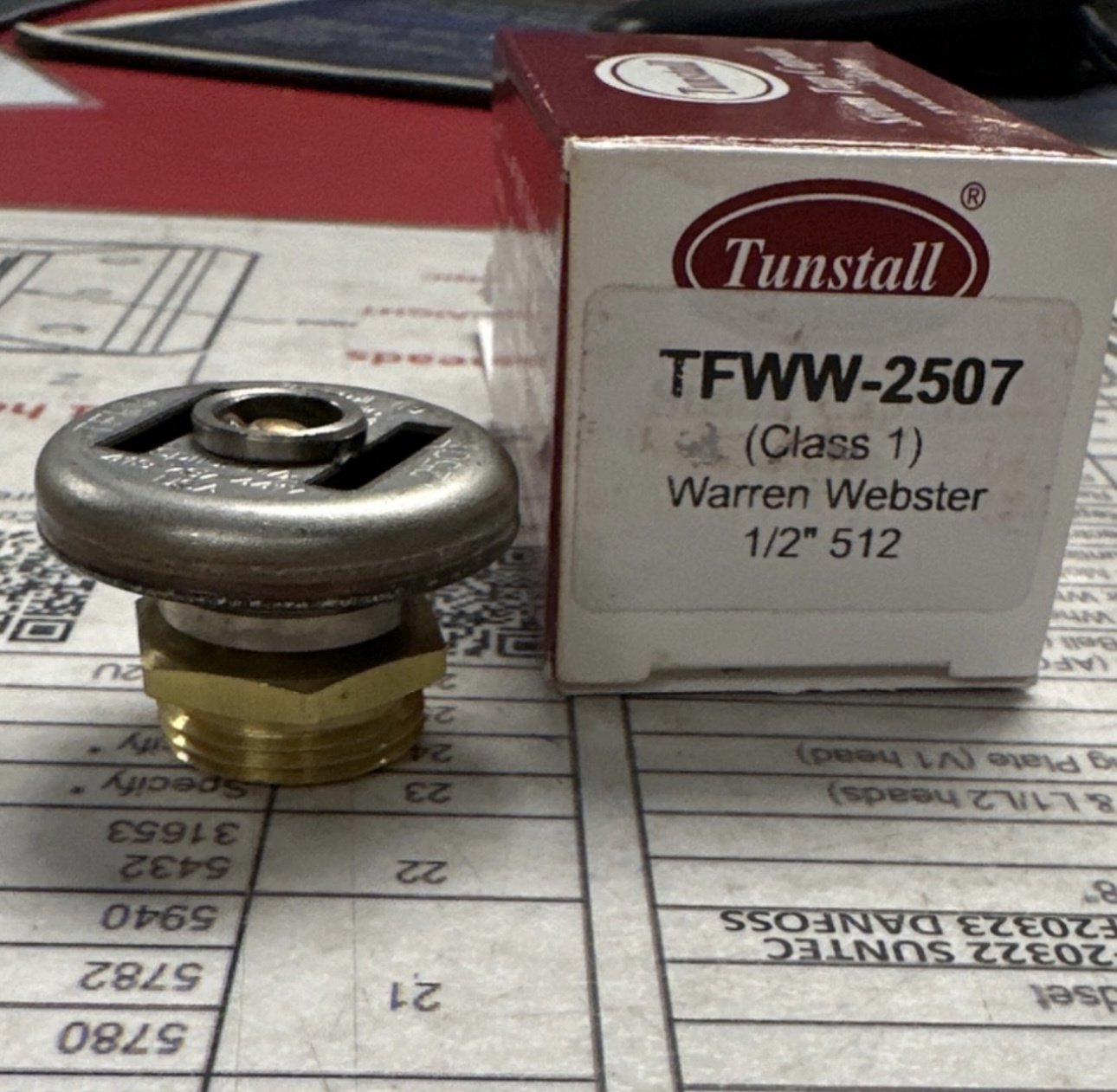

    yea two pipe system. But there are traps. I initially replace one with TFW-2507. Didn’t seem to fix the problem. ( only first 1/4 of the radiator heating up)

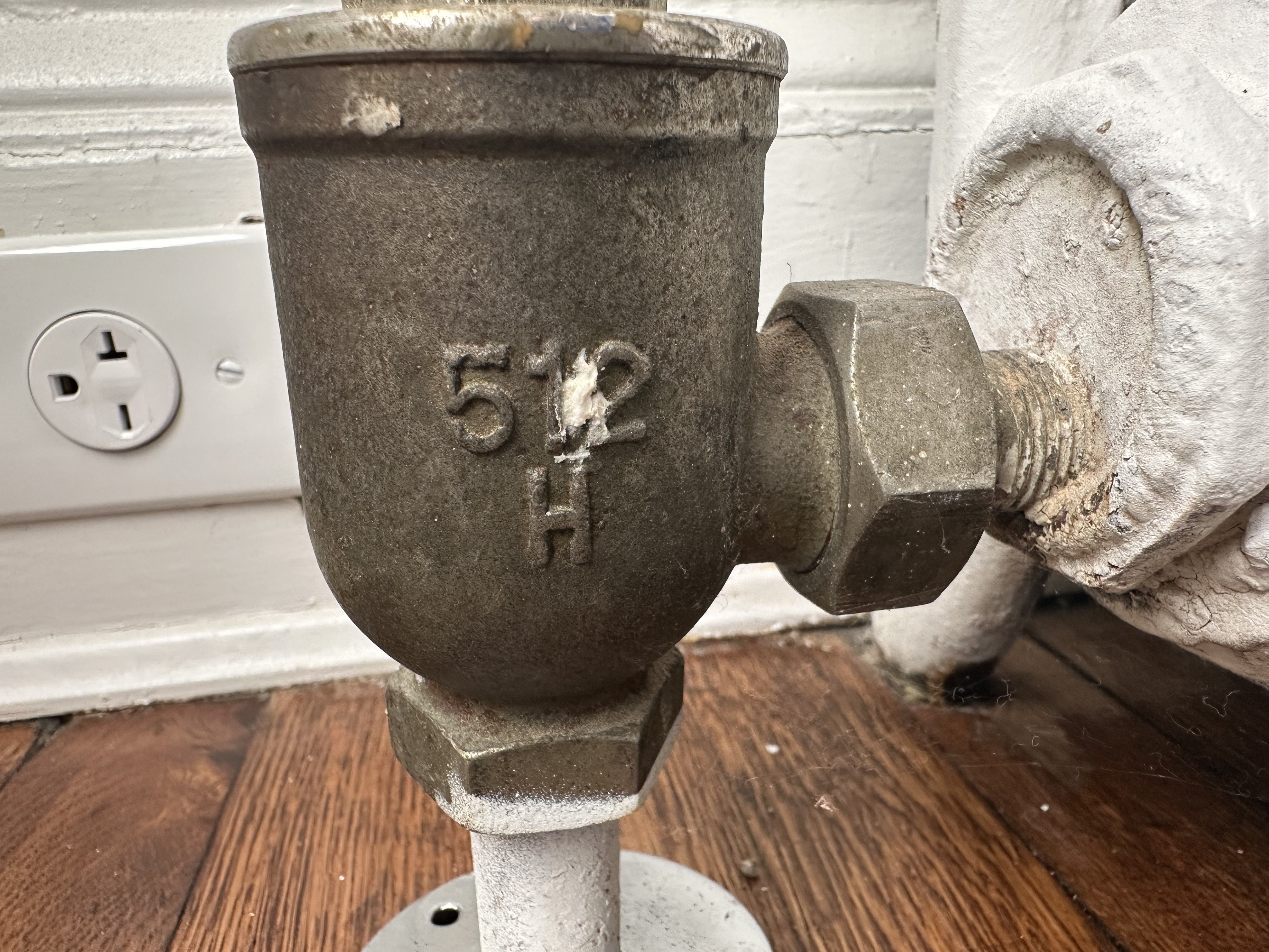

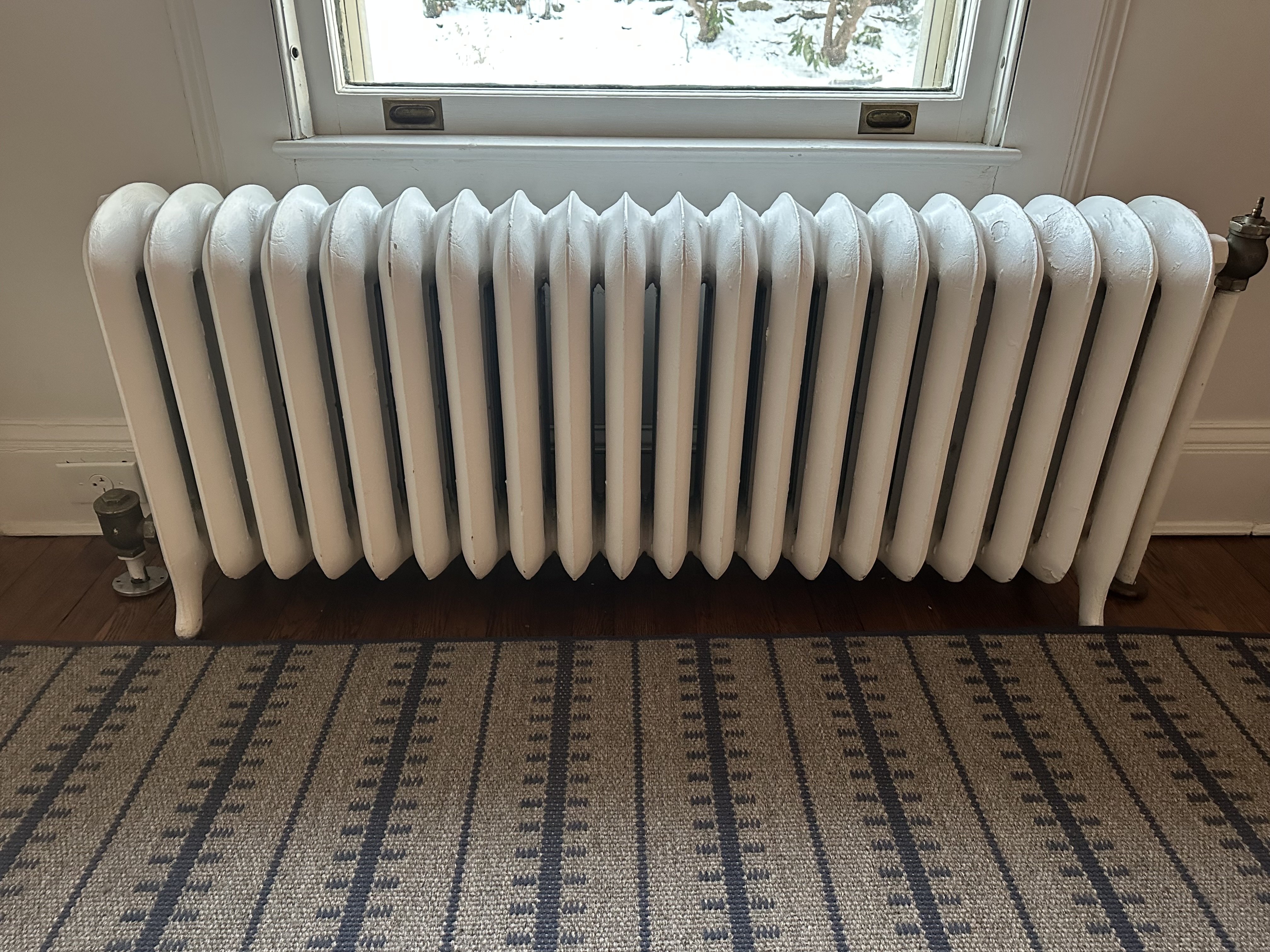

    New England Steam Works actually is the one who told me about this site/forum because I was too far outside his service area. It also sounds like Mad Dog is more of a consultant vs someone who actually does the work?? I could be wrong. But I’m looking for a steam competent plumber to remedy this. I called one company and $200 later, they said I needed to replace all the traps on the radiators that weren’t working.

    trap problems usually cause a radiator other than the one with the bad trap to not heat. the bad trap lets steam in to the returns and that steam in the return keeps a different radiator from being able to vent and heat.

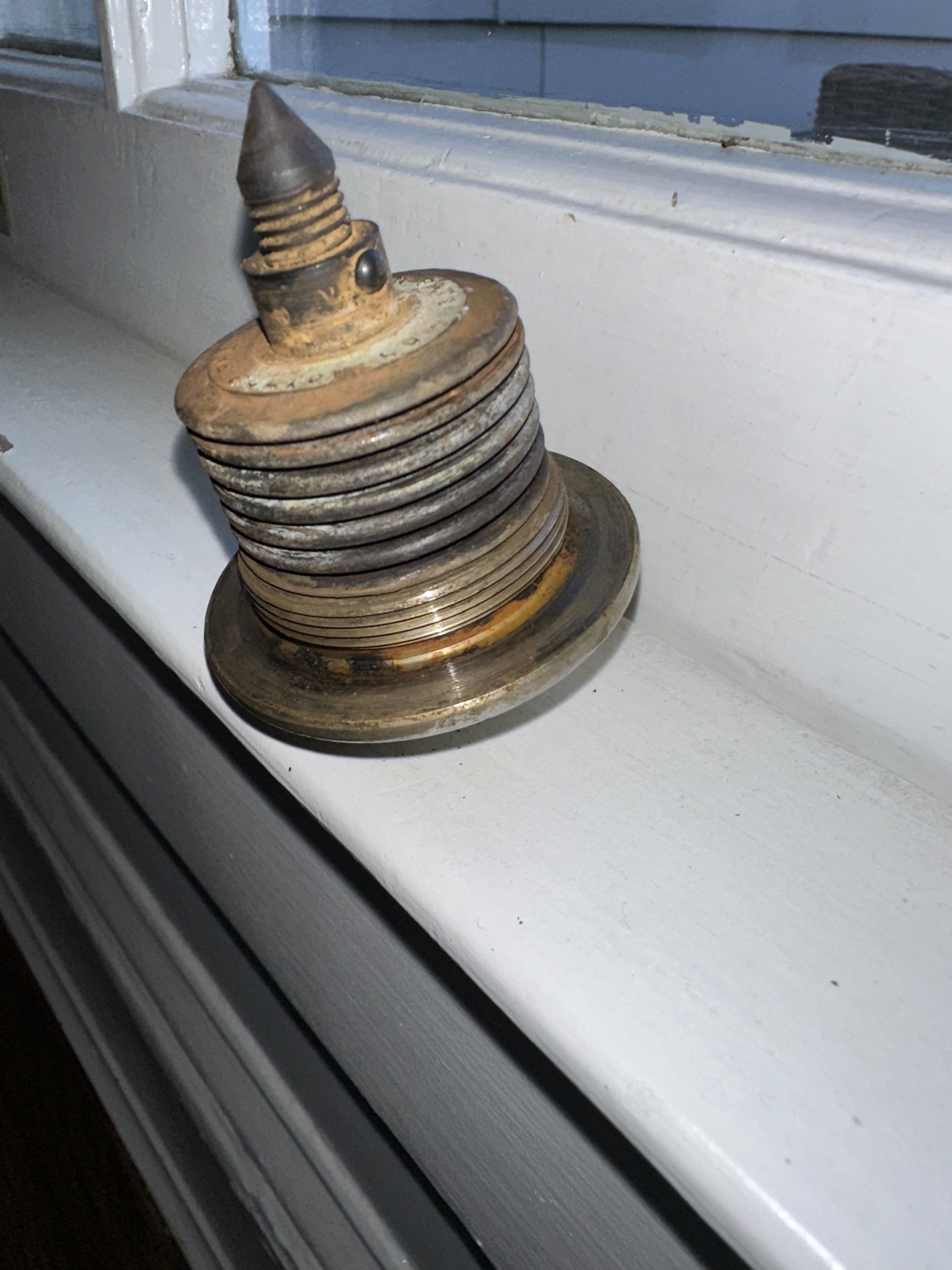

    the black rectangular box thing I think is an air vent for one of the vapor systems, it possibly is stopping steam from venting out before it gets to the vent, but if the system is working properly there should never be steam in the returns in the first place so vents on the returns should never close.
    I'll let @Mad Dog_2 say what he does or doesn't do. I think some of the new york companies also work in CT. If the traps are ancient most pros would just replace them rather than going looing for a bad one if they know one or more are bad and traps capsules are not inexpensive. if it is still equipped with the vapor valves on the radiators and you keep the pressure very low, around 8 oz/in^2, it should function without the traps.

    Here is the webster catalog. I think that device is the vent trap on page 17:
    there is another version out there that isn't from during wwii that doesn't have iron and steel substituted for brass.

    @CooperFamily Call @Mad Dog_2 or PM him he does some travelling. Based on past experience in Fairfield County steam people are in short supply.
    Proof that Fairfield is short on steam people is that you have a boiler that is piped wrong, all wrong.
    That is or was a vapor system and a really old one at that looking at those old fittings.
    I also might question the height of the boiler return behind the boiler it could be too high and cause hammering.
    mattmia2 Member Posts: 16,686
    that check valve above or at the water line is going to do weird things. it originally was there (with a boiler with a much higher water line) to work with the webster boiler return trap to equalize the pressure in the boiler and the return to allow the water to return to the boiler.
