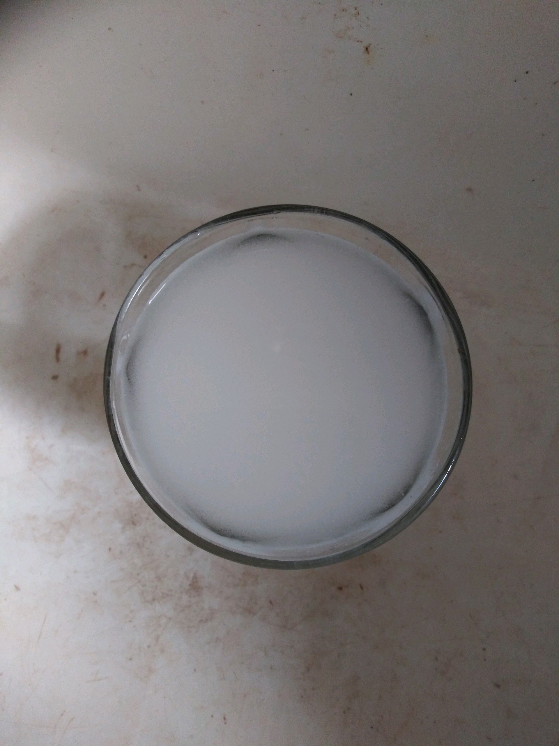

Hi,
I had a bad water leak so got a NEW Rheem 29gal gas water heater installed in a mobile home
. Everything went fine, but I noticed that more so in the bathrooms, the HOT water has merky water (might be bubbles) but it isn't going away. Before the install there wasn't an issue like this. I have a picture posted. I don't know where it is coming from. I took off the Is the Female Water Saver Faucet Aerator and it still had the same color of water. Can anyone tell me where this is coming from?
    hot_rod Member Posts: 26,527
    Some times the anode rod inside the tank has a reaction with your water and creates some gasses. Give it a few days and see if it clears up. Or it may need a different anode rod, @Larry Weingarten is the pro in this area.

    Even though it is a brand new heater installed two days ago? It is the exact same model as the one replaced as well. The cold water doesn't do it.

    If you let the glass of water sit for 2hrs does it clear up? Do the microbubbles dissipate out?
    What temp is this water heater set to? What temp was the previous?
    techiegirl
    mattmia2 Member Posts: 15,433
    the old anode was probably completely dissolved if the tank leaked.
    is it just dissolved gas, does it dissipate from the glass if you wait a few minutes to half an hour?

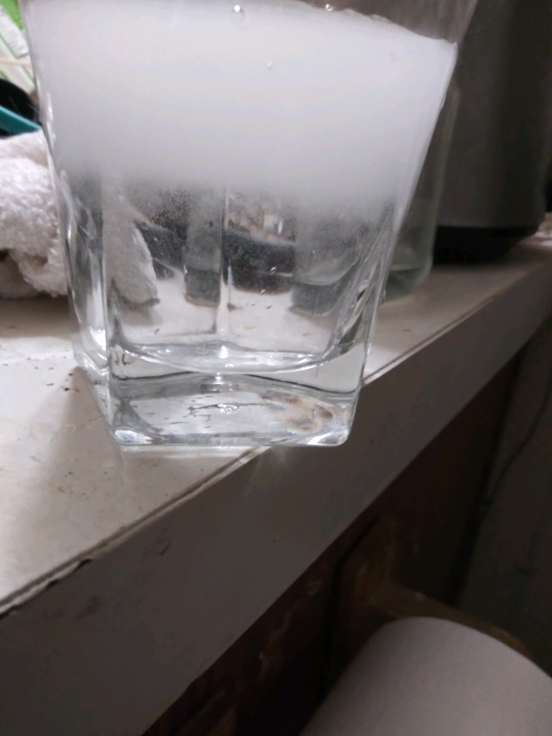

    Hi, Do you get the same murky water from all of the hot taps? Also, do you get more of this on first use in the morning, or is it consistent all day? If it were gas in the water, it would usually clear in a few minutes. Do you know if you have "hard" water? If so he water is more conductive and will make the anode work harder, producing more gas. Another question, is there an instant hot water line? Sometimes if there is one connected at the drain, sediment can be pulled backwards through it. This should be figure-out-able. 😎
    Yours, Larry
    ps. A photo of the side of the glass will show if water at the bottom is clearing.

    here is a picture. My concern is why every other Rheem water heater never did this after install. It is just from the two bathrooms, hot water. the kitchen hot water is fine. cold water clear from all taps.

    These are just air bubbles as you have figured out. Nothing to worry about. If there is a slightlet bigger pocket in the tank, it will eventually work it's way out. Opening th t&p at this point will not help. Maybe just air in lines to those bathrooms.
    This new water heater may be set hotter than your last one, which can make the dissolved gases come out easier. As the water is heated, the dissolved gases come out. If heated to higher temp, more of the gases come out. Therefore, You don't see it in the cold water.
    I would personally try to set the temp to lowest you can (down to 120minimum) but still not run out of hot water.

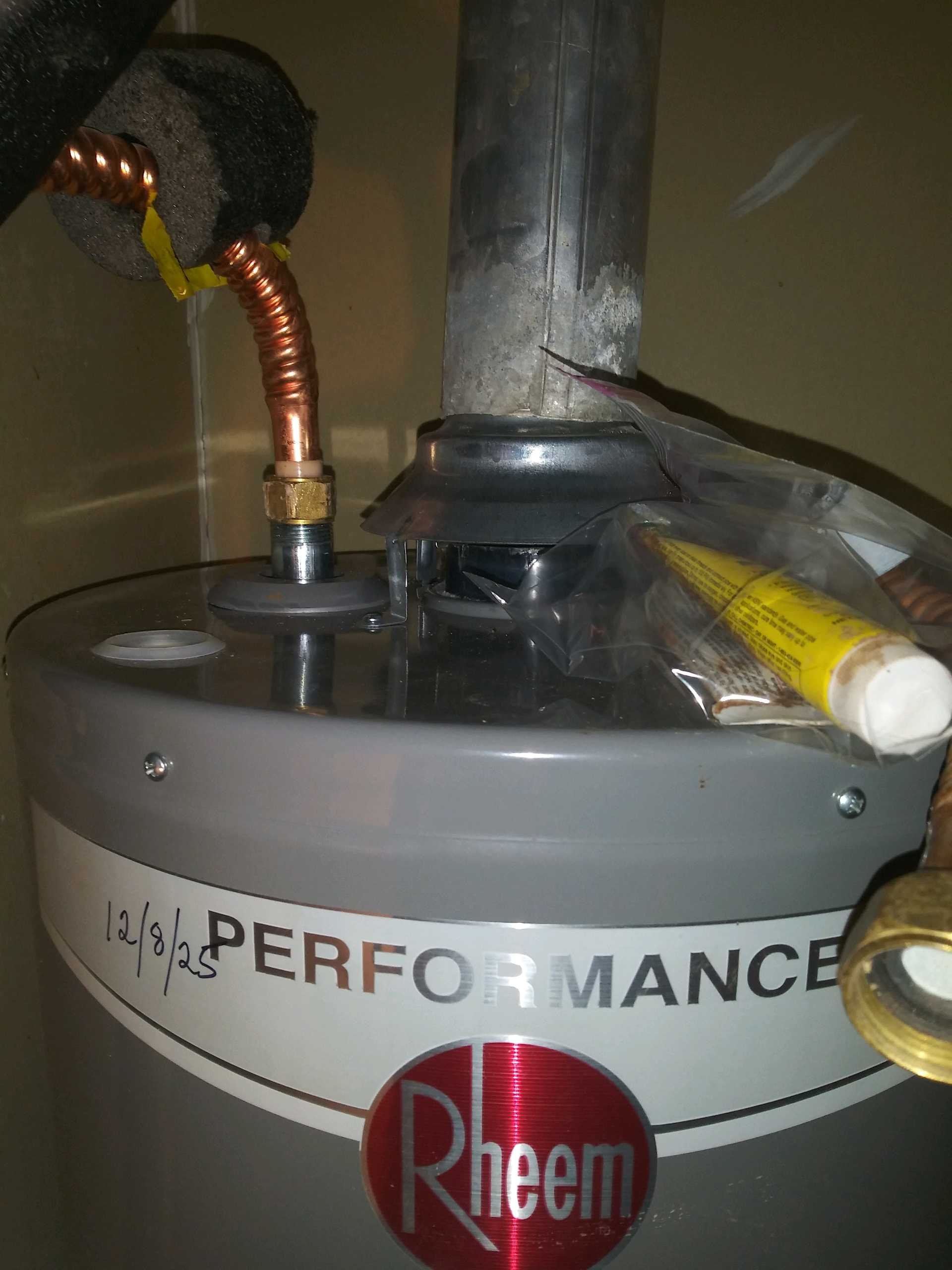

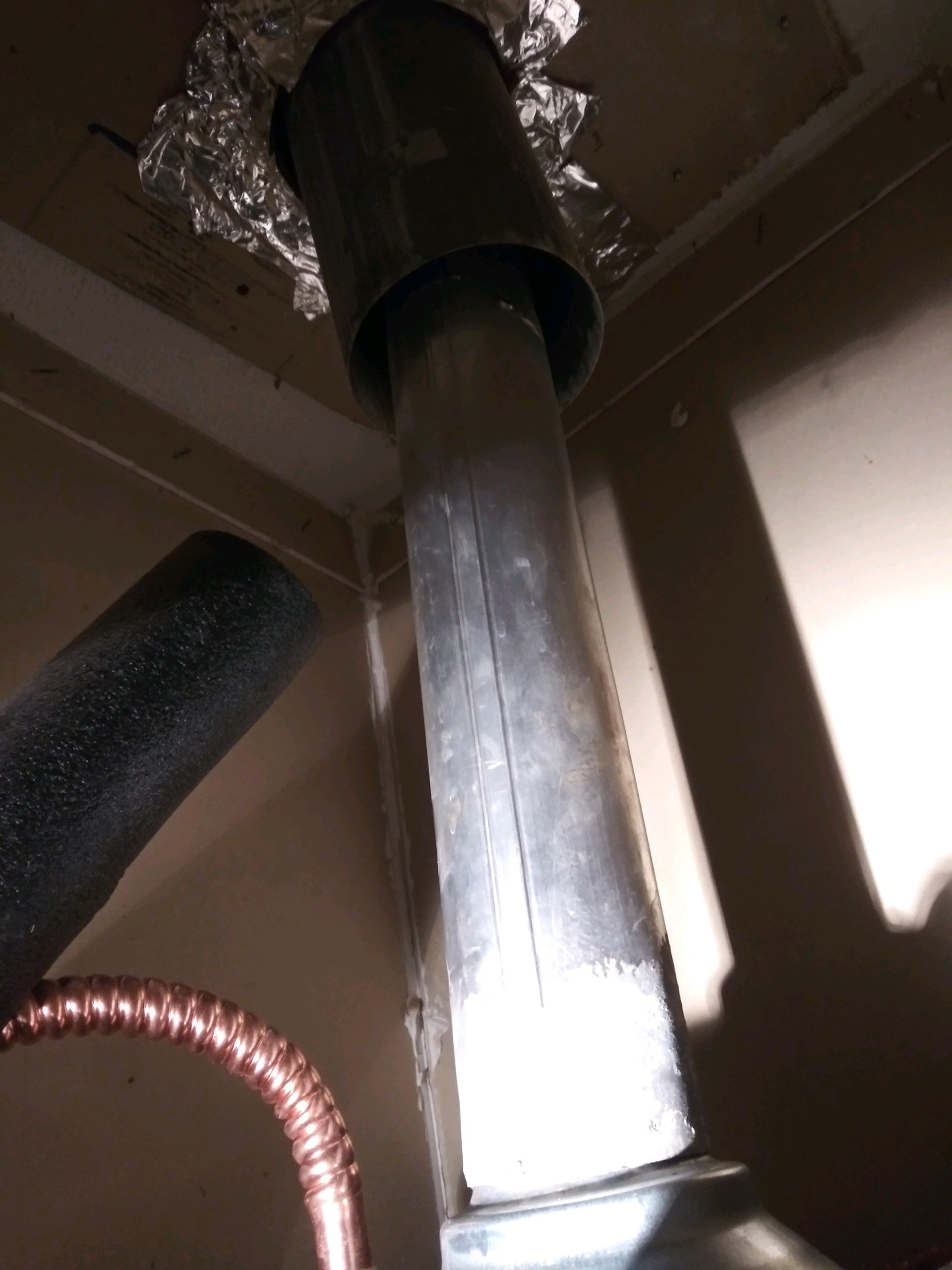

    I think what I have is like the air vent see pic as well as air under tank (a hole with screen to underbelly of mobile home)
    our Rheem XG29T06MH3201 water heater uses a Magnesium anode rod for tank protection, typically around 44 inches long with a 3/4" NPT thread, but you should replace it periodically (every few years) with a compatible magnesium rod for best results, like Rheem part #AP11524C or similar flexible/solid version
  • Larry Weingarten
    Larry Weingarten Member Posts: 3,999
    Hi, I think we're talking about different sorts of venting. Your picture shows the vent pipe for removing combustion gasses. I'm talking about a float vent that removes air or gas from the water. Gas can accumulate at the top of the tank, so with a trap in the hot pipe, this sort of vent can work automatically to get rid of the gas. 😊
    Yours, Larry
