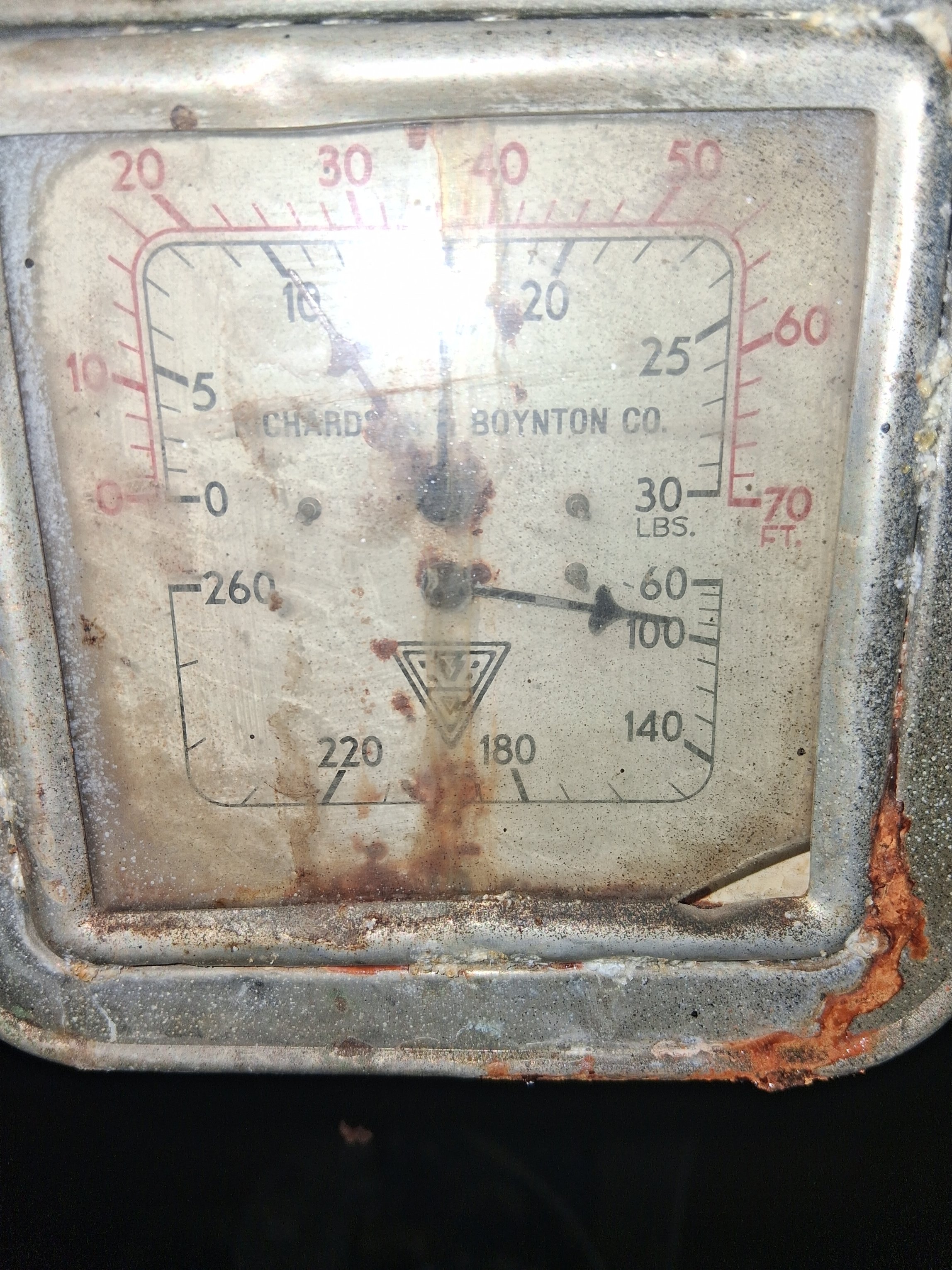

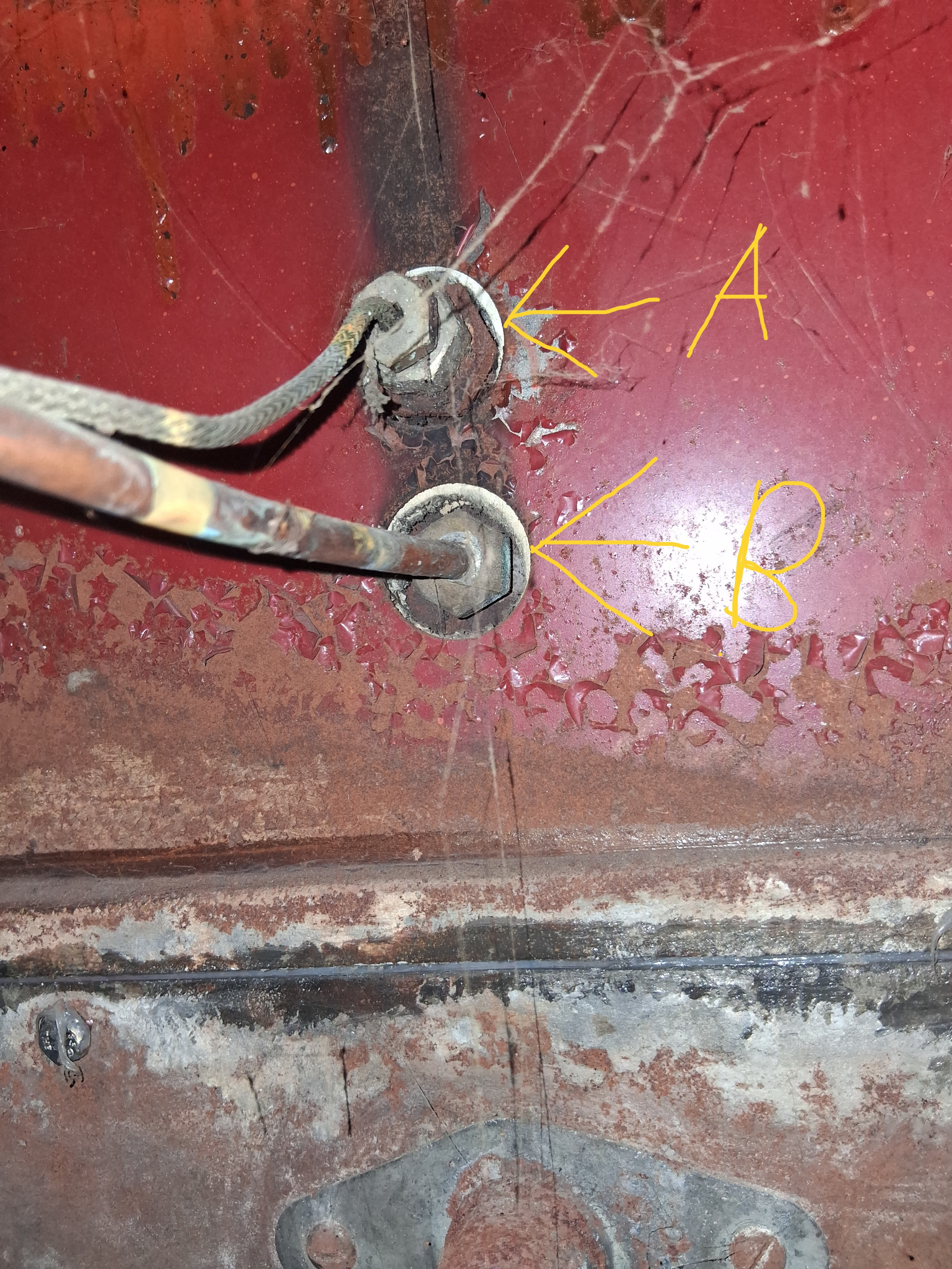

Is there well used for a temp and pressure gauge? I cant see a well being use because how would the gauge read water pressure? The reason I ask is because the gauge I ordered states for a 1 and 9/16 well. In the picture A goes to the LBS. FT. and b goes the the temp part of the gauge. Not even sure what one I should put the new gauge in.
Your old indicator has two wells. The new one you are looking at uses one, common well —like most modern temp./press. gauges. You'll need someone who knows fittings to perhaps put two different indicators in other places or find an appropriate place for a 1-9/16" well.
