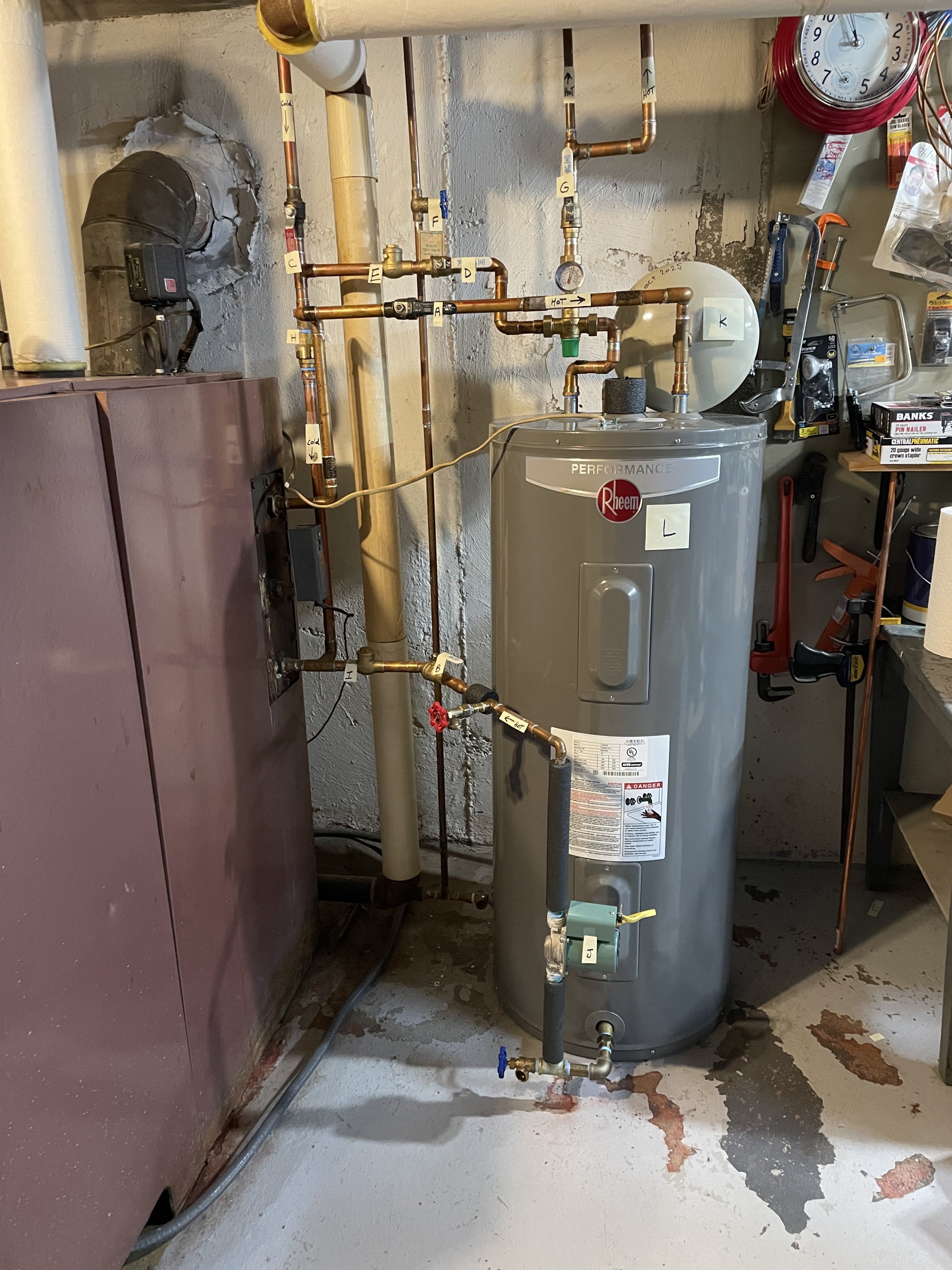

    maybe this is a controversial issue. But nine opinions out of 10 say that the pressure tank(K) should not be laying on its side on top of the water heater.
    The same nine out of 10 opinions say that the pressure tank(K) should be on the cold side of the system.
    A.  Ball valve
    B.  Ball valve
    C.  Ball valve
    D.  Ball valve
    E.  Swing check
    F.  Hot boiler fill valve
    G.  Ball valve
    H.  Spring check valve
    I.    Swing check
    J.   Taco pump
    K.   THERM-X-TROL ST-12
             Expansion tank
    L. Rheem modified holding tank
    so, given the fact that this holding tank((L) has never had a pressure tank(K) on it before. Why would installing it on the cold feed) ( C ) cause such a dramatic situation that you described??

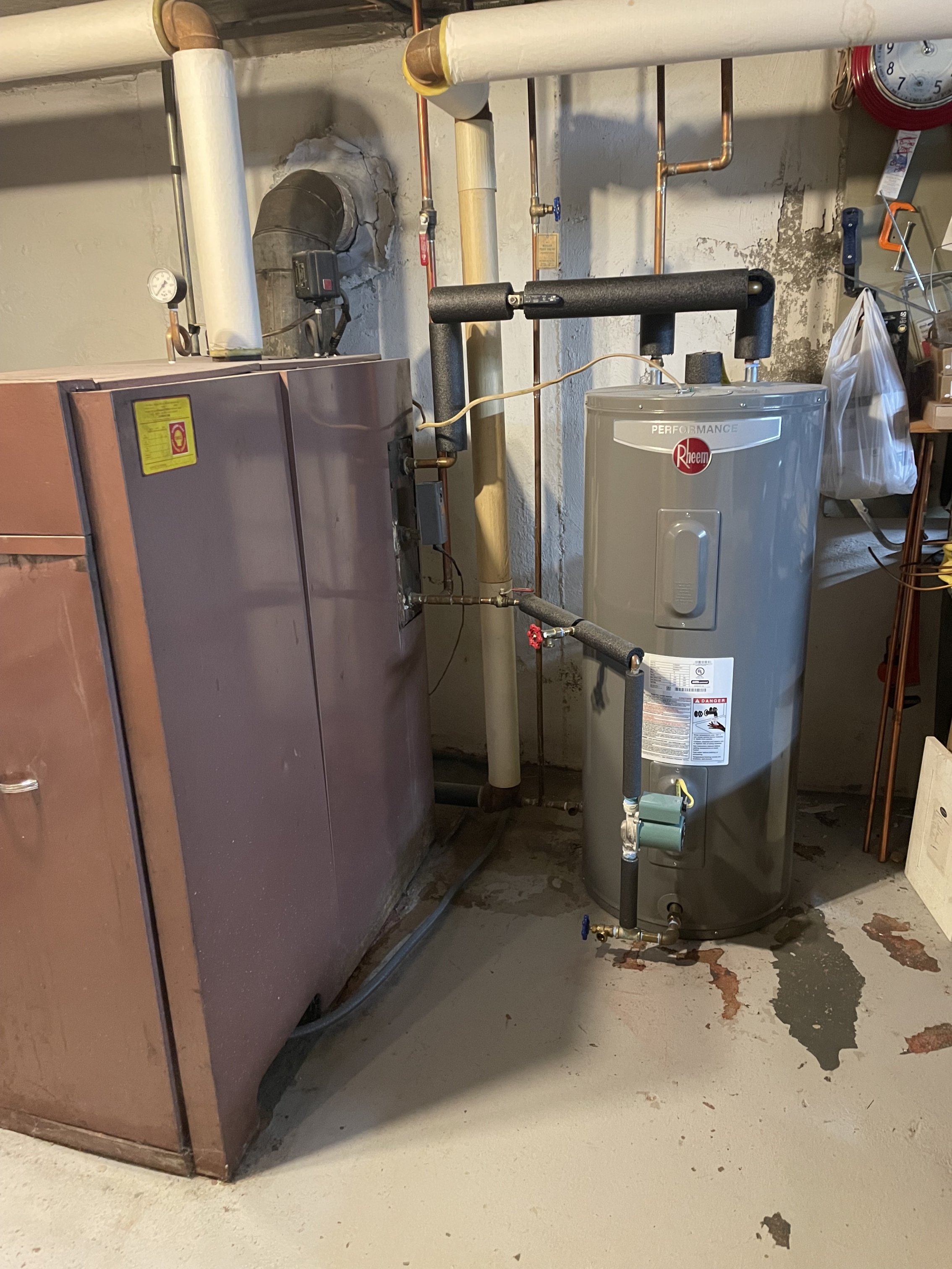

    old Photo of my system before any work by the plumber was done

    If E and H are check valves and the expansion tank is placed at C… How is the expansion tank going to mitigate the expansion of heating the water ??? The expanding water can't get back to the expansion tank through the check valves.
    Previously the expanding water simply went back to the street.

    so, looking at the labeled photo.
    what should I do

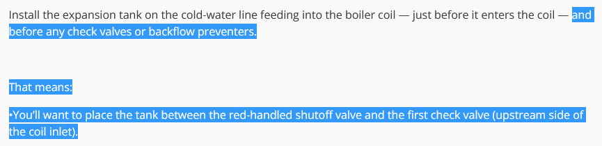

    I uploaded the photo with the labels to AI.  (artificial intelligence.)
    The AI analyzed the photo and the attached Legend.
    This is what it said after analyzing my system:
    Given that the cold supply from the street feeds only into the boiler coil loop, not into your domestic plumbing, here’s the correct reasoning and placement for your expansion tank (K):
    🔧 Correct Location for the Expansion Tank
    Install the expansion tank on the cold-water line feeding into the boiler coil — just before it enters the coil — and before any check valves or backflow preventers.
    That means:
    •You’ll want to place the tank between the red-handled shutoff valve and the first check valve (upstream side of the coil inlet).
    •Mount it vertically (bladder up).
    •This allows the tank to absorb pressure changes within that closed heating/coil circuit.
    ⚙️ Why That’s the Right Spot
    •The cold-water line feeding your boiler coil is a closed loop once the check valve closes. When the water in that loop expands (as it’s heated in the coil and stored in the Rheem tank), it has nowhere to go — which is exactly what causes the banging and pressure spikes.
    •Placing the expansion tank before the check valve and on the coil feed gives the expanding water a compressible space to move into.
    •Mounting it anywhere downstream (like near the mixing valve or tank outlet) won’t help because those check valves isolate that section from the source pressure.
     Summary
    Your expansion tank (K) should go:
    •On the cold supply pipe that feeds the boiler coil,
    Above the red-handled shutoff valve, and
    Before the spring check valve or backflow device on that line.
    That’s the “pressure reference” point for your entire heating/coil loop — and it will stop the water hammer you’re hearing at every cold fixture.
    73 year old one pipe system with original American standard boiler, oil fired becket, 2 inch steel pipe main, 100 feet long, with 8 radiators above.
  • steam-rookie
    steam-rookie Member Posts: 177
    so, that’s what I have been saying all along. It would seem that the artificial intelligence agrees with me that the pressure tank should be installed above the Red handled shut off valve( C) on the cold feed to the coil.
    I would like to hear what you guys think about that

    109A_5 Member Posts: 3,084
    edited November 1
    " I do not like where the tank was installed. I very much would like to put it on the cold supply. Just above the red handled shut off labeled ( C ) "
    And that may be fine, its just you should not have any check valves between the expansion tank and the part of the system that heats and/or stores heated water. So you would have to remove or disable at least (H) and maybe (E) also.
    I think your AI assessment missed this point. The highlighted part seems wrong to me

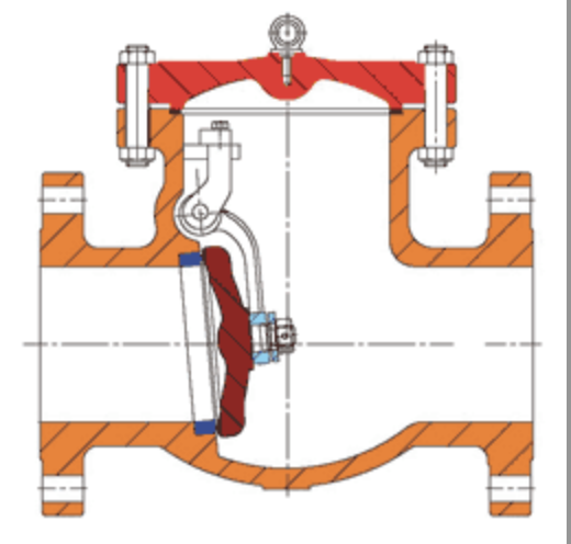

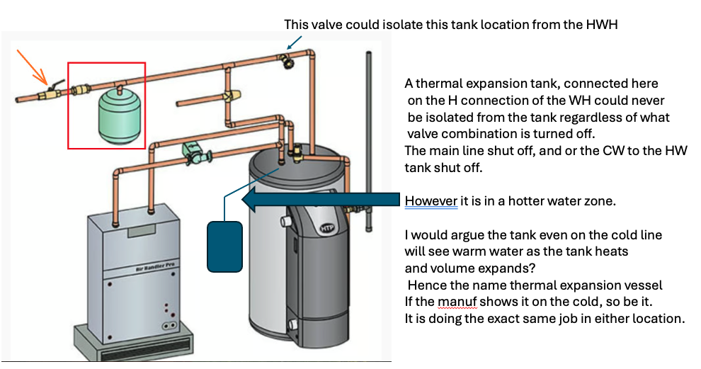

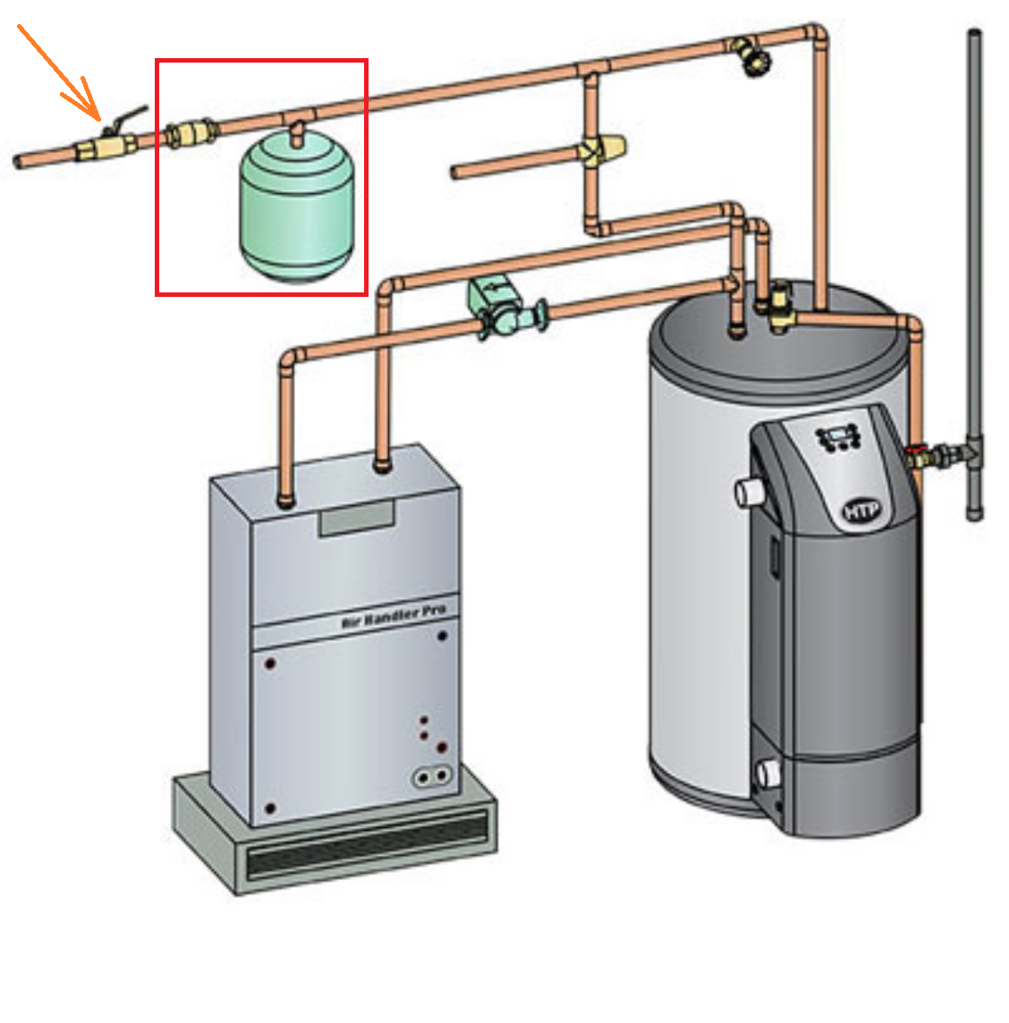

    hot_rod Member Posts: 25,954
    There is no BFD requirements for WH installations. But WH manufacturers install the heat trapper nipples as part of the energy standard, they are a "weak" check valve, they are not a 100% bubble free stop like a spring check. I have never heard hammer noise from the trapper nipples. Just a reduced flow :)
    Soft seat spring checks, used where needed, generally do not cause water hammer. Or else ever circulator would be hammering.
    Dual check BFDs on you main incoming line do not cause water hammer, there are millions installed. They all use a soft seat spring check of some sort.
    A fast stop of flowing water starts a hammer. Solenoid type valves in washers, dishwashers, icemakers, some lawn sprinkler valves.
    The check valves in a DHW are not stopping a fast moving stream, they merely close to prevent flow in the opposite direction when flow stops.
    It is the long travel length and typical brass on brass seal in a swing check that may start elastic shock aka water hammer. Not all swing checks can be installed in vertical or horizontal orientation.
    Screenshot 2025-11-01 at 3.27.13 PM.png Screenshot 2025-11-01 at 3.28.54 PM.png
    Curious @hot_rod "There is no BFD requirements for WH installations. "
    Maybe an incorrect assumption on my part, but then why do I keep seeing it ? And not a part of a space heat hot water hydronic heating system ?
    @hot_rod Is it then just best practice in case someone shuts off (closes) the valve at the Orange arrow without turning off the the system that heats the DHW ?
    edited November 1
    I do not have a PhD in human nature. Folks do like to be paid for their time. Apparently in his view he repaired what he was tasked to do, and any resolution of any side effects to that original task that incurred should be at your expense, since it is your system. I agree it don't seem fair when you expect an expert repair, although I have said for decades that 'professional' and 'expert' are two different things.
    That is why (I think I stated before) is one reason I do my own work, then I only have to fight with myself. Doing your work also has its perils.
    Anyway I would JUST do this;
    I would remove check valve (H) from the system, install a Tee where check valve (H) was, then move the expansion tank with proper orientation and support to the new Tee, as @Larry Weingarten suggested add a service valve between the expansion tank and the Tee.
    Then reassess, knowing that there may be a shower valve that may need repair or replacement.
    BFD back flow devices are to protect a potable water system or source from water of a higher hazard.
    Basically on the main line to a home or building a RPZ type BFD is the most common. Some water meter yokes have a BFD built in, but non testable.
    The public water supplier doesn't want water back once it has entered a building or piping system off the main, ever. They have no control over what cross-connections or hazards are in your building. Even a garden hose in a mud puddle could contaminate the public water, in a back flow or back siphonage condition.
    Once the water is in your building additional BFDs may be required to keep YOUR water safe, boilers, lawn sprinks, fire protection various faucets, etc.
    As such the plumbing codes identify typical hazards that need protection, and usually the ASME listing number.
    Hose bibs
    Kitchen faucets with spray hoses
    Tub fillers with spray hose
    Hand held hose type showers
    Old style tube spouts below the flood rim of the tub itself
    Hydronic systems
    Drink dispensers
    Lawn sprinkler
    Fire sprinkler system
    etc, etc
    Different levels of hazards require different ASME listed BFDs. A boiler with EG is a high hazard, needs a testable RPZ
    A boiler with tap water is a low or medium hazard, a vented dual check is acceptable, some ADUs allow unvented style dual checks.
    AHJs identify boiler water hazard differently. We sell 3 different boiler BFD devices. In NY state alone 3 different types are accepted depending on the area.
    A swing or spring check is not a listed ASME BFD, unless it specifically has an ASME listing number permanently affixed on the device.
    I read through the UPC, don't see a requirement for BFDs on tank water heater supply? Check valves yes, for backflow within the recirc, but not a listed BFD. Unless you know of another?
