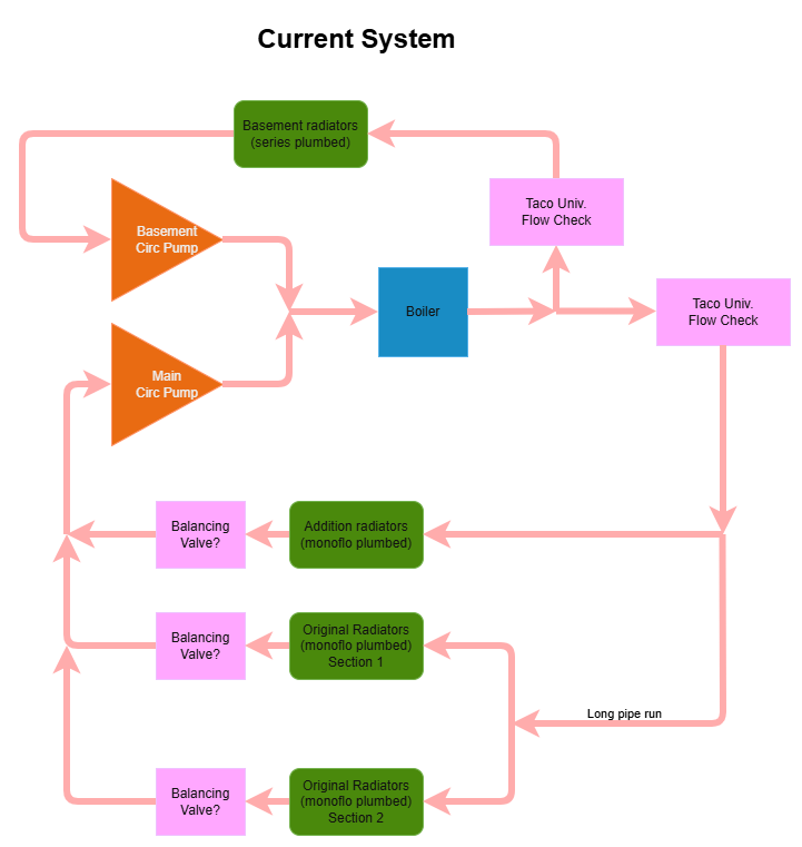

I have a house with a main zone (all living space) and a basement zone. I would like to split the main house zone into two zones, one zone being the original house, and the other zone being an addition that was added a long time ago. I think I have an idea for doing this that will work, but I'd like to know if I'm missing something, or if there is a simpler way.
Here is the current setup:

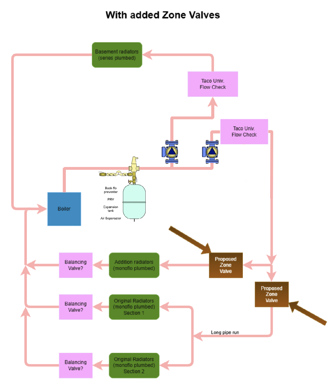

I think that I could add a high Cv zone valve ahead of the addition radiators (White Rodgers 1361-102) and ahead of the "long pipe run" (White Rodgers 1361-104) to the original radiators in order to make the plumbing work for splitting the addition radiators on their own zone.

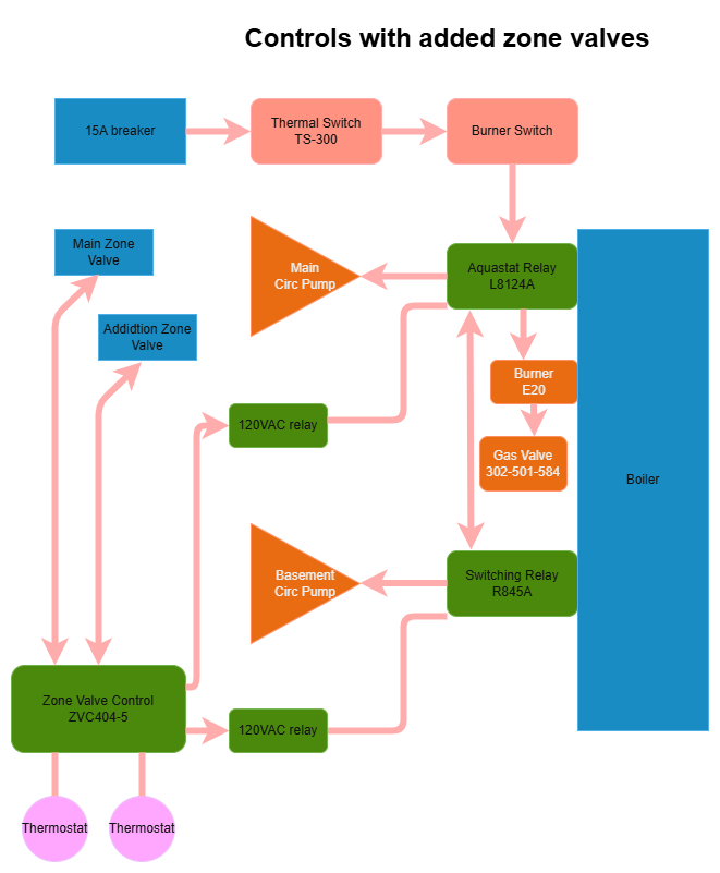

Currently the boiler is controlled by a Honeywell L8124A aquastat. The basement zone is controlled by a Honeywell R845A relay. I'm not quite sure how to connect everything. Is there a zone control that easily allows for control of zones that are not all on the same circulator pump?
Since the basement zone basically never calls for heat, I think that I could do it like this, with a Taco Next Generation Zone Valve Control with Priority. I could put the basement on the priority zone, since it has one thermostat input and one output. I could install the two thermostats for the main house and addition, and send those outputs to the zone valves. Then I could put the circulator pump outputs (priority and zone) to relays which would act the same way as the thermostats do in the current system.
What I think this achieves is:
  1. The aquastat still controls the boiler temperature, and can disable the circulators if the boiler temperature falls.
  2. The zone valve control only calls for heat to the old aquastat relay once the zone valve(s) are open, so the pump won't be pumping dead-headed.
Current parts:
Boiler: Blue Circle 813 N, originally an oil fired burner, I think with a tankless DHW coil. Hot water is now on its own tank separate from the heating system.
Burner: Economite E 20 gas fired conversion burner
Aquastat: Honeywell L8124A
Switching relay for basement zone: Honeywell R845A
  • Big Ed_4

    OK, you have a good idea there to separate the zones the way you want. Be careful with MonoFlo® tee systems. The pressure drop of the zone valve may or may not disrupt the balance. When the MonoFlo® was added to the addition, the installer must have done their homework in order to be sure the single zone was balanced with the rest of the house. (Unless that is the reason you want a separate zone because it is not balanced).
    So zone valves are a good way to make zones happen and I see no reason zone valves will not work for you. Since you no longer heat your water with a tankless coil, your aquastat should be rewired to make your boiler a cold start boiler to reduce fuel usage. Is that done? OR Do you need to shut the switch off in the summer so the boiler does not maintain a minimum temperature all summer for DHW you will never use.
    Next, while you are doing the repiping, the boiler will be drained of water.  This would be an ideal time to redesign the system to eliminate any air problems that may occur based on the location of your circulator pumps.  Read the book Pumping Away for reasons to make that change.
    I might think that this design would be a better design.

    with the monoflo you have to be really careful that your high cv valves really are high enough. it would be a better idea to do zoning by circulator here.

    You need not use the 120V realy to operate the L8124A when you are using the ZVC404. Just use the X X from the ZVC 404 directly to the L8124 T T terminals. Don't use the Priority zone for anything, That zone shuts off all the other zones in favor of making DHW. You are not making DHW so there is no reason to shut off any circulators or zone valves to heat one space over another space. Let the zones heat as needed without priority.

    @Kaos I looked at the Taco ZVC404-5 and that has a thermal purge feature built in to it. And since the thermal purge is built into it there is no need to make it more complicated with additional relays. Just flip the DIP switch
    Here is the wiring diagram for the system as I might do it.
    The Priority DIP switch is OFF so zone 1 is the same as the other zones. I have also substituted the ZVC403-5 to save some money on the control system. Unless there is a need to add 2 more zone valves in the future, the 3 zone control is all you need.

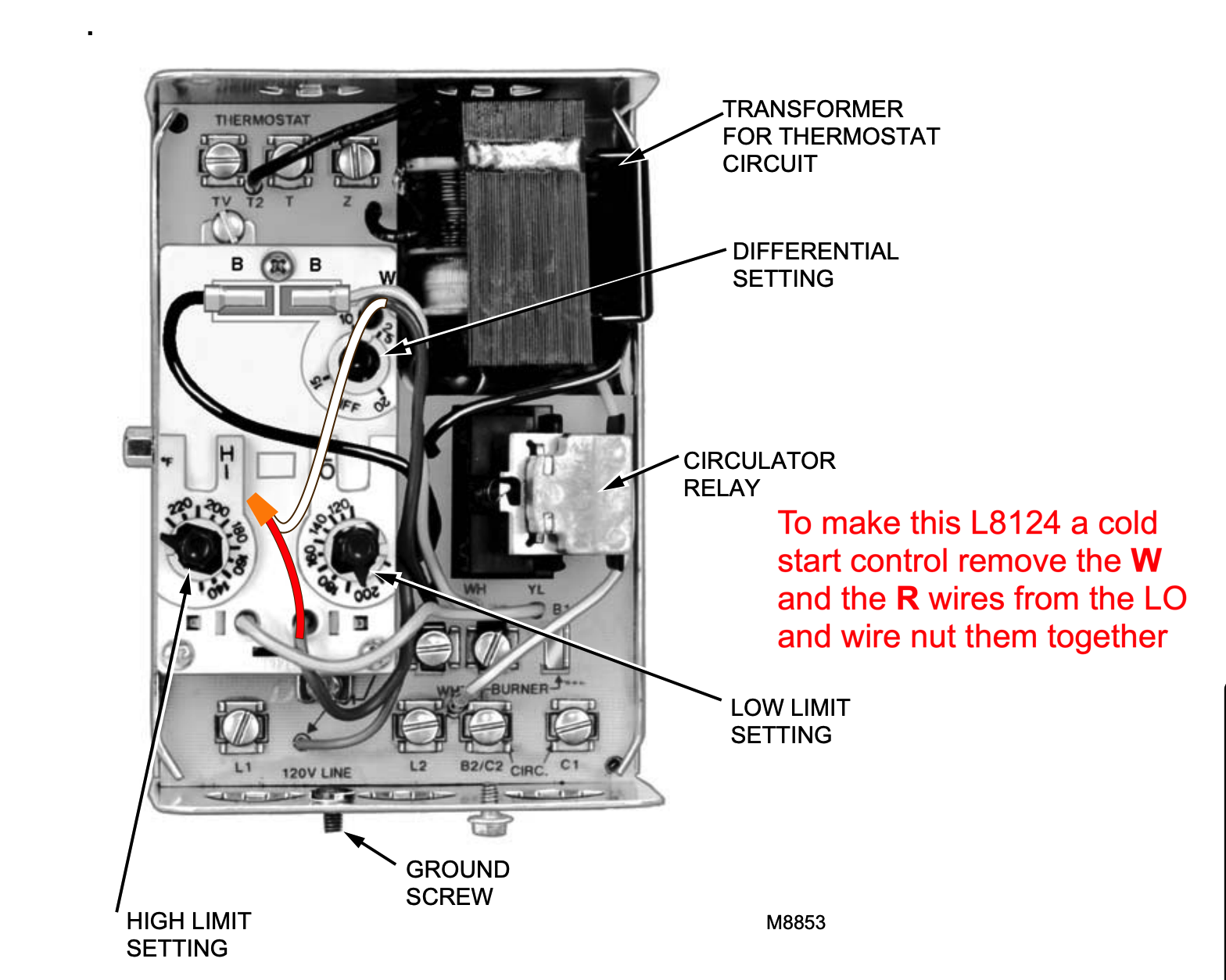

    Look close at the L8124 triple aquastat… I have rewired the DHW priority so it is now a cold start control.

    1. I was thinking of using this 1-1/4" valve on the main loop and this 3/4" valve on the addition loop (matching the piping on those runs). Those have very high Cvs (42.2 and 23.5) equivalent to 6.5' and 2.5' of straight tubing, so I thought that would probably maintain the balance reasonably well.

    @sre92 said: "I was thinking of using this 1-1/4" valve on the main loop and this 3/4" valve on the addition loop (matching the piping on those runs). Those have very high Cvs (42.2 and 23.5) equivalent to 6.5' and 2.5' of straight tubing, so I thought that would probably maintain the balance reasonably well.
    Not a fan of that valve actuator but it is a great choice for the Cv. I never realized that valve had such a high Cv. Now, after all these years, it finally makes sense to use those WR valves

    Rarely is there a problem with converting a tankless coil boiler to a cold start boiler. If you are shutting off the switch in the summer. you are making it a cold start boiler for the whole summer. Does it leak over the summer? If not then you won't have a problem making it a cold start boiler. I like to think of it this way:
    1. One day in September or October you will feel a little chill. Then you go to boiler and switch it on to warm up the house. From that point on, the boiler will maintain a minimum temperature set by the L8124A low limit dial. Even if the next day the outdoor temperature rises, and stays higher for the rest of the week or so. During the time when the thermostat never calls for heat, you are burning fuel for no reason.
    2. When that boiler was manufactured there was an identical boiler without a tankless coil that came with the L8148A cold start control. The company made thousands of them. Way back then, the boiler gaskets and seals were able to withstand that cold start design, and the condensation of fuel gasses from the cold start were quickly evaporated away once the boiler reached temperature. Ususlly within 3 minutes of operation.
