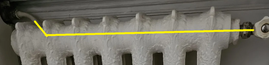

    mattmia2 Member Posts: 15,504
    What is this tube, where does it go? Is it a vent for the radiator or is it part of an older pneumatic control system or what?

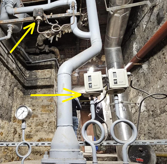

    Does the boiler have a modulating burner that maintains pressure or does it limit pressure with an on/off control (in the us that is called a vaporstat or pressuretrol depending on the pressure range)?
    1/2 psi is typically about what pressure vapor systems operate at in the us, the orifices are sized to admit a small enough amount of steam to the radiators that it doesn't reach the returns.

    @mattmia2 " What is this tube, where does it go? "
    This tube ? Maybe the radiator supply.
    Multiple pressure controls the lower two looks like Vaporstat size diaphragm diameter.

  • jeje59350
    jeje59350 Member Posts: 6
    Yes the tube is the way you drew it and it is indeed the radiator supply.
    The burner is not modulating. It is on/off control thanks to the two white pressure switches on the bottom of the picture. One is for starting the boiler when the pressure gets too low, the other one is for stopping the boiler when it reaches the pressure setpoint.
    The black pressure switch on the top is a security "high pressure" switch.
