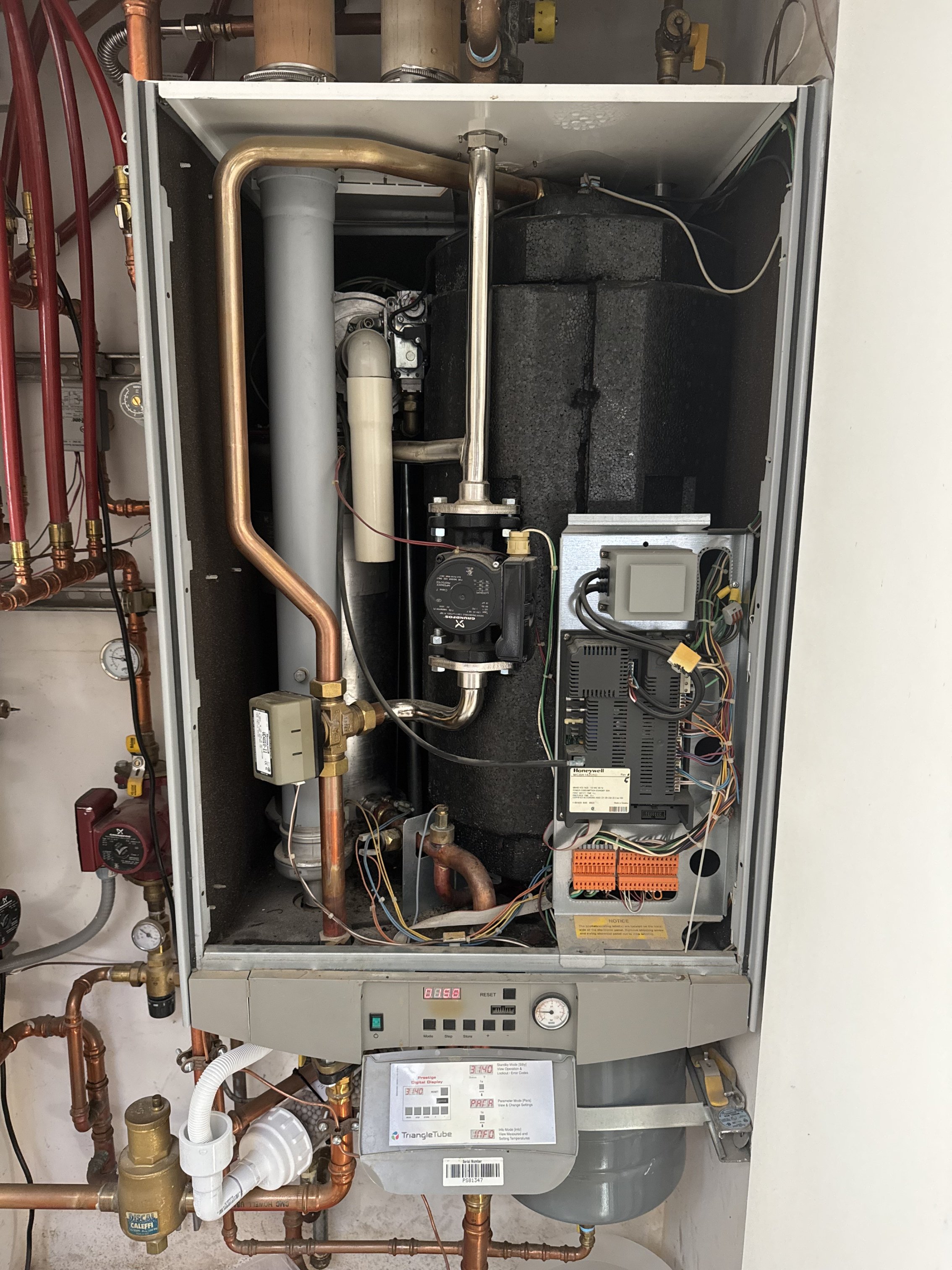

    This is the best picture I could find. You can see the insulated tank behind the circuit board and pump.
    I considered changing the tank in vitro, but there are too many difficult connections; above and below the boiler.

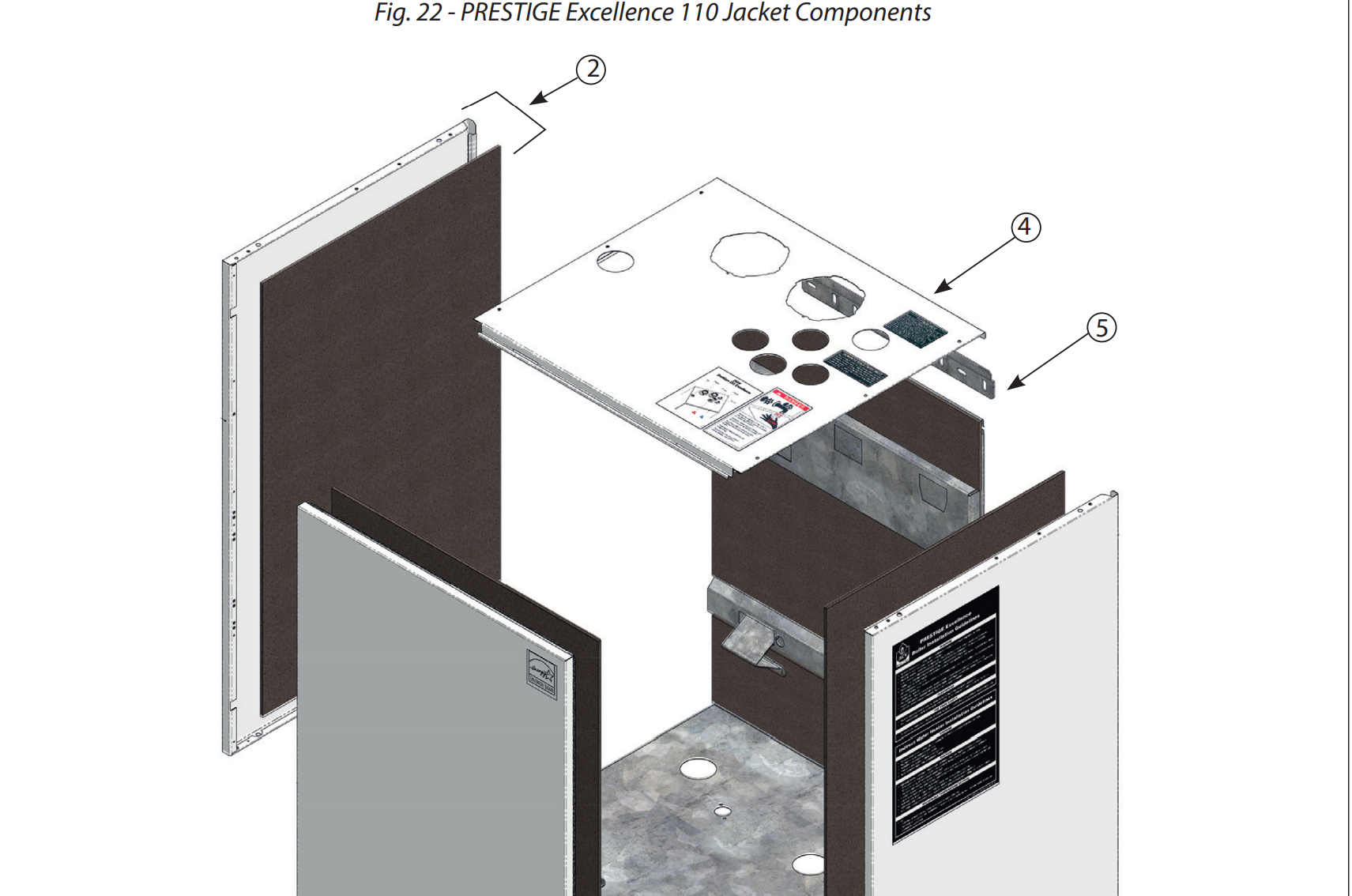

    After draining DHW and heating water, disconnecting the sensors and piping, you have to lift the tank off the high and low hangers in the back. This is the hard part as the right side of the enclosure is up against a wall which may make removing the lid of the enclosure difficult as the screws for the lid may come in from the side.

  • Here is a picture of the one I'm working on:
    You can see that there's no room to lift up the tank without hitting the top of the enclosure. I'm thinking I have to cut the enclosure in half widthwise, just where that chrome pipe goes through to the relief valve and then bend and remove the lid to give me room to lift the tank.
    mattmia2 Member Posts: 16,692
    It looks like the top panel screws down through the top in to the side panels but it also sort of looks like that forms a lot of the structure that lets it hang from the wall bracket

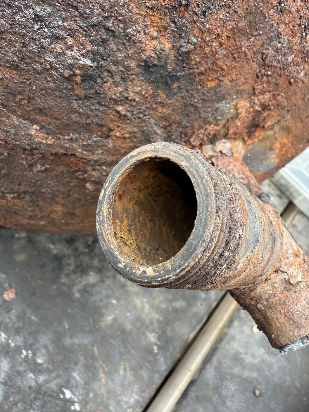

  • The hardest part was making the boiler water connections. The old tank nipples had thick walls at the nipple ends which were a nice shelf for the fiber washers to sit secure, but the new connection points didn't have that thickened end and the washers would slip into the pipe as you tightened the nut.
    A properly sized brass friction ring would have kept the washer in place, but we eventually hit on some thick Viessmann washers that worked well. I know now why I never throw unused washers away.
