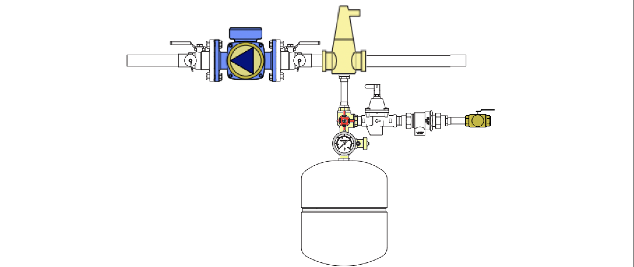

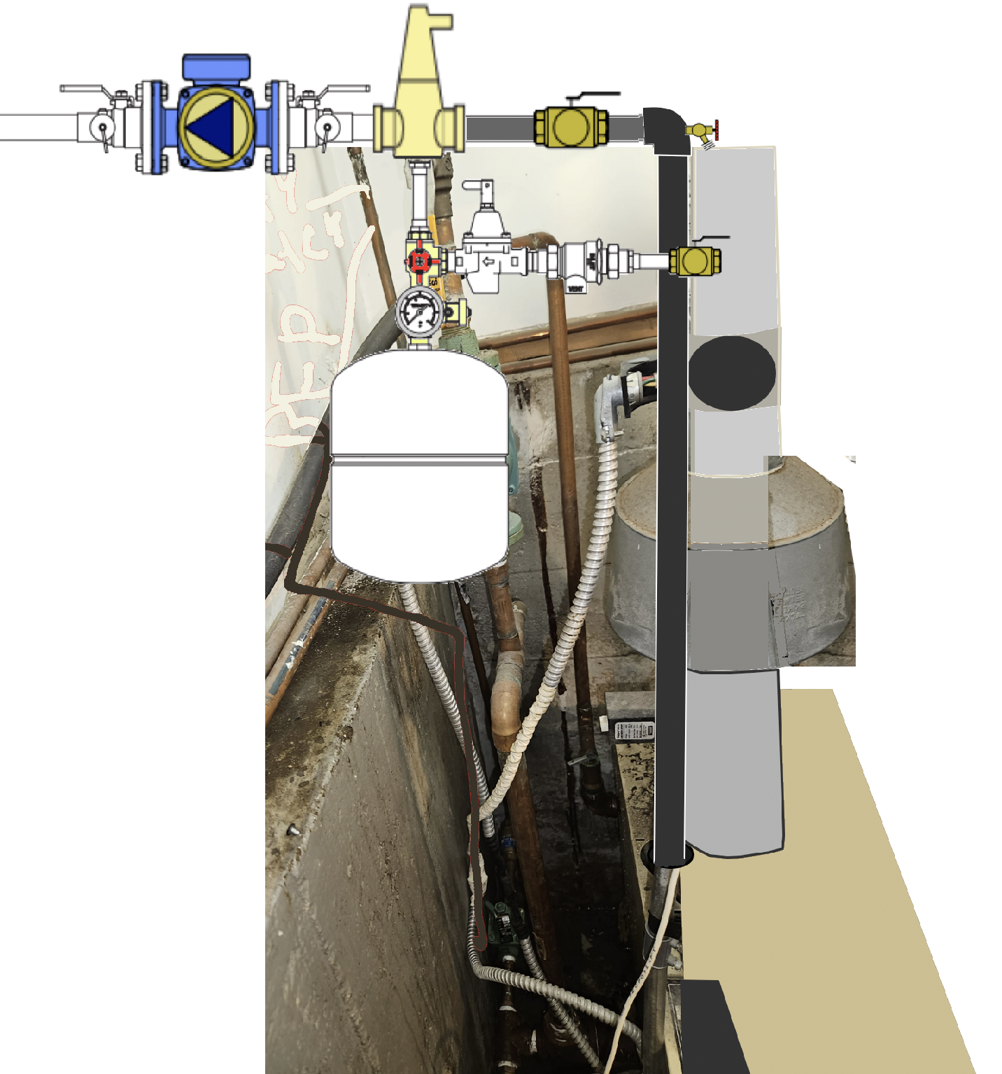

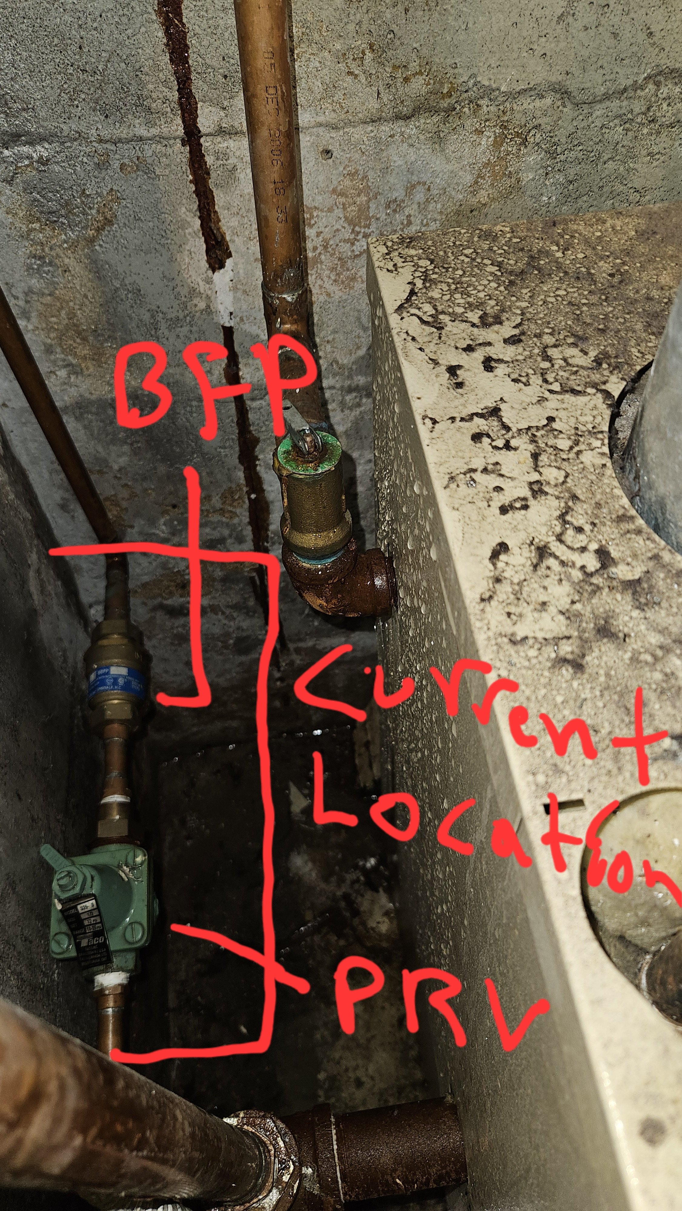

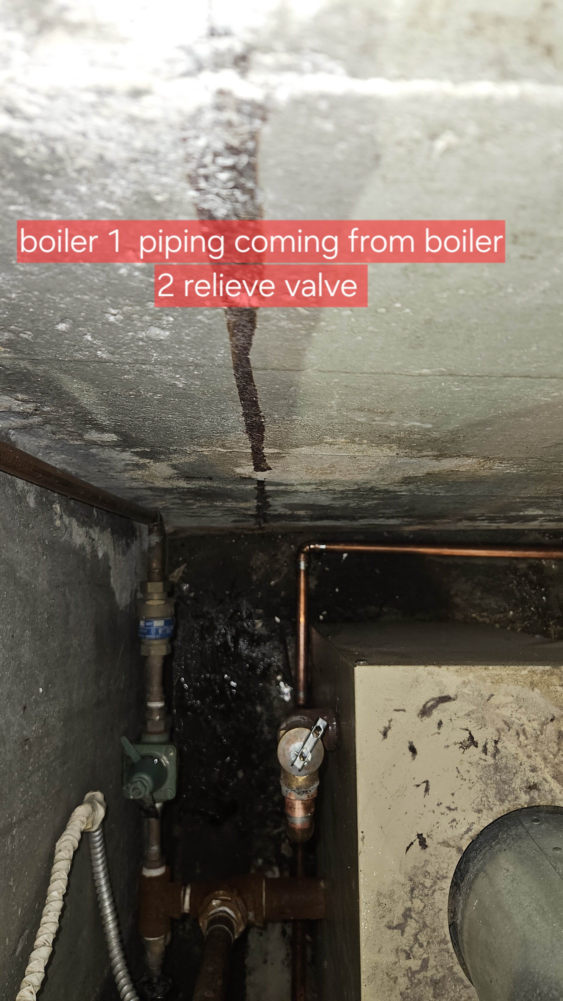

hello techs , recently worked on boiler had to pipe in relieve valve to bldg drain, found PRV leaking causing system to lose pressure, the location of the prv is tight no space to work , I want to relocate the new prv & back flow preventer so it accessible for future repalcments ,i.ll share job pics any suggestions would be great,
as the job looks simple.

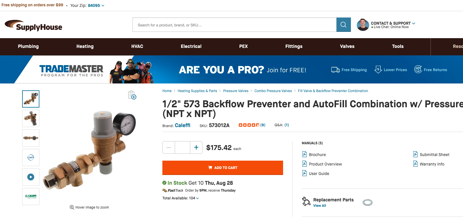

    hot_rod Member Posts: 25,510
    Sure, a combo package makes that easy.
    Replace that pressure relief also.
    Is that a LWC with no wires connected? :)

    EdTheHeaterMan Member Posts: 10,879
    edited August 26
    I like the combo units also.  They come with a union fitting so you don't need to cut pipes to replace the parts in the future. If you pipe it near the expansion tank and include an isolation valve on both sides of the setup, you can service the expansion tank, back flow preventer and auto feed PRV without draining the boiler or shutting off the house’s potable water supply. This Expansion Tank Fitting on one end and that ball valve on the other end will accomplish this nicely.

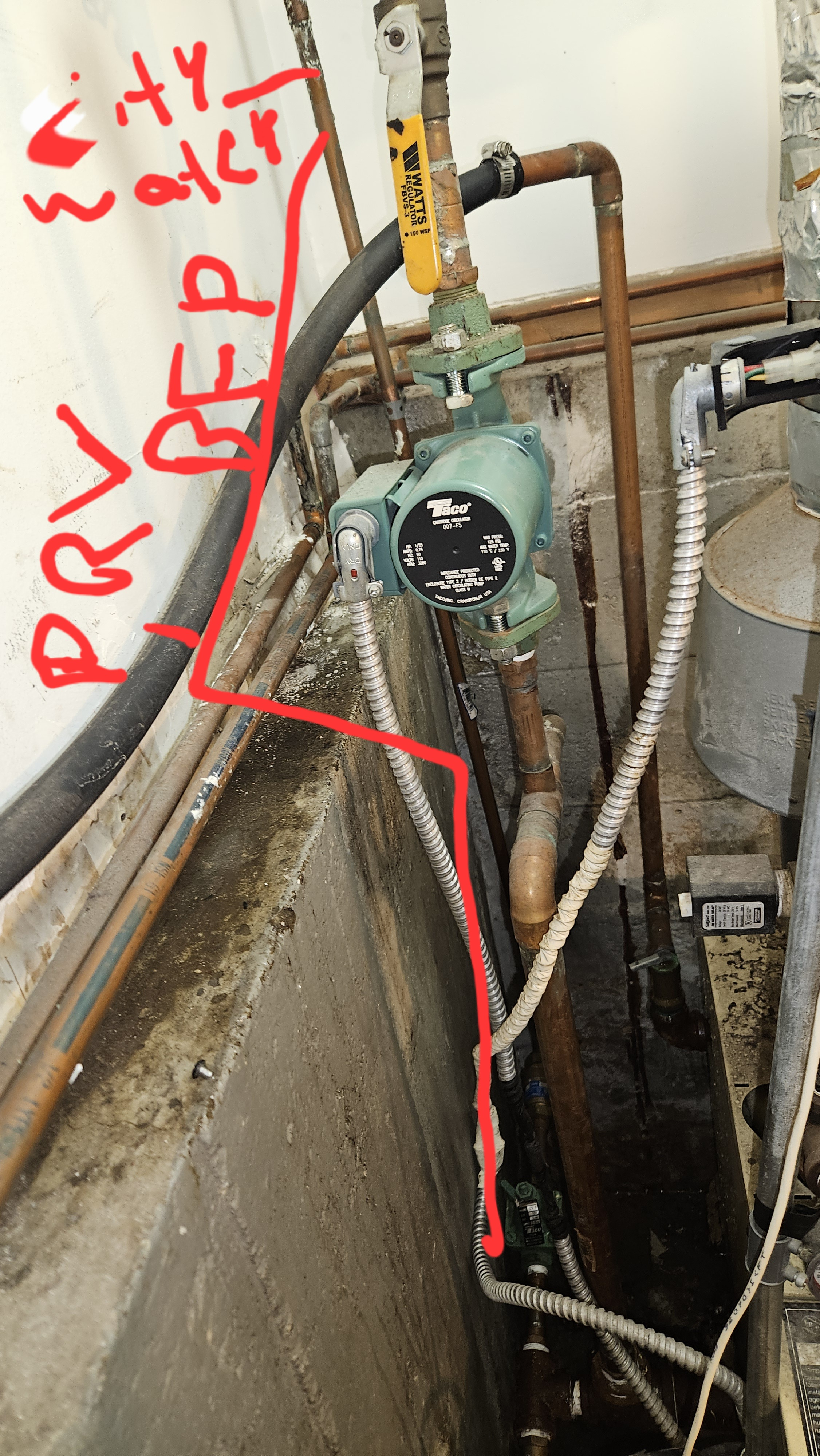

    Looks like you are pumping into the boiler? Air purger and expansion on the supply side of the boiler?
    An upgrade would be to connect a tee above that pump, tie the tank and fill valve there.
    If I repiped this one it might look like this

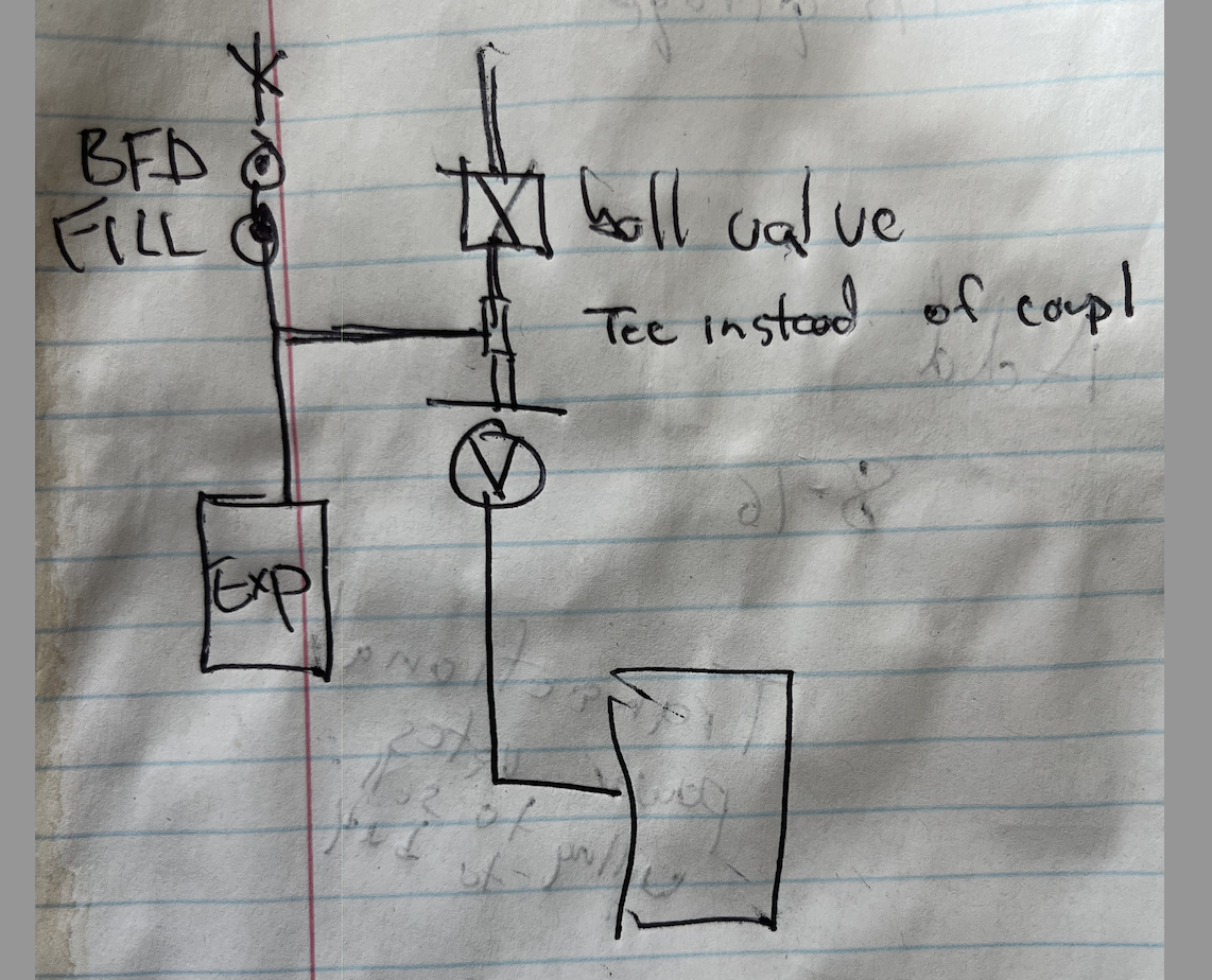

    Or this option.
    Above the pump, below the yellow ball valve is a coupling. Remove that, install a tee with 1/2 branch. Tank and fill connect there.
    HVACNUT Member Posts: 6,955
    Are we going to address the discharge piping on the relief valve?
    mattmia2 Member Posts: 13,872
    I had plans to do something other than addressing all of the issues in those pictures tonight. It would be easier to cut everything back to where it comes out of the house and the boiler and start over than to try to fix what is there.

    I replaced the pressure relieve valve & tead boiler 1 & 2 relieve valve into floor draine ,LWC is not even connected ,I initially came in May to help stop relieve valve leaking water on boiler 1 & left job for September due to hvac season, looks like ex-tank full of water i cant even press the air pen to test it , poor maintenance & safetys bypassed by unprofessionals just to make few bucks & runaway ,am going to fix all issues i.ll share pics of the piping on the releive valve .thank you for looking in.

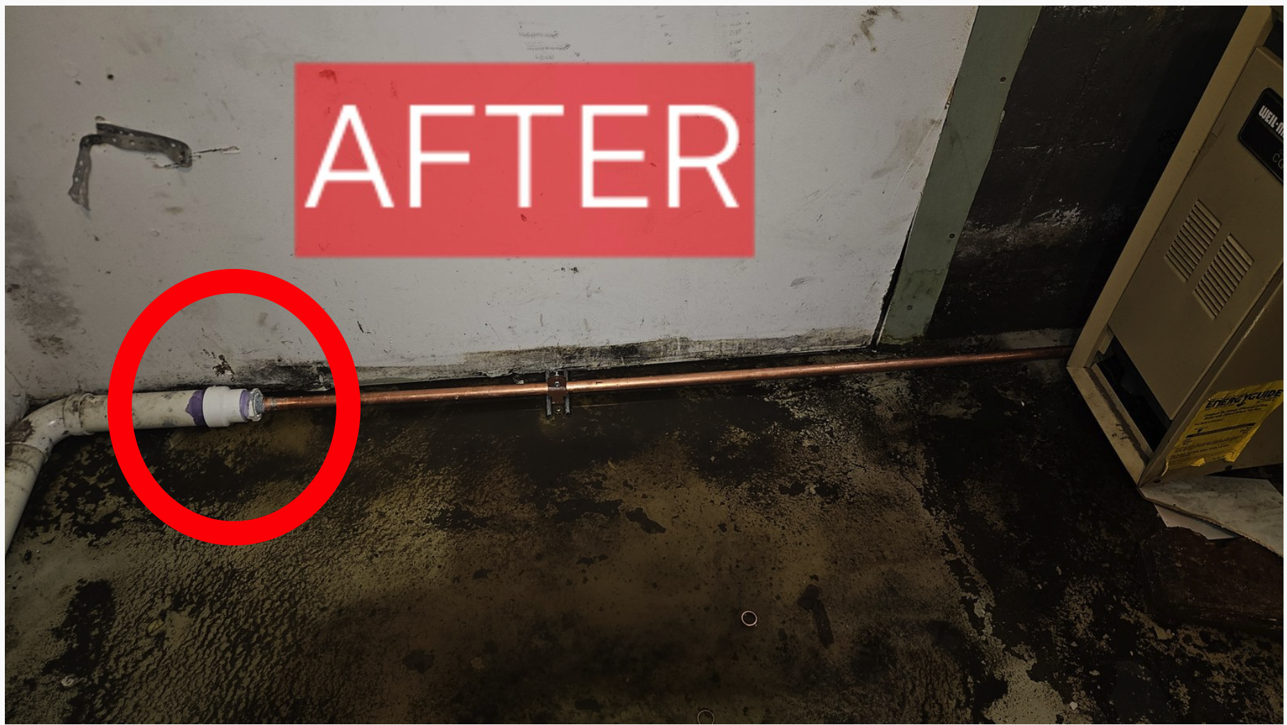

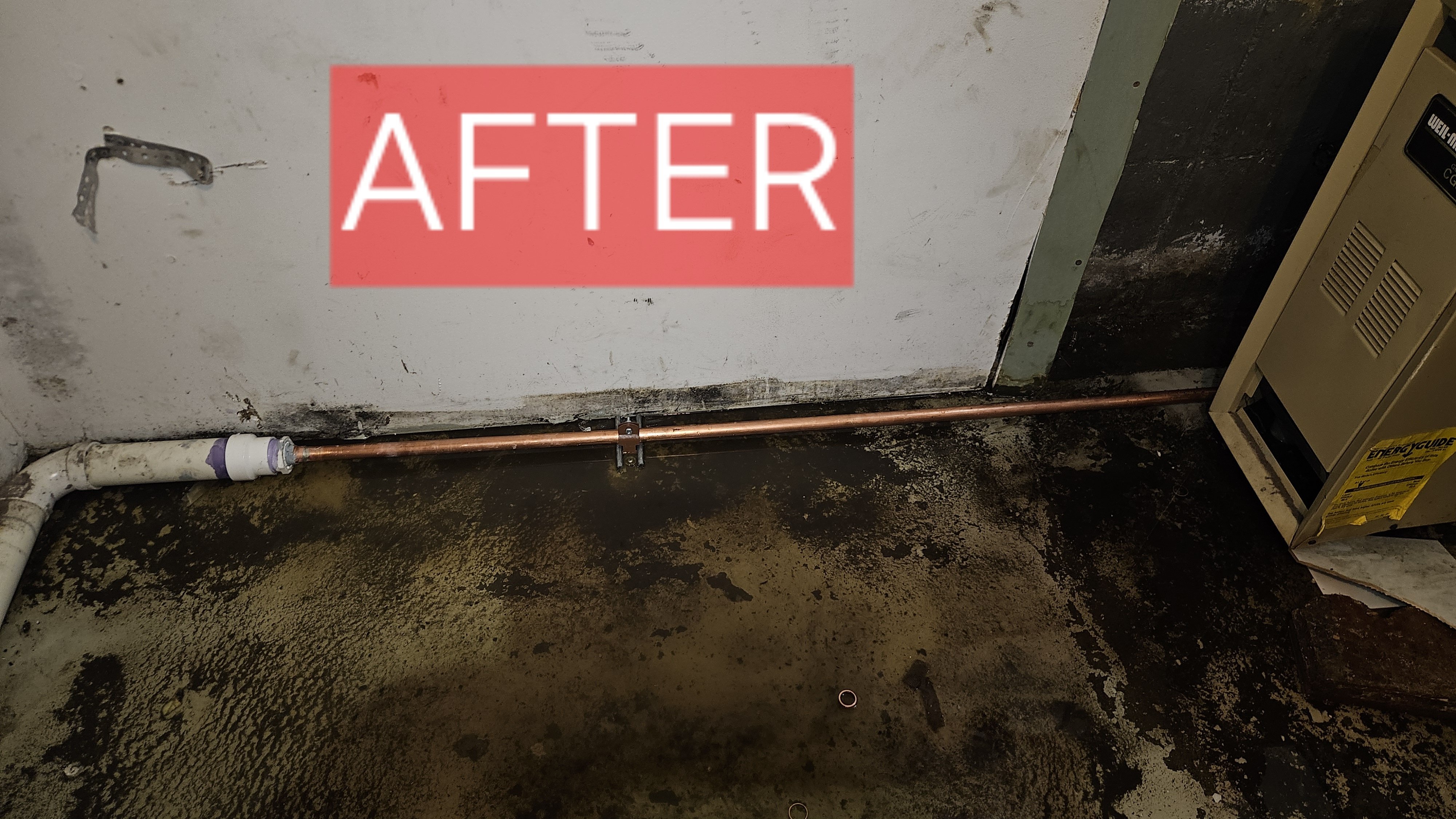

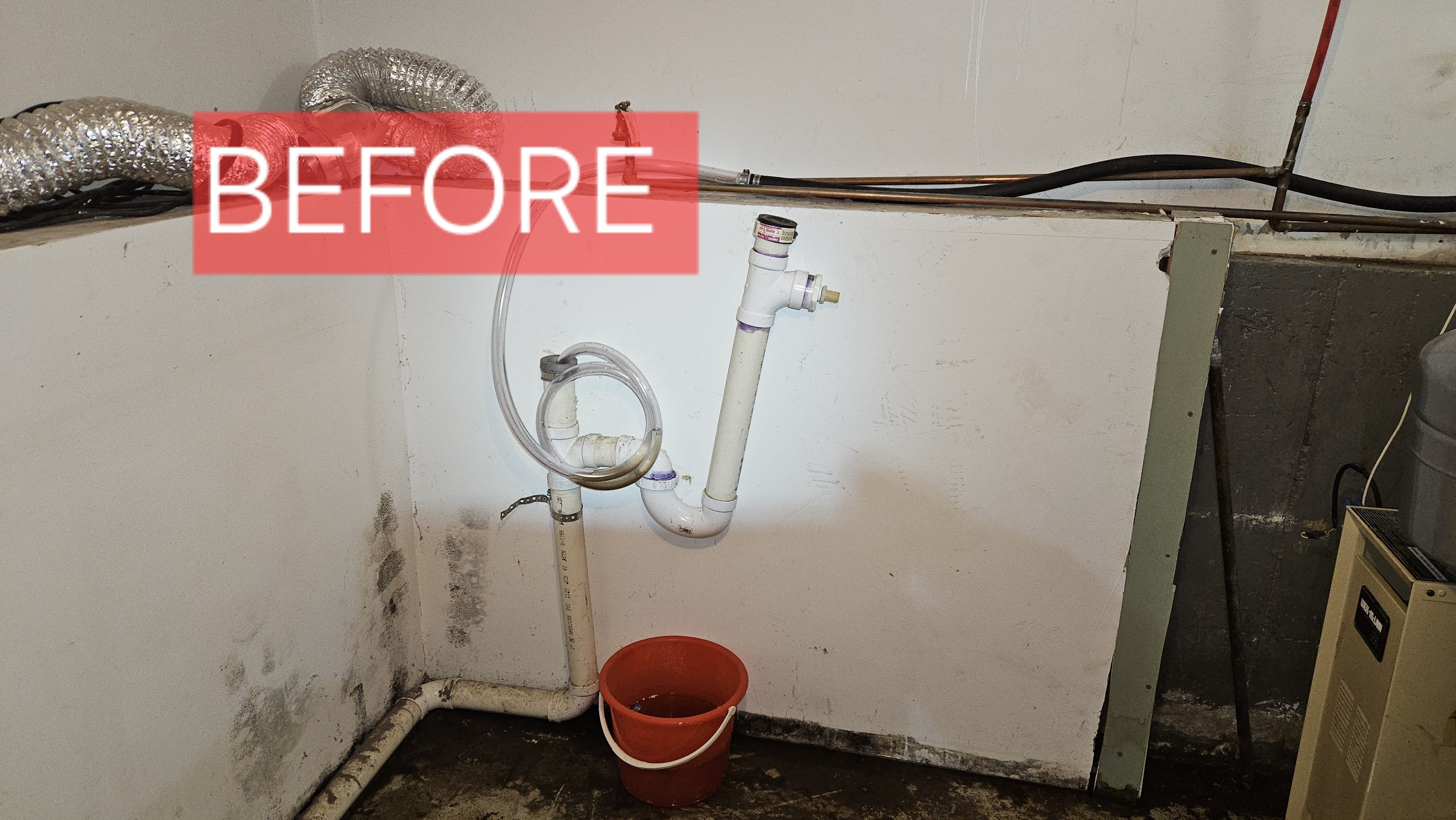

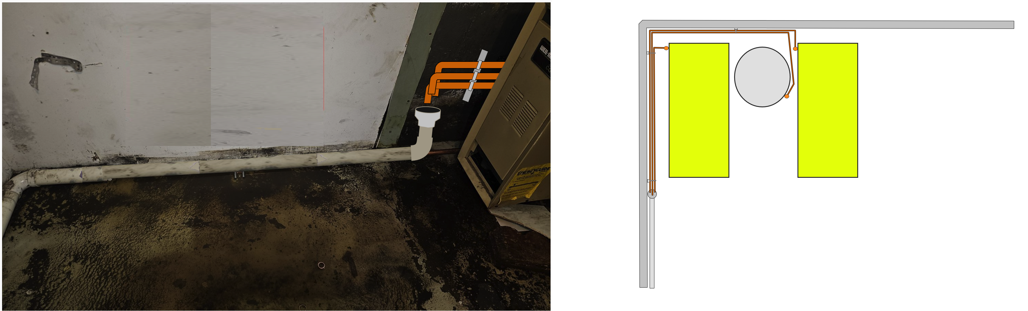

    I looked at the After Photo and might make this observation. Your solution might be in violation ANSI Z21.22, and I'm sure you did not intend to do that.
    In Accordance with ANSI Z21.22 No valve is to be placed between the safety relief valve and the tank. A discharge line shall be connected to the outlet of the valve and shall pitch downward from the valve. Discharge line shall terminate through plain (unthreaded) pipe with at least a 6” (152mm) air gap from building drain or other approved location where any discharge will be clearly visible. In no case may a discharge line be directly connected to a sewer line. No reducing coupling or other restriction shall be installed in the discharge line. The discharge line shall be installed to allow complete drainage of both the valve and the line. Discharge line material must conform to local plumbing codes or ASME requirements. Excessive length over 30’ (9.14m), use of more than four elbows, or reducing discharge line size will cause a restriction and reduce the discharge capacity of the valve
    You can find this information on just about every relief valve tag that is supposed to be left in place after the valve is installed. Here is a typical tag:
    This photo represents a situation where the discharge is not visible with a minimum of 6" air gap and where it is directly connected to a sewer drain pipe.

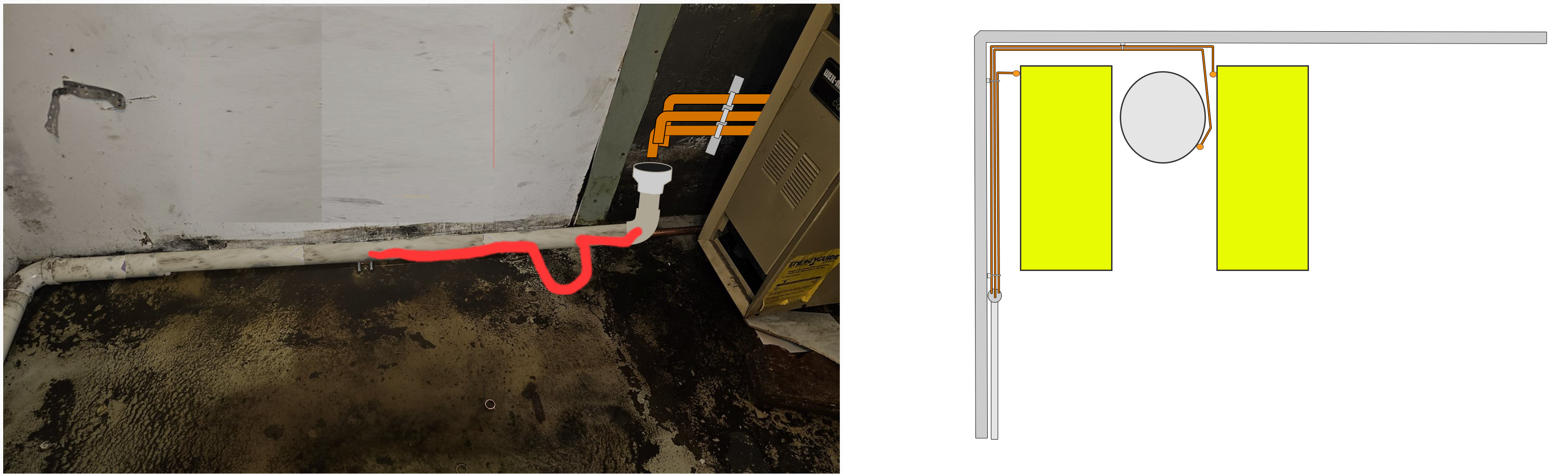

    I also wonder why there was a trap in that drain and there isn't one now.
    Washing machine discharge?!? maybe

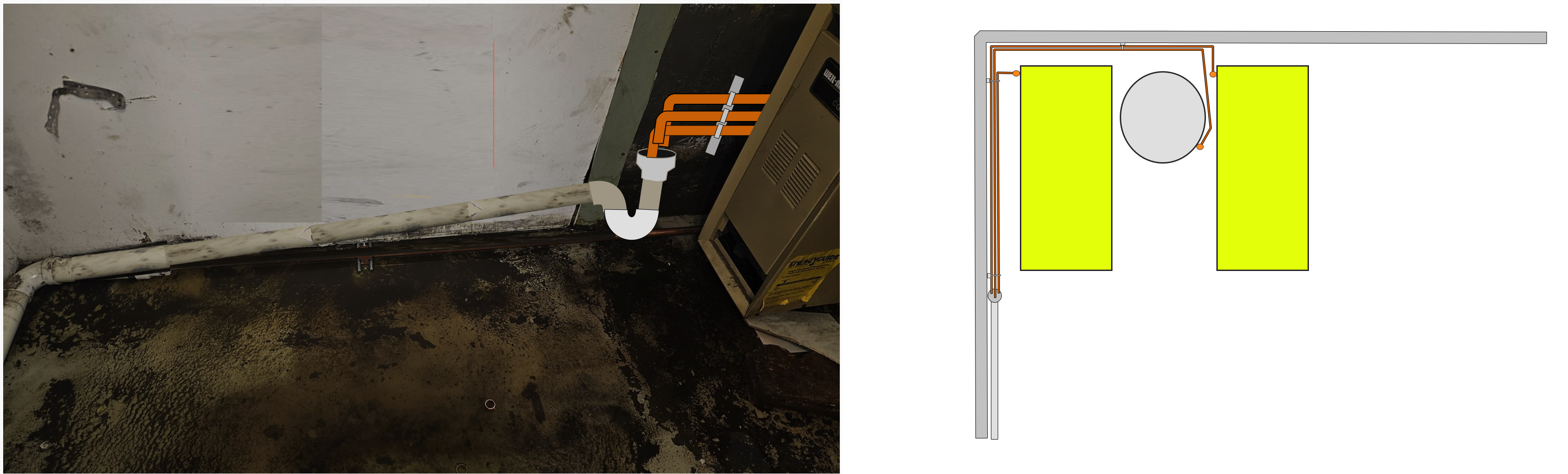

    I might suggest this design. include all the relief valves for each boiler and water heater. Try not to use more than four 90° elbows.
    A trap on the drain line may also be necessary.

    there was a washing machine in past not sure if photo can show there's still hot & cold water lines which are not used.
    If that drain goes to a sewer it needs a trap.
  • nytech28
    nytech28 Member Posts: 99
    yes indeed i did not intend piping to sewer line to do fast job ,that's why am sharing the job photos,to execute the job professionally & upto code i.ll have to correct the relief piping , I do have the 2 boiler relieve valves tead together which I would have to redue.
    is it possible the white pvc just sits over a floor drain that is trapped? If so that is an indirect waste, and legal.
    mattmia2EdTheHeaterMan
  • nytech28
    there is no floor draine in the boiler room ,the pvc travels towards the basement bathroom erea & not sure where it ends ,mostliky bldg drian system .
  • nytech28
    I can add my own trap on the white pvc before the open funnel. as pictured.
    nytech28
    but if there is already a trap on the line, you don’t want a second trap
    Find where that line ends up. If in fact you add a trap, by code and for proper operation it needs to be vented
    nytech28
    (depending on where it goes it might be wet vented)
