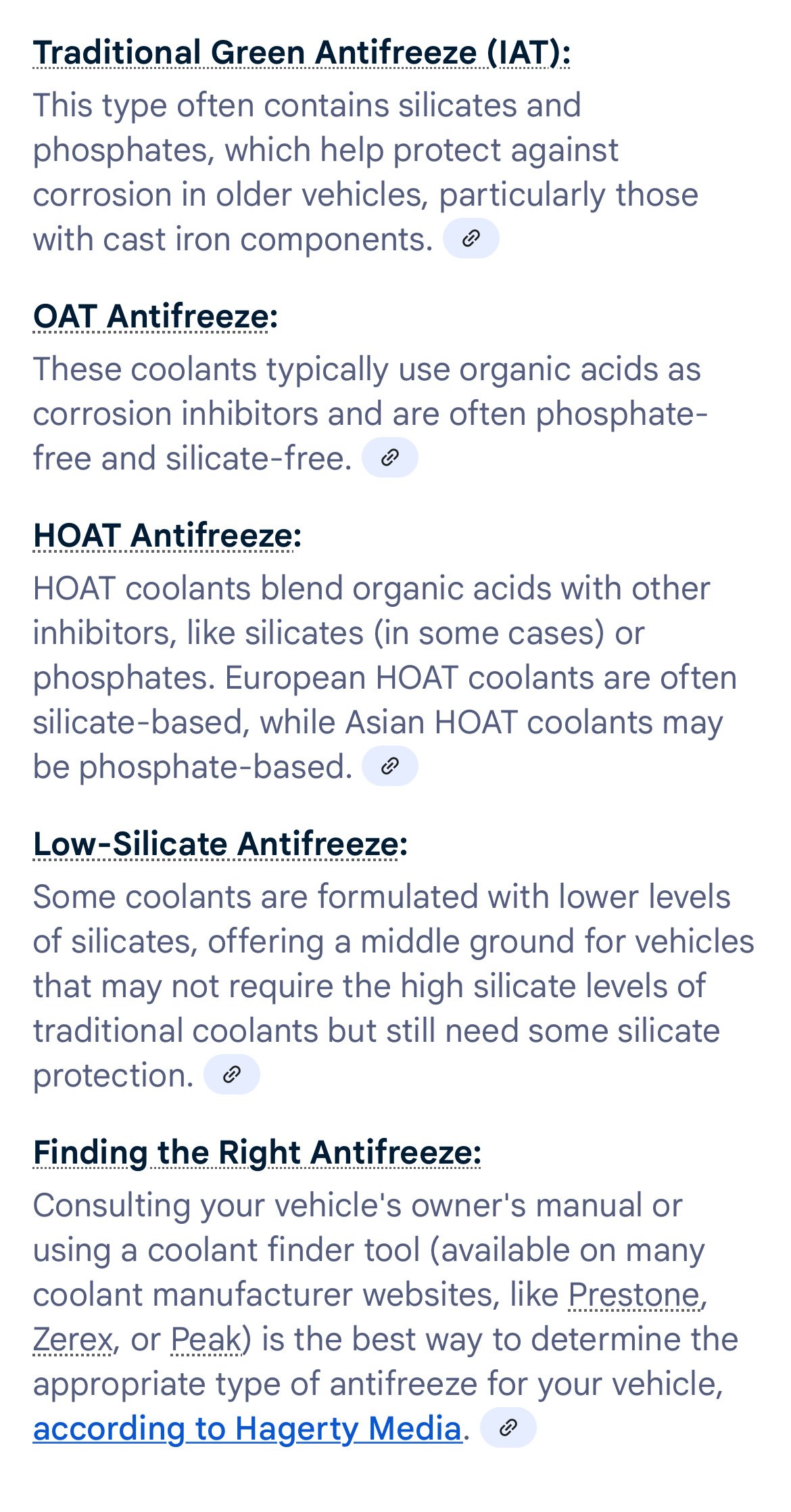

    Automotive glycols contain silicates, a compound containing silicone and oxygen, sodium silicate is one type. IAT inorganic Acid Technology. These coat the metal surfaces to prevent corrosion in the block and cooling system. OAT Organic Acid Technology is supposed to have a longer service life
    But for some resson the silicates sludge up hydronic systems? So not to use automotive, even the PG type in hydronics.
    Hydronic glycols use molybdate or phosphate blends for a film provider.
    Although the silicates will also sludge up an automotive systems , which is why you test and replace it.
    mattmia2ChrisJ
  • ChrisJ
    ChrisJ Member Posts: 17,151
    I thought most modern automotive antifreeze was silicate free now?
