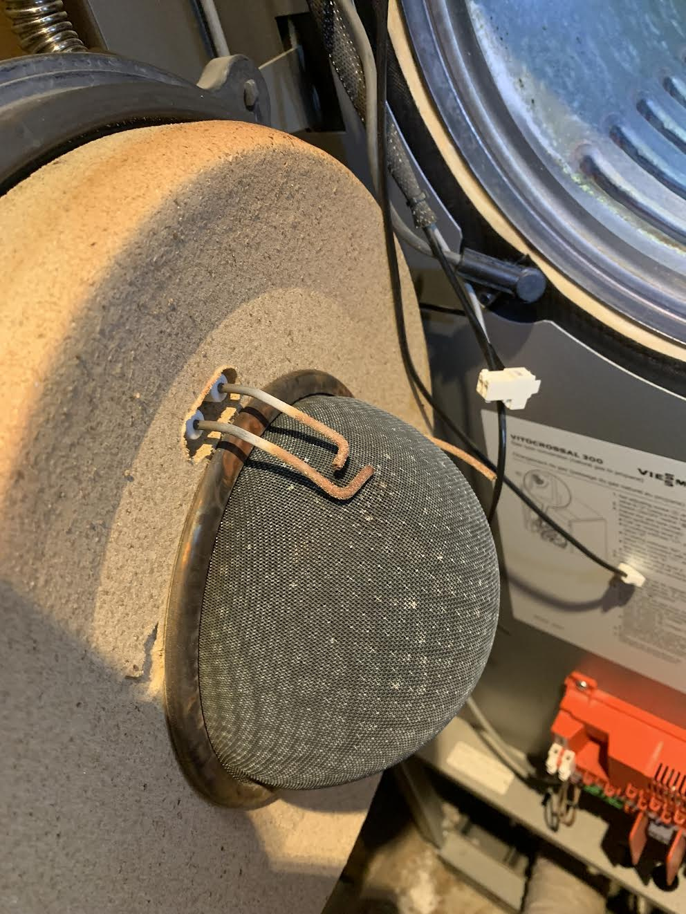

  • We installed a CU3A-45 in Berkeley in 2018 serving radiant floors and ceilings and have only serviced it once in 2022 and the heat exchanger was totally clean. It has a 53-gallon indirect alongside.
    I almost always require homeowners to keep spare parts available with the boiler. In this case, igniter, flame probe, burner gasket, refractory and insulation.

    Alan (California Radiant) Forbes Thanks Alan and thanks for the great photos. I recognize the matrix dome burner and it's good to see the inside of the combustion chamber…that looks really clean! Congrats on that job and that it's gone so well since install…!!!
    The radiant ceilings sound interesting….guess you have to size those for using the radiant output and a lot less in regards to convection…..sounds like a challenging install as well. 😀 I considered going that route but with our recessed lighting and older lathe and plaster plus crown molding in some rooms I ultimately abandoned the idea.
    I am going to take a page out of your book and get the spare parts on hand that you have recommended. thnxs
