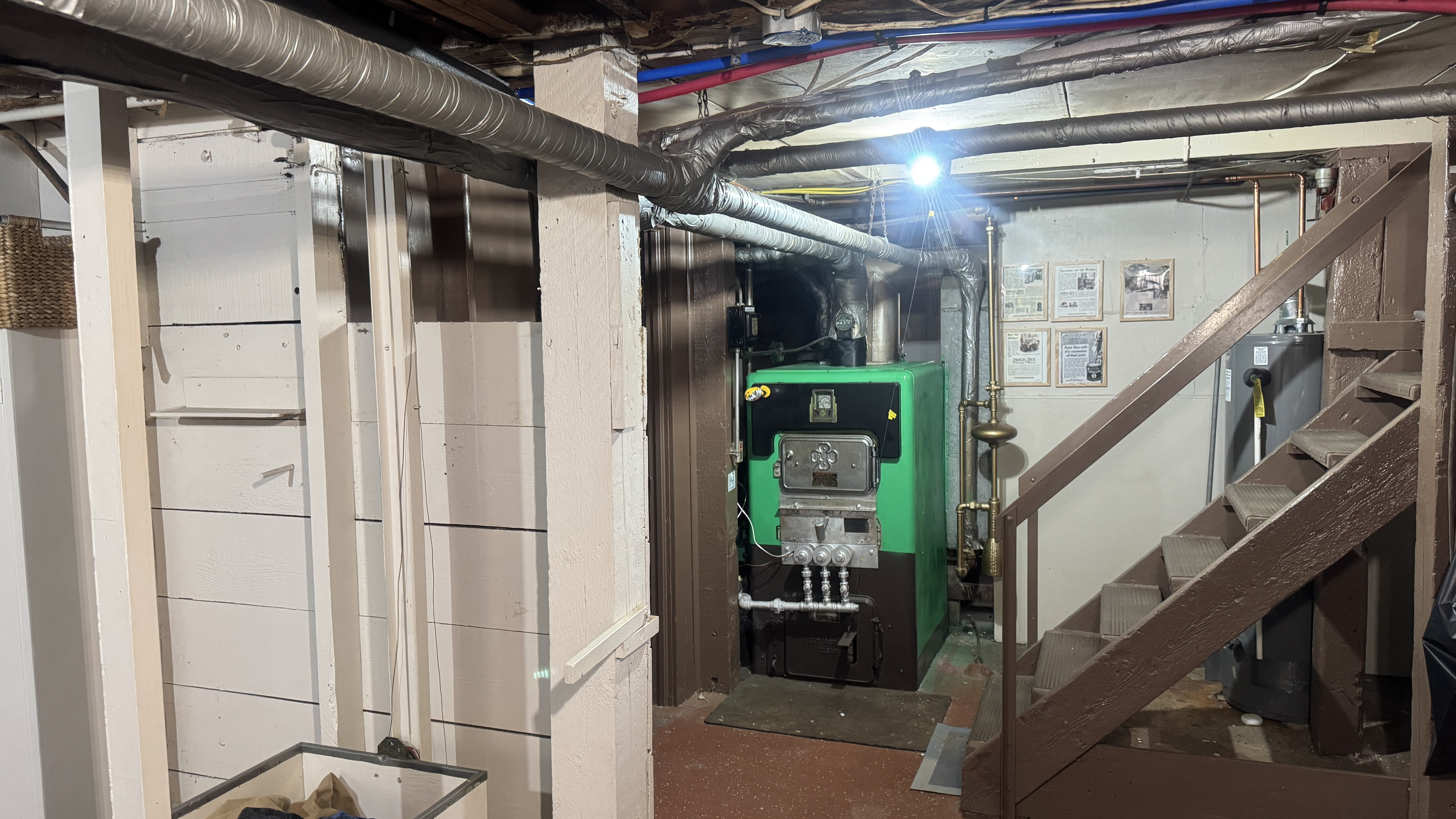

    Is the entire system still running gravity with no circulator or is a former gravity system comverted with a circulator?
    Regardless, its not the best thing to have baseboard on the same system with CI radiation because they don't heat the same.
    A couple of options are to add baseboard but it may not work to your satisfaction. Or take the baseboard out and install a CI radiator.
    Is the baseboard on it's own loop or tied into the gravity system?
    Pictures will help.
    of the boiler and boiler piping from 8' away and pics of the baseboard piping where it connects to the system

    Alan (California Radiant) Forbes - This is a second floor bedroom. The kitchen is below. See pictures below. Not sure of the exact pipe size. But I will note not to go smaller than what is there.
    LRCCBJ - That still would not be enough heat for this room. Heat loss calculations call for 8000 BTU, but I actually would be perfectly happy with over 9000 BTU for the simple fact slant fin does not hold heat the way a cast iron rad does.
    EBEBRATT-Ed - Whole house is full gravity with no circulators (expansion tank in attic). This baseboard branches off from the supply and return line that supplies and returns the water from this baseboard and the kitchen cast iron rad. Previous owner explained to me that the original cast iron froze and burst while she was gone on vacation one winter (the boiler didn't fire). She came home to the kitchen full of water and insurance covered all the fixes. This would have been early 2000s. I acknowledge that it's not ideal to have baseboards with cast iron, but the system works just fine except there just isn't enough length in the room.
    Getting a cast iron rad (new or used) upstairs that is the proper size for this room would be very difficult. Whether I rescue a longer under the window rad or a taller rad, I'm easily looking at 300-400 pounds I must get to the second floor for this room and my stairs have a tight landing/turn to get fully upstairs. Here are requested pics that show the full path back to the boiler.
    1. Kitchen: Those are the supply and returns for that bedroom that serves the slant fin radiator.
    2. Immediately below picture 1 (coal room). That Kitchen rad is serviced by these lines as well. (yes I know that's asbestos)
    3. expanded view
    4. expanded view of coal room
    5. other side of wall from the coal room. That other piping (and valves) is to/from the second kitchen rad (not pictured)
    6. Making the turn and supply and return lines to the boiler.
    7. close up of boiler.

    So the feed and return are full size and reduced just at the baseboard? I can't see doing the output you want in 7 feet unless you go with a full size rad.
  • TheUpNorthState88
    TheUpNorthState88 Member Posts: 97
    @delcrossv Yes, at the baseboard the piping is reduced down in size and under the flooring. See the baseboard without the beauty covers.
