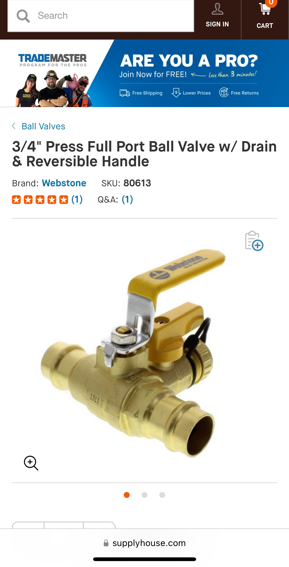

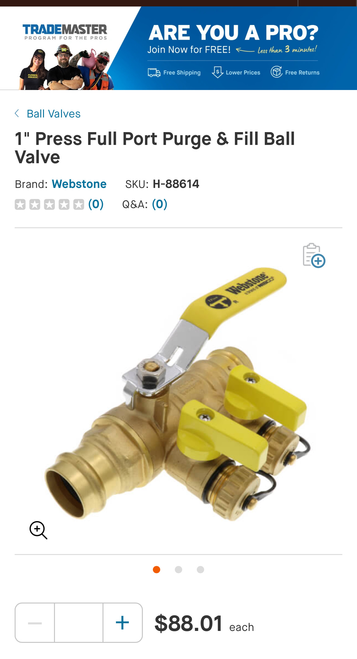

    hot_rod Member Posts: 27,559
    one if these two valves would be a good replacement
    The less expensive T valve works fine once you learn the handle positions😃
