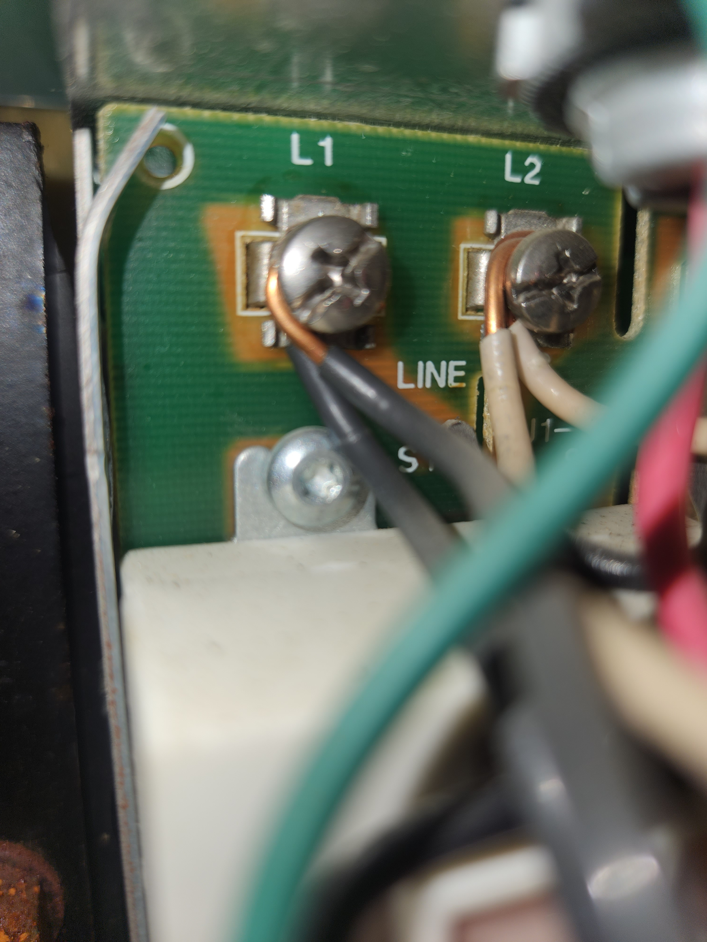

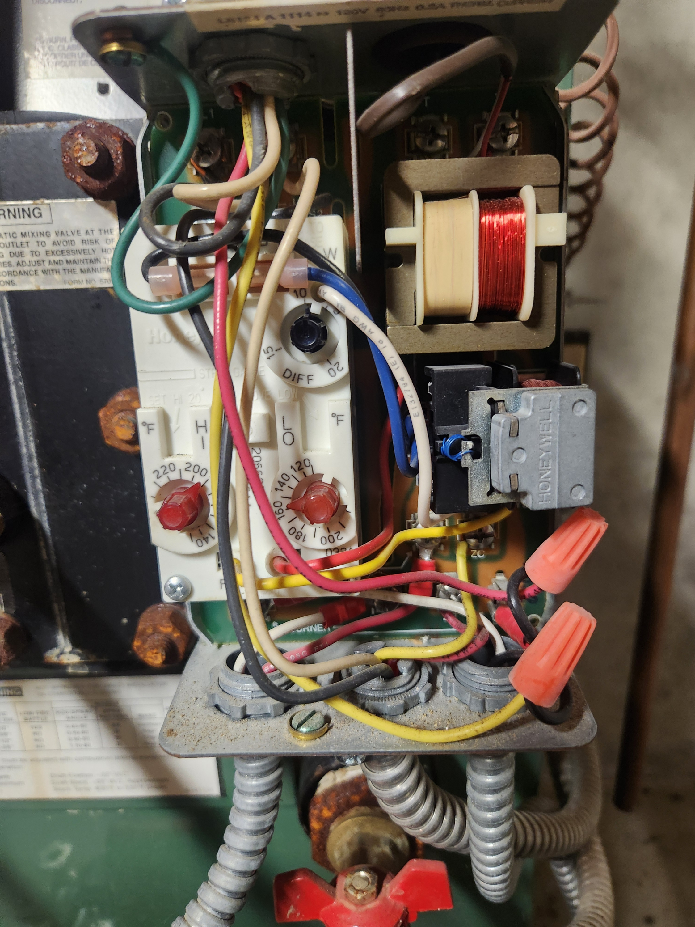

I have a pretty simple set up. New Yorker low pressure boiler supplies the base board heat and hot water for this 2 floor house. The Beckett burner just started short cycling. Flame for about 5 seconds. Cuts off. Comes back on for 5 seconds. Repeat. Eventually it shuts off and the gage on the boiler goes to zero. I'll reset it and it will fire up and Keeps going until around 170 - 180 degrees. Even though I have the aquastat set to 190? And then it starts short cycling again shortly after! I notice it's even worse if it its calling for heat. Right now without a call for heat, it's run to 170 degrees and hasn't short cycled since I've been sitting here. I'm waiting to see if it kicks back on at 160 per aquastat settings.
I've changed the oil filter, changed the strainer and gasket to the oil pump, and changed the nozzle. The expansion tank doesnt sound full of water. And air did come out when I checked the valve.
Does this sound like an aquastat issue? Its getting cold and any suggestions would be very much appreciated.

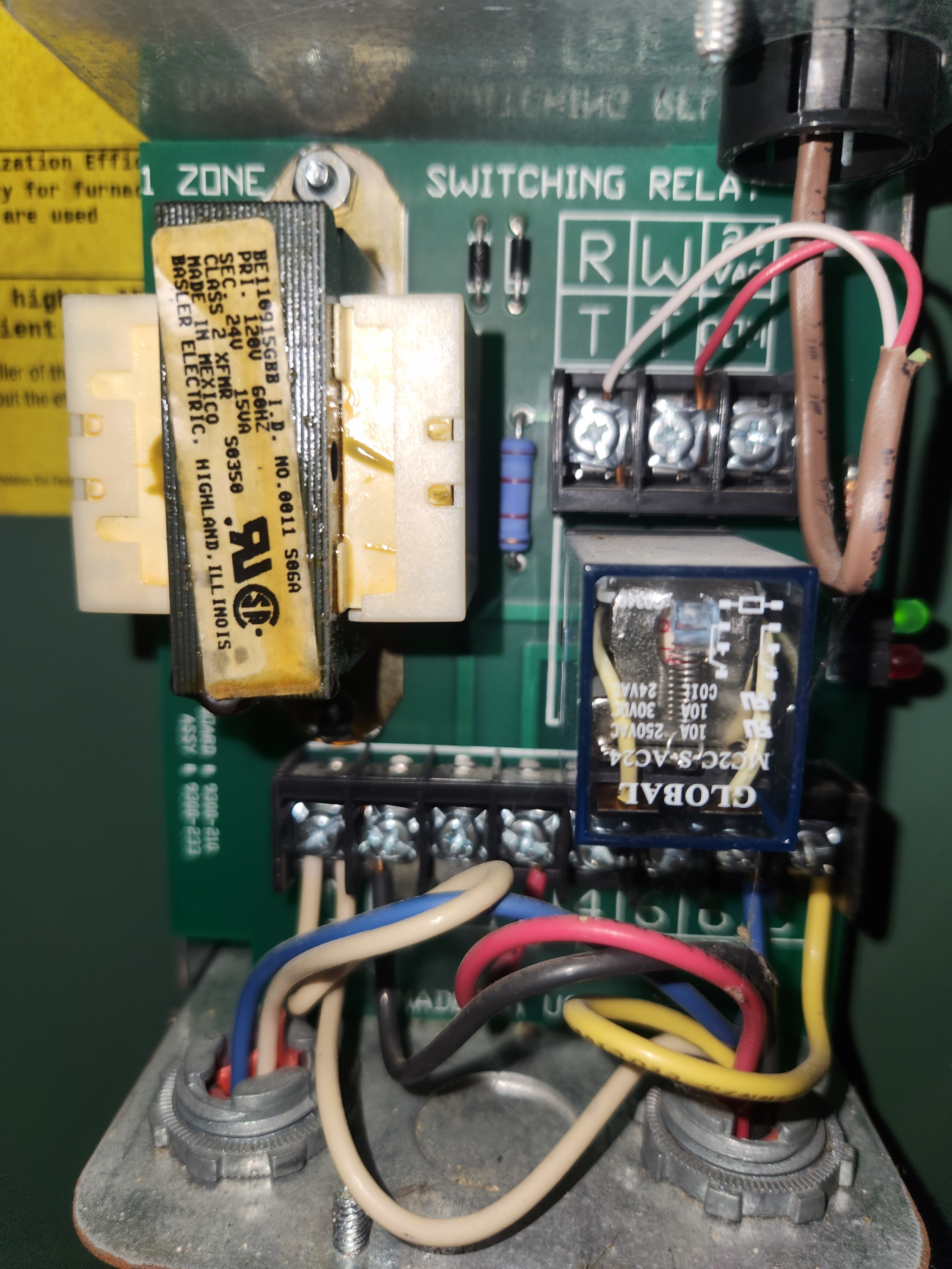

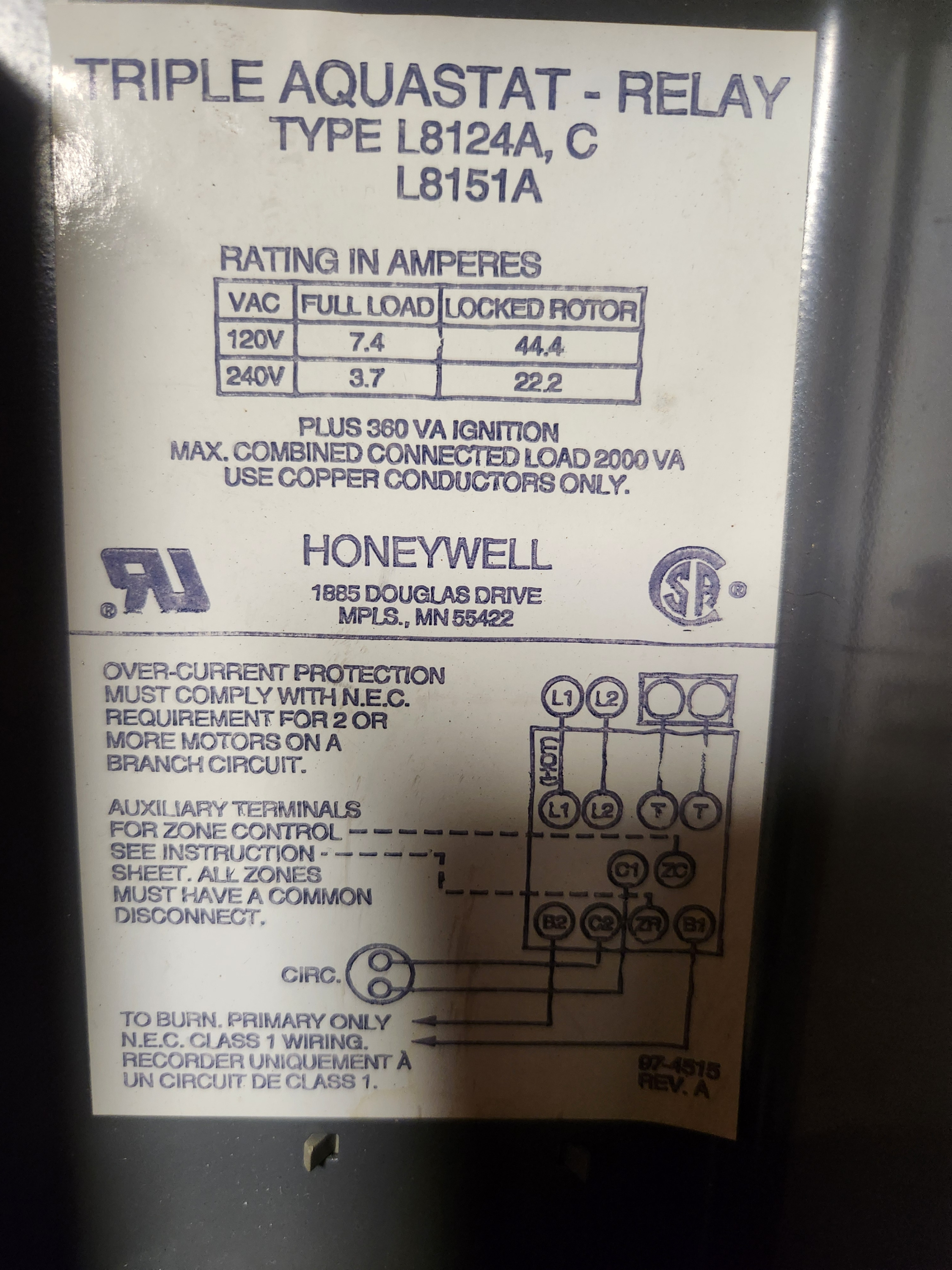

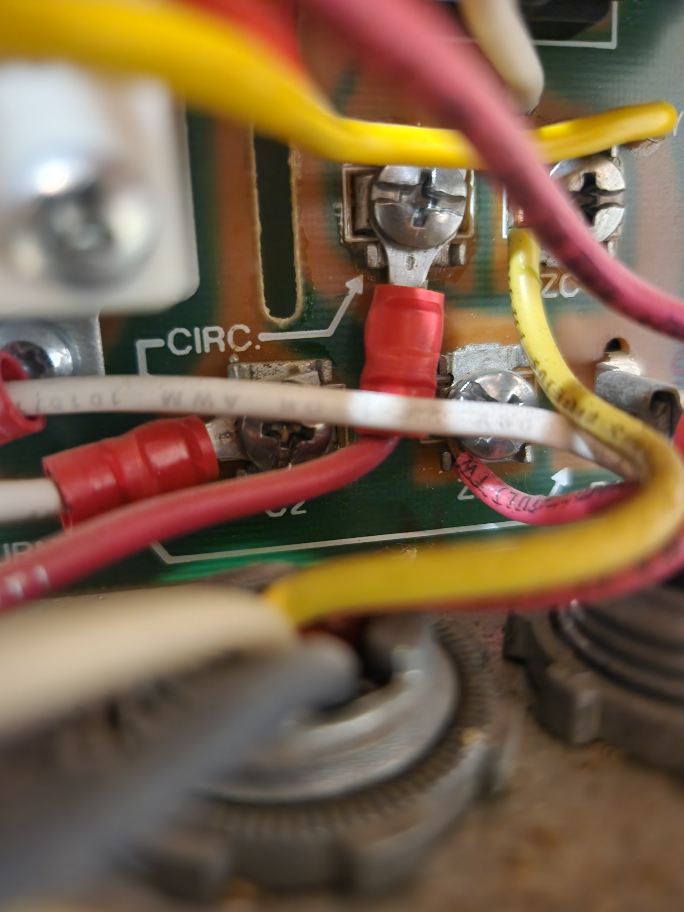

    There is something electrical going on there. When the Aquastat gets to 170°, is when the low limit switches to allow the circulator pump to start. Check to see if there is a dead short on the circulator pump wiring by removing the wire from the C1 terminal on the L8124. If the burner continues to operate all the way up th 190° (or higher), then the problem is in the circulator circuit. Perhaps the circulator wire is pinched and shorting out. perhaps the circulator pump has a bad winding. Depending on how that second zone pump is connected, the relay for that zone may have a problem.
    Open the covers and take pictures of the wire connections. See if there are wires on ZC and ZR in the L8124. also how are the wires connected on the other zone switching relay. Pictures of that also.

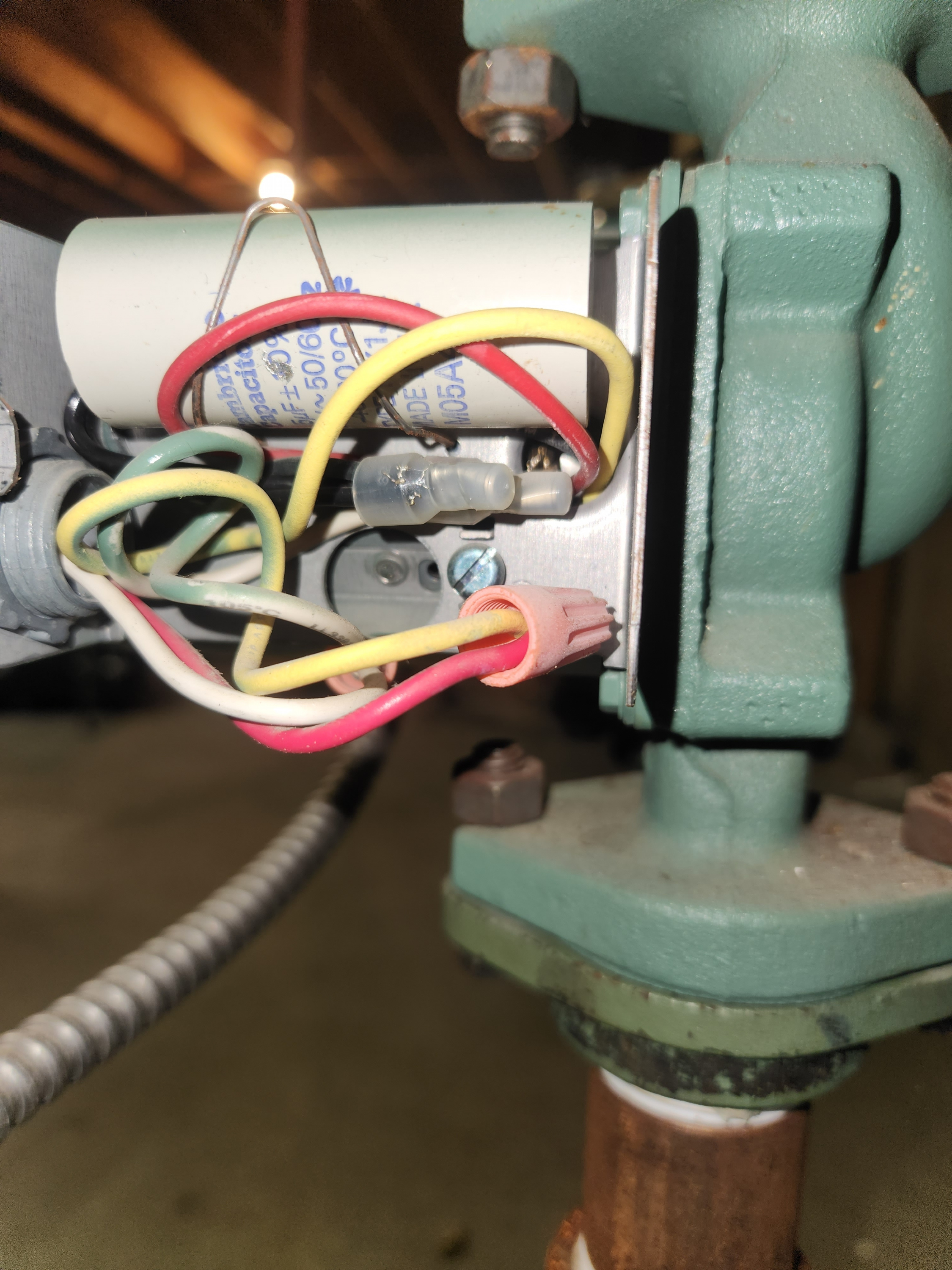

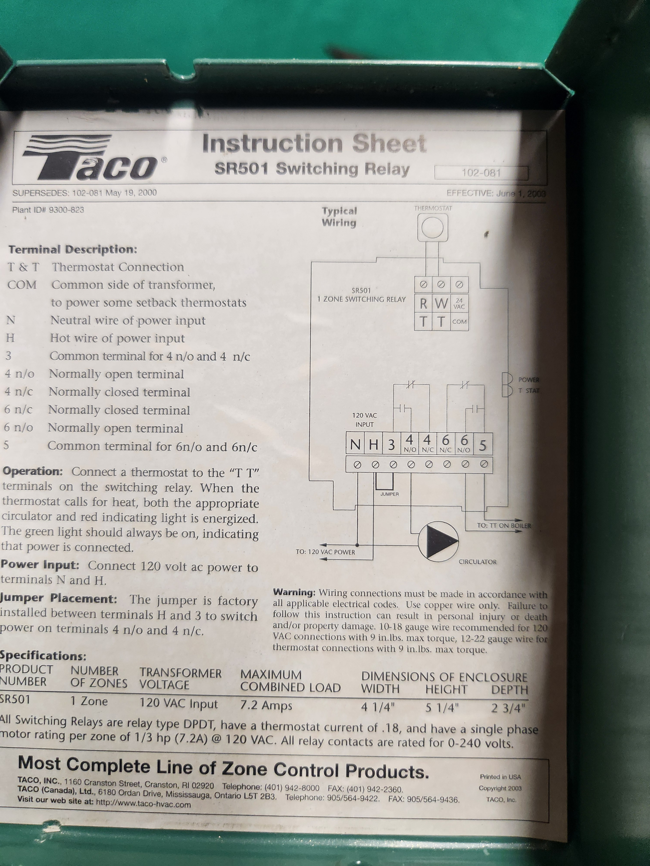

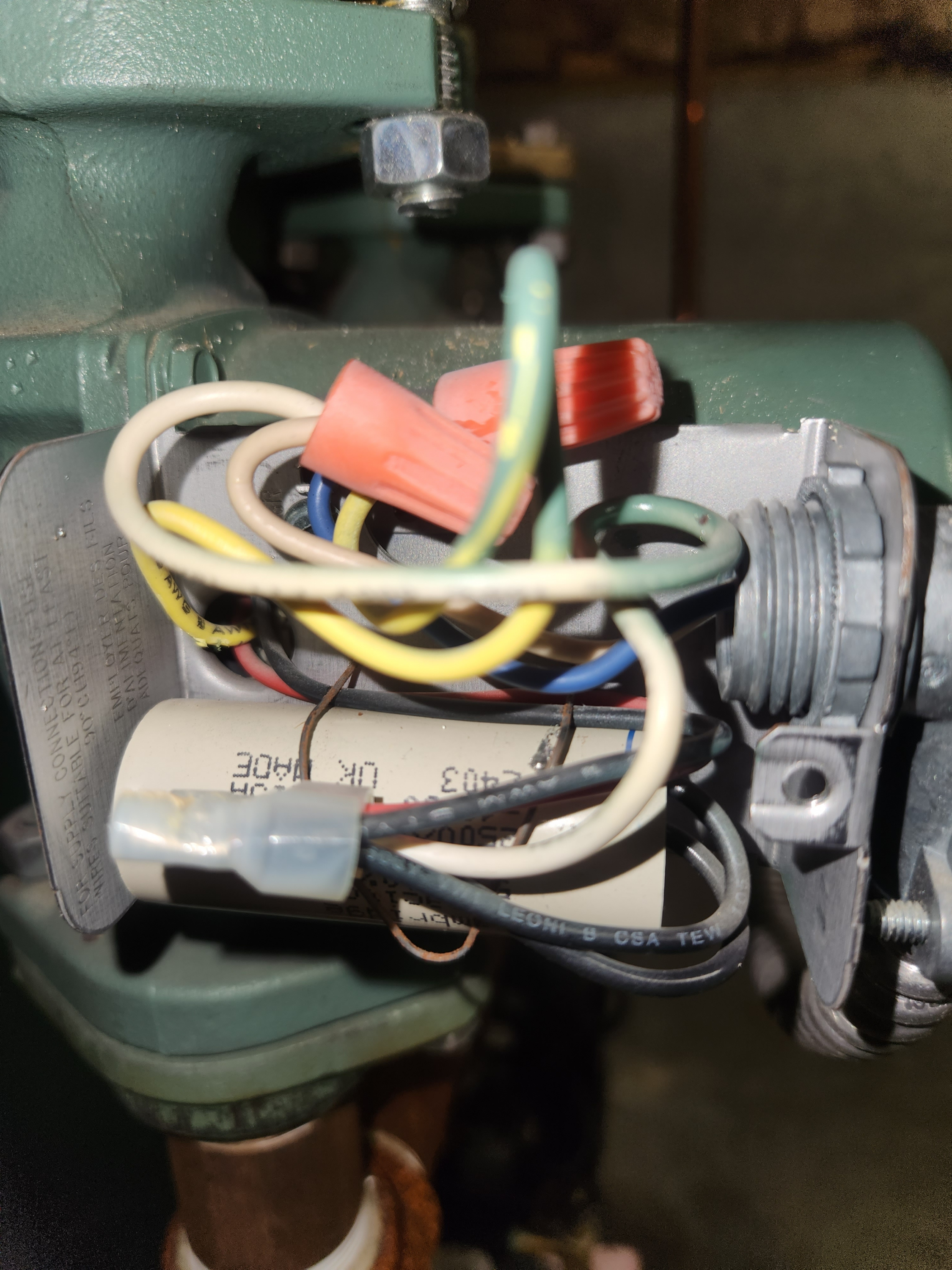

    Ok. I took pics of the schematics inside the covers as well just for my own reference. The two circ pumps, the aquastat and the switching relay on the side of the boiler.
    Everything you've said in the comments are accurate to whats going on. It seems like once it's down for good and I reset the burner emergency switch in the morning, it goes until around 170. And then anything after that, any call for heat, or if someone uses hot water, it short cycles for 5 secs. Off and on many times. I actually stopped counting how many times it short cycles.

  • LRCCBJ
    LRCCBJ Member Posts: 1,043
    edited December 2024
    Follow Ed's advice above.
    Shut off power to the boiler.
    Remove the wire from the C1 terminal in the L8124.
    Start the boiler again and observe if it runs up to 190F before shutting down.

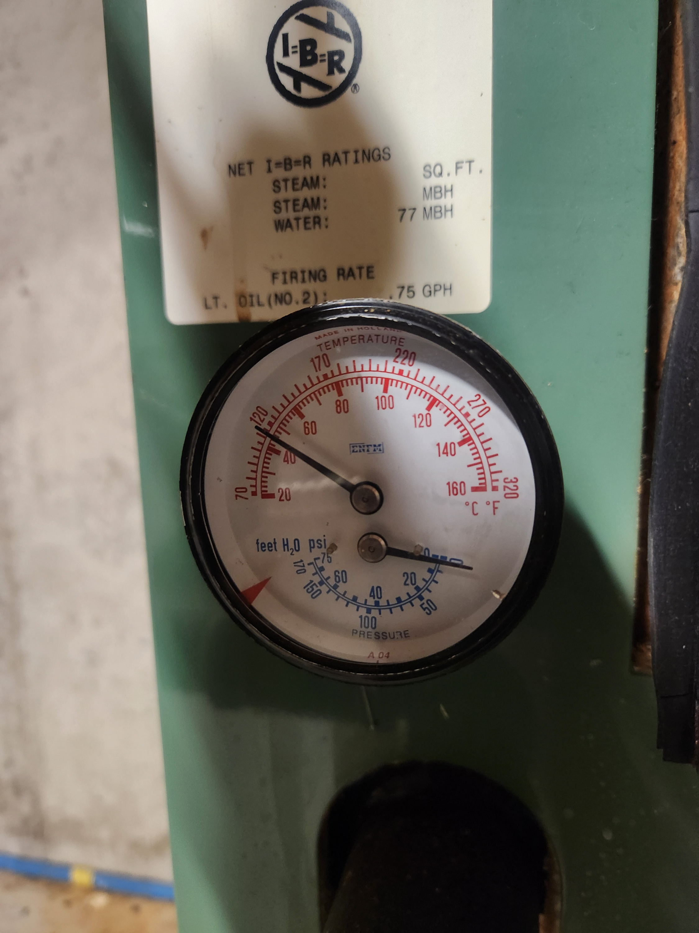

    Additionally, the gauge reading zero is a serious concern. The boiler does not appear to be automatically filling itself to maintain 15 psi. At this point, you need to manually fill it to 15 psi when it is cold.

    I've wondered about the regulator valve. The handle on top doesn't seem to want to do anything

    Lift that tab on the top of the valve so it is vertical. See if the valve feeds water to the boiler. Watch the pressure gauge. You want 15 psi…………not more. Be ready to move the tab back to the current position. WORK ON THE VALVE BEFORE WORKING ON THE L8124.

    Okay. I'm assuming I'm reading from the upper half, from 0 to 20.
  • psb75
    psb75 Member Posts: 1,099
    You need to get your auto-fill valve "unstuck". It's not letting the normal 12-15 psi. amount of water at pressure into the system. Or you could replace the fill valve/pressure reducer altogether. In order to do this you'll need the system pressure at 0 psi. and have the house water system supply ball valve shut off.

  • LRCCBJ
    Go into the L8124 and carefully put the probes on "B1" and "B2". Have someone start the burner and you observe the meter. Does the voltage disappear when the burner stops?
