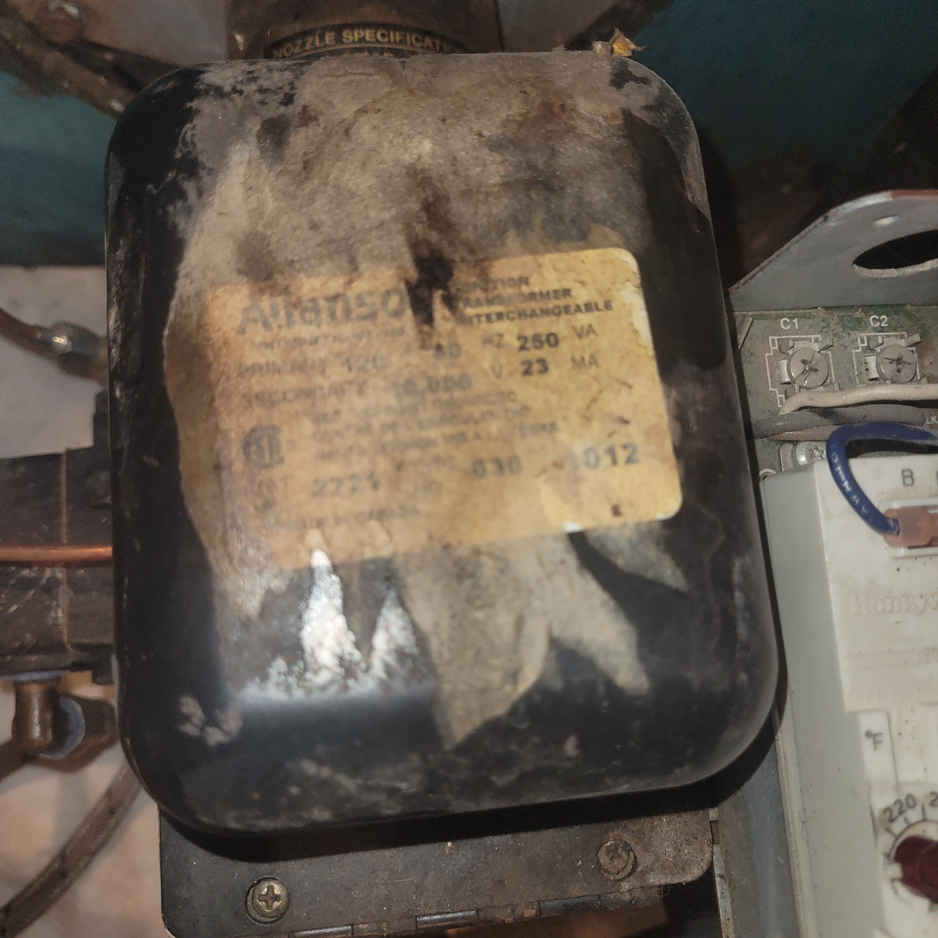

Just went to fire the old girl up this evening. Both zone pumps are spinning, contactors in the aquastat are clicking, but nothing from the oil pump or transformer.
Is the transformer the next thing to troubleshoot? I'm guessing I could test continuity across the coils?

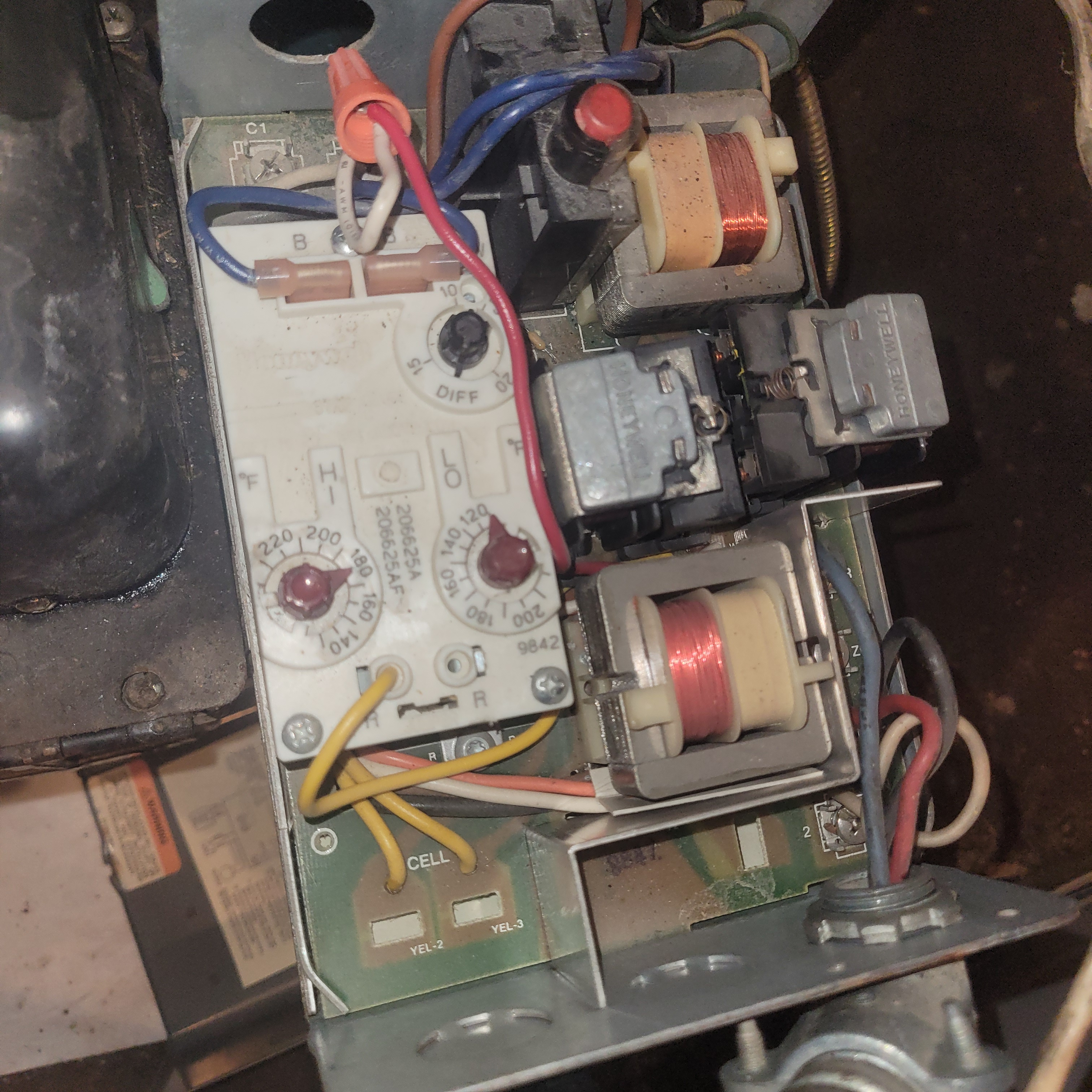

    Check 120 volts going to the burner usually B1 & B2. Check if the burner motor has a manual reset overload button on the motor some do some don't
  • steamnoob
    steamnoob Member Posts: 46
    I pressed the reset on the motor, hear a bit of a buzz, they it pops out again. Bad burner motor?
    EBEBRATT-Ed Member Posts: 19,642
    Bad motor or the fuel pump is jammed up. Kill the power swing the transformer open and try to spin the blower wheel. It should spin with very slight resistance. If no spin pull the motor off and see what does not spin the motor or the oil pump.

    Agree with above. Bad OB motor or seized fuel pump. If it is in fact the transformer you hear buzzing, and not the aquastat relay, which can also buzz. Very 120 volts at B1,B2 when you reset. Then kick the motor. Not like it owes you money. Just a love tap.
    If that R8182D ever goes bad, it would be better to install a modern aquastat and seperate primary relay. Replacements for those are big bucks anyway.

    The small red one on the blower motor below is what I pressed this time. whirrs for a bit, then pop out again.
    I'll take the motor off and do some diag tomorrow.

    I verified 120v from the left blue wire to the B terminal, but nothing from the right one. Resetting the motor button seems to have varying results, sometimes hear a click, sometimes just moves freely. Turned off power seems to reset everything.

    Motor oiled, 1 hour tuition payment remitted, boiler firing. Thanks Frank.

    For the record, this is a Burnham V-13A-T with an OEM Carlin 100CRD burner. The tankless coil is no longer in service. We'll be looking at a gas conversion in the spring.
    Also, the oil company should have oiled that motor.
