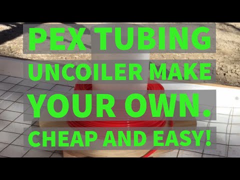

Anyone have any experience or thoughts on getting a pex uncoiler/reel for use with pex as well as with electric wire?
would be nice to put it to multi-use.
Thanks!
I had a 4' diameter aluminum disc I could slip over my uncoiler, so it could take a small roll of 3/8 up to a 600' 1". The inner part was about an 8" diameter, so anything with that size inner diameter would work.
good to have a friction adjustment also to keep it from flywheeling. Mine was one of the early Rehau versions, on wheels.
Pretty easy to make custom uncoilers, a lazy susan hardware kit makes for a good start for a small size uncoiler.Bob "hot rod" Rohr
Living the hydronic dream0 -
1 -
Thanks for the suggestions guys.I can do the diy — it’ll go on my to-do list.0
Probably could find an old spool and not have to do half that0

https://www.youtube.com/watch?v=7AD0KzfeUPI
