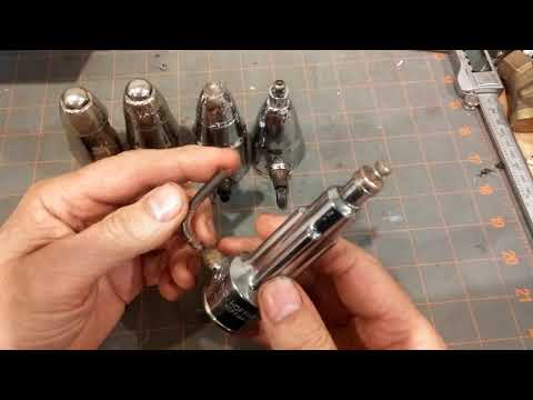

    How do the air vents work? What causes them to seal once air is purged? Is it thermal expansion once steam gets there?
  • acwagner
    acwagner Member Posts: 515
    Here's a video that shows how the type you have work. There's a cut away towards the end of the video.
    https://www.youtube.com/watch?v=t7NiIyvDLbU
