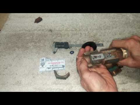

For your viewing pleasure, a YouTube video of a cut apart 1-1/4" single pipe steam radiator valve pretending to be an 1-1/2" valve and failing.
https://www.youtube.com/watch?v=2VcNG3UOiCU
https://www.youtube.com/watch?v=2VcNG3UOiCU All Steamed Up, Inc.

cool video Gordo..excellent investigative work there.gwgillplumbingandheating.com

I think I've seen that valve before. http://forum.heatinghelp.com/discussion/147148/radiator-valves-full-portJust another DIYer | King of Prussia, PA
1983(?) Peerless G-561-W-S | 3" drop header, CG400-1090, VXT-240 -
Ah. The old "check valve" effect. That would make for maddening troubleshooting on a flooded boiler issue.
Manufacturer knows what they are called, not what they are for.

So would that valve worked for hot water? That is the issue in that people think it looks like a steam valve, but it is not "fat" enough to handle both steam & condensate.
My wholesale supplier pointed out a difference between water and steam angle valves. He would only stock the steam which would do water as well...for just a few dollars more.
He sales the RWV valves, made in Taiwan also, but are labeled as steam valves. A fairly decent valve, however I have only used them on a 2 pipe system, so the 1 pipe test was not observed by me. The next choice was actual Hoffman valves, but where are they built today?0 -
@JUGHNE : I think this "American" valve is a supposed to be a pure steam valve because I've been told hot water radiator valves are supposed to have - by design - a built-in bypass so you cannot shut them completely off and cause the radiator freeze up... that's the theory, anyway. But you could use it on a hot water system anyway. I would not, because I have serious misgivings about its overall quality of construction.
If they totally fail on design on things you can see, then it makes one wonder what short-cuts they took on things you can't see such as the metallurgy.
"Hoffman valves" have not been made by Hoffman for years. Currently, they are using the Marsh valve pattern... this week. Not many years ago, Hoffman was re-branding Mepco valves.
They are very pricey and the internals are a bit tight for single pipe steam. Very nice for two-pipe, however.All Steamed Up, Inc.
