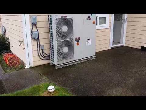

In Japan, the ones I've seen are usually installed in the rear, facing the alley or in a narrow walkway between buildings, so they aren't where people see them much.Hatterasguy said:That is fugly............!!

The Daikin is good for full btu out put down to 5f. Mitsubishi says there Hyper heat will run down to -10 with full btu out put.0
Fujitsu has low ambient versions rated down to -15F. ISTR Mitsu HH also claiming -15F? The standard units are good to about 5F, at a couple points lower than the 10F output.
For smaller houses with forced air and no NG availability, the current generation of mini-splits are real game changers.
The Altherma appears to be effectively EOL'd at this point in the US.
Lifecycle is also limited, at least in comparison with hydronic systems. Monobloc air-to-water designs can at least be replaced as a component rather than forklifing the entire system.0
